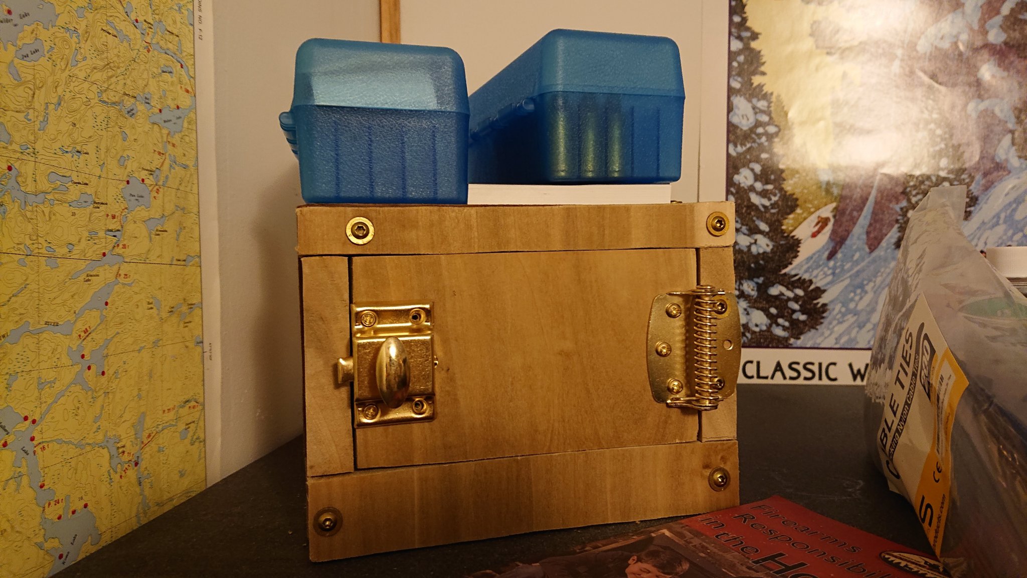

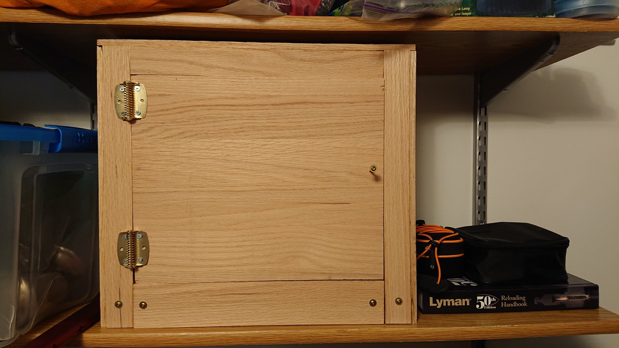

I roughly followed these directions to make 1" nominal solid wood cabinets per NFPA, separate ones for powder and primers. There's just spring pressure and a little friction holding the doors closed, no latch. Dehumidifier running in the room during the summer.
