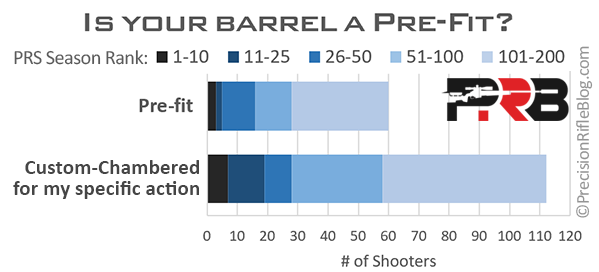

In PRS, some guys use prefits, including three in the top 10 (and 35% of the top shooters…not sure of his definition of “top”). And it seems to be a growing phenom.
Here’s a quote:
“Austin Orgain, Austin Buschman, and Kyle Mccormack. Those 3 guys represent 3 PRS Championships and a World Championship, so they aren’t just top shooters – they are the best of the best. And those guys are choosing to run pre-fit barrels! I don’t personally know all of the top shooters, but I do know those 3 guys and can say they are extremely competitive. They want to win more than most people can understand. Don’t get me wrong, they are very nice guys who help other shooters – but if they thought a pre-fit barrel was hurting their precision one bit, they absolutely wouldn’t be running them.”
But I agree if you are a benchrest shooter, your needs are greater than a PRS guy and having a gunsmith chamber your barrel is the way to go.

And, there are a ton of PRS competitors- including top national level shooters- that take advantage of the convenience that pre-fit barrels offer.
Here’s a quote:
Also, it’s not about the topic at hand, exactly, but this article was interesting as well.
Thanks for the info- seriously. It's apparent (to me, anyway) that the quality of the prefits has improved dramatically. I'd always felt that the chambering process was lacking precision with prefits- but seems that at least among the top dogs, they've got it dialed in. I'm curious if all processes are CNC, or if some aspects of the chambering process are done manually.
Some I've seen from the "production tier" prefits don't meet the standards I use...but I'm guessing the comp crowd isn't spinning on those barrels.
