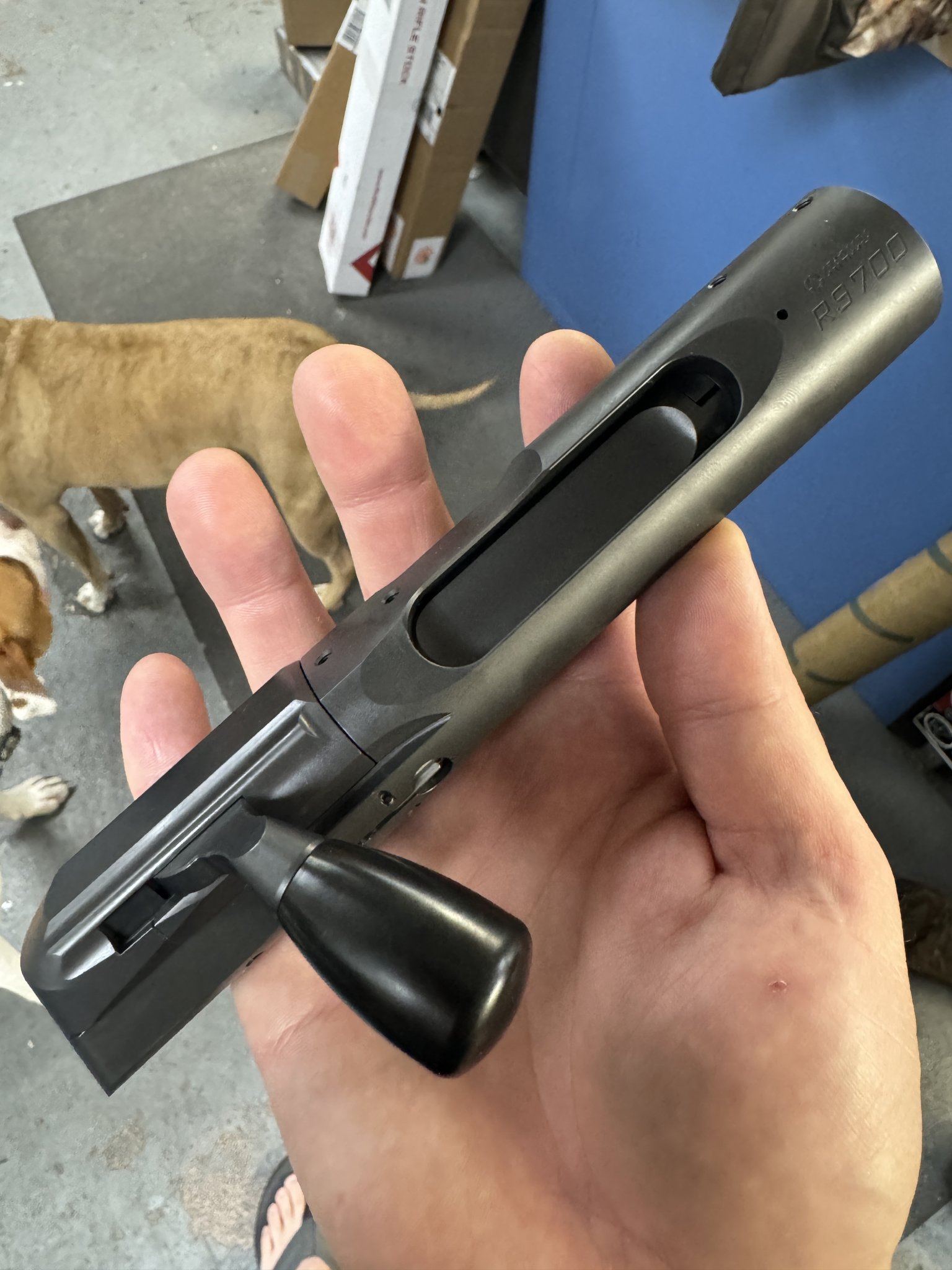

You are right, the Savage is awful. The Strassers feel pretty amazing. I am not sure the bolt pull weight on mine but it take very little force to cycle the action. It really is effortless. More than just the bolt pull weight though, the Strasser actions have a clean, smooth feeling. Its like the bolt is riding on ice skates.

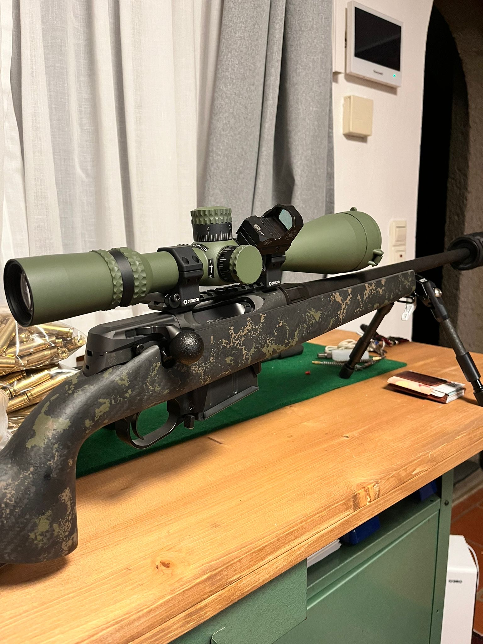

I kind of want one of those, even though I don't know what I would use it for.
But what's going on with those scope rings, lol?!
Yeah, they are not our favorite rings but they were laying around the shop so we gave them a try. They are the SIG SAUER Alpha1 Tactical scope rings and I don't believe they are still offered by SIG... lol... but our actions sure are! ha

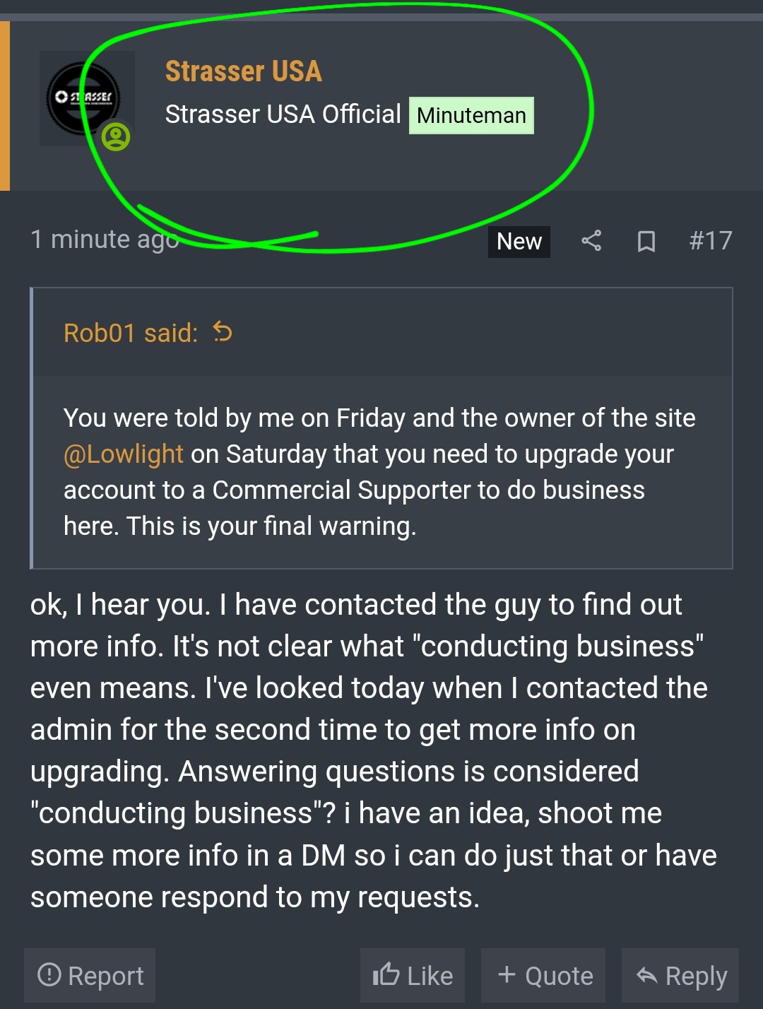

You were told by me on Friday and the owner of the site @Lowlight on Saturday that you need to upgrade your account to a Commercial Supporter to do business here. This is your final warning.
ok, I hear you. I have contacted the guy to find out more info. It's not clear what "conducting business" even means. I've looked today when I contacted the admin for the second time to get more info on upgrading. Answering questions is considered "conducting business"? i have an idea, shoot me some more info in a DM so i can do just that or have someone respond to my requests.
I’ve corresponded with Strasser USA several times in the last week but haven’t been able to get the dimensions for a shouldered prefit. Lots of schematics have been sent but nothing that gives what’s needed. Hopefully they get that ironed-out. I get that some will use a barrel but, but why is it so hard to give a boltface to recoil lug face dimension for those who want a shouldered barrel? (Their schematics show the boltnose relief, etc… just nothing that would allow a barrel to be spun-up without having the action in hand.)
If you are operating as this....
it sure looks like you are conducting business.
After your first few quite helpful responses in the Precision Rifles thread we even tried to help you.
We try to help you because we want more manufacturers here. I don't want have to see you go away.
Yes answering questions as a business is considered "conducting business" and having your screen name the company name and described as the "official" then that also shows it as a business account. Don't try and play games. In the other thread on Friday I gave the link below which shows you how you register as a Commercial Supporter. Thanks.

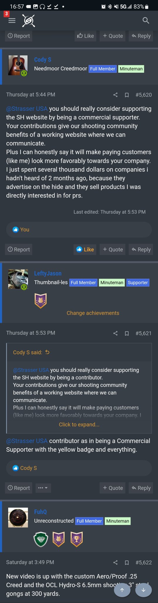

Since you are the managing partner of the USA side, you probably have some idea of advertising and how that works and the cost and efficiencies of advertising.
Here on Sniper's Hide, you'll get way better value for your advertising dollars spent if you have folks on here a lot to answer questions and provide lots of information and photos and videos and such, because this is more of the place where folks with actual money and interest and intent to buy such things hang out.
To access all that it's $200 a month or $2400 a year.
That's not even the walking in the door fee for most other advertising.
So my suggestion is put up the money out of your advertising budget, upgrade the account (it's really easy to simply click on the upgrade link, choose what you want and pay via credit card).
Then get busy providing lots of information, pictures, videos, answering questions, making connections with barrel and accessory makers and growing your brand on here.
I'll bet the profit on the first sale or two of an action you get from someone seeing it here more than pays for the cost of the first month of commercial entity fees for this website.
