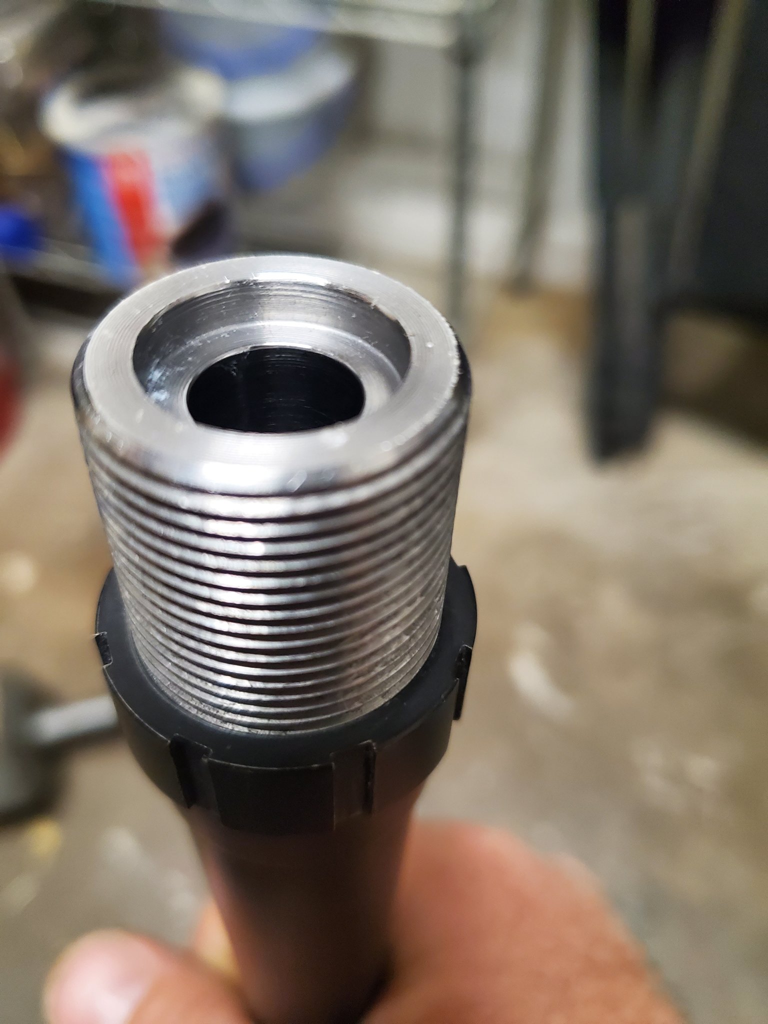

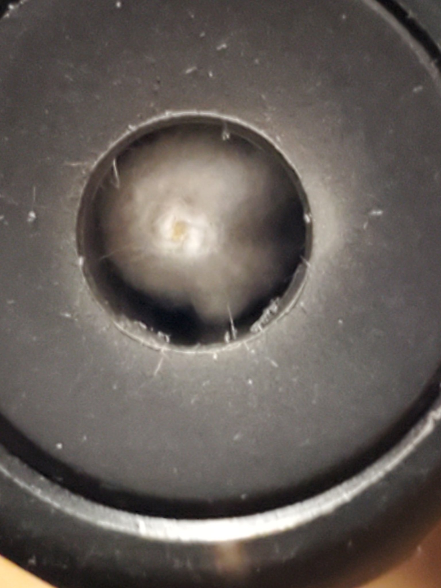

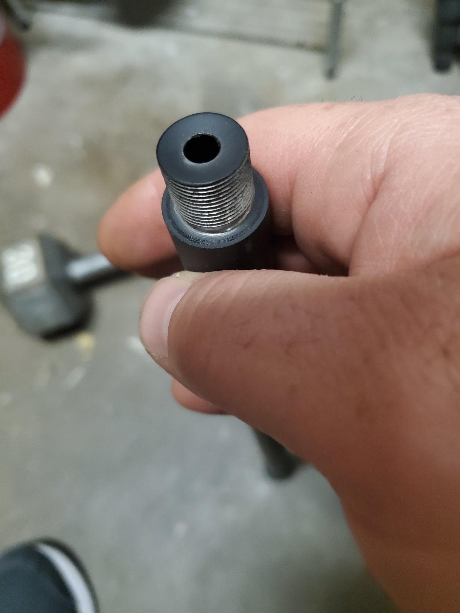

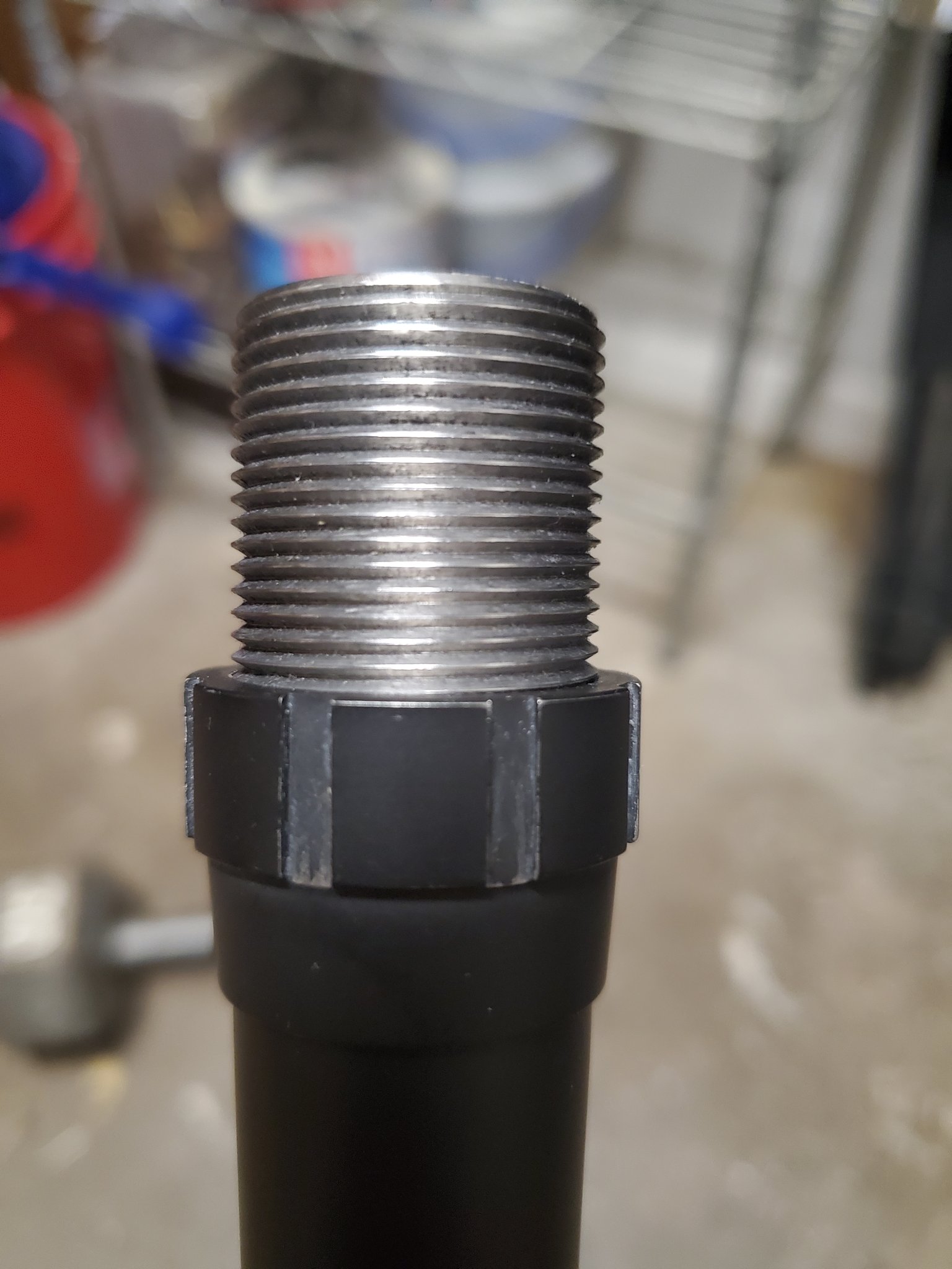

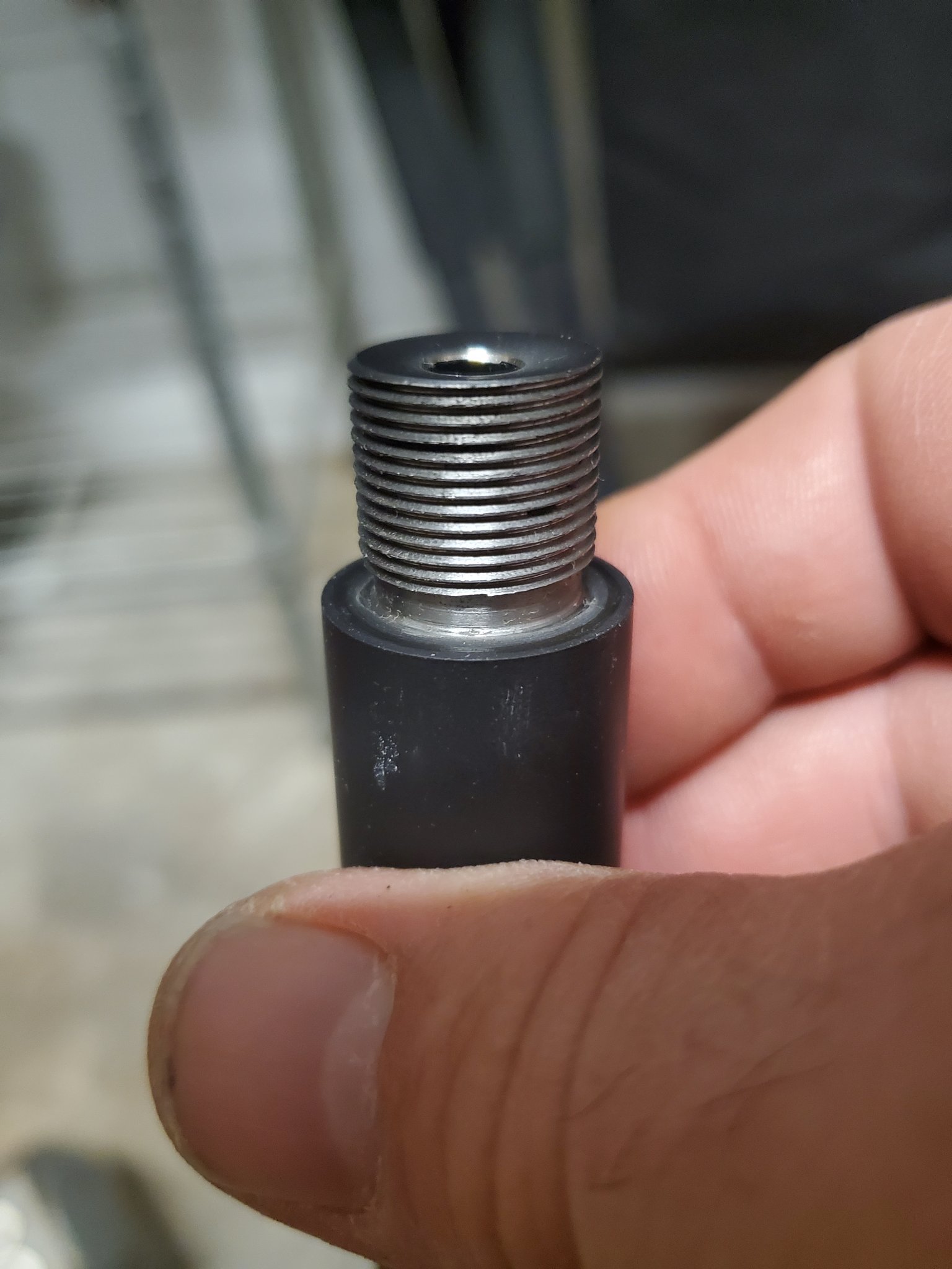

I had some trouble with sevral McGowan barrels in a row. They could not make me a barrel with either end threaded correctly over three tries. Did they make your barrel or just the blank? Do you have a picture of the tenon threads? Is stuff moving around when it gets hot because the tenon threads are so sloppy?
That is exactly why I asked who chambered it. I had a good friend go through a few as well and I helped him diagnose the inconsistency on all of them. Not my 1st choice for a barrel…
They made the complete barrel. I didn't take any pics of the threads.
I woukd take it apart and post some pics here for people to look at. McGowan assured me they measured all threads multiple times before they left their shop and there was no way my threads were undersized or bad. They told me I coukd send it in if I wanted but that there nothing wrong with it.
