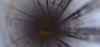

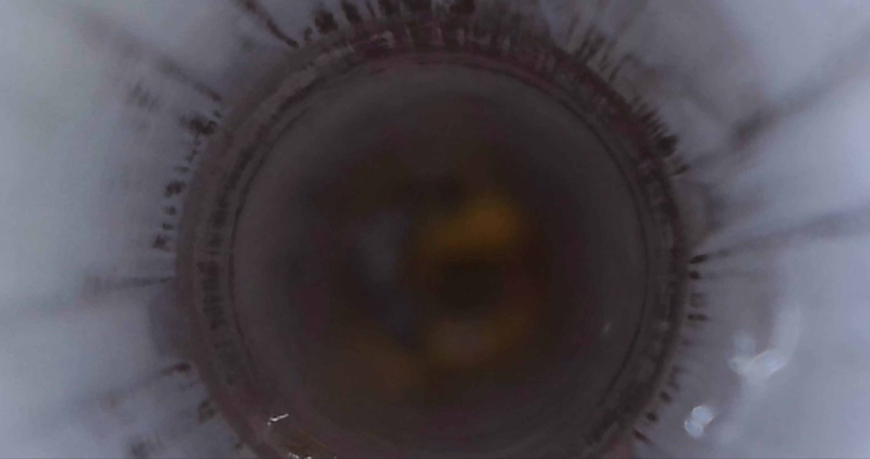

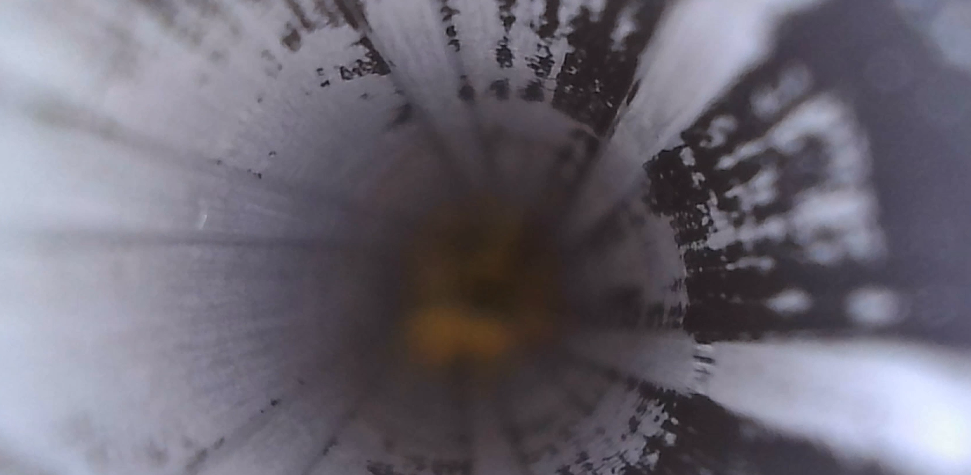

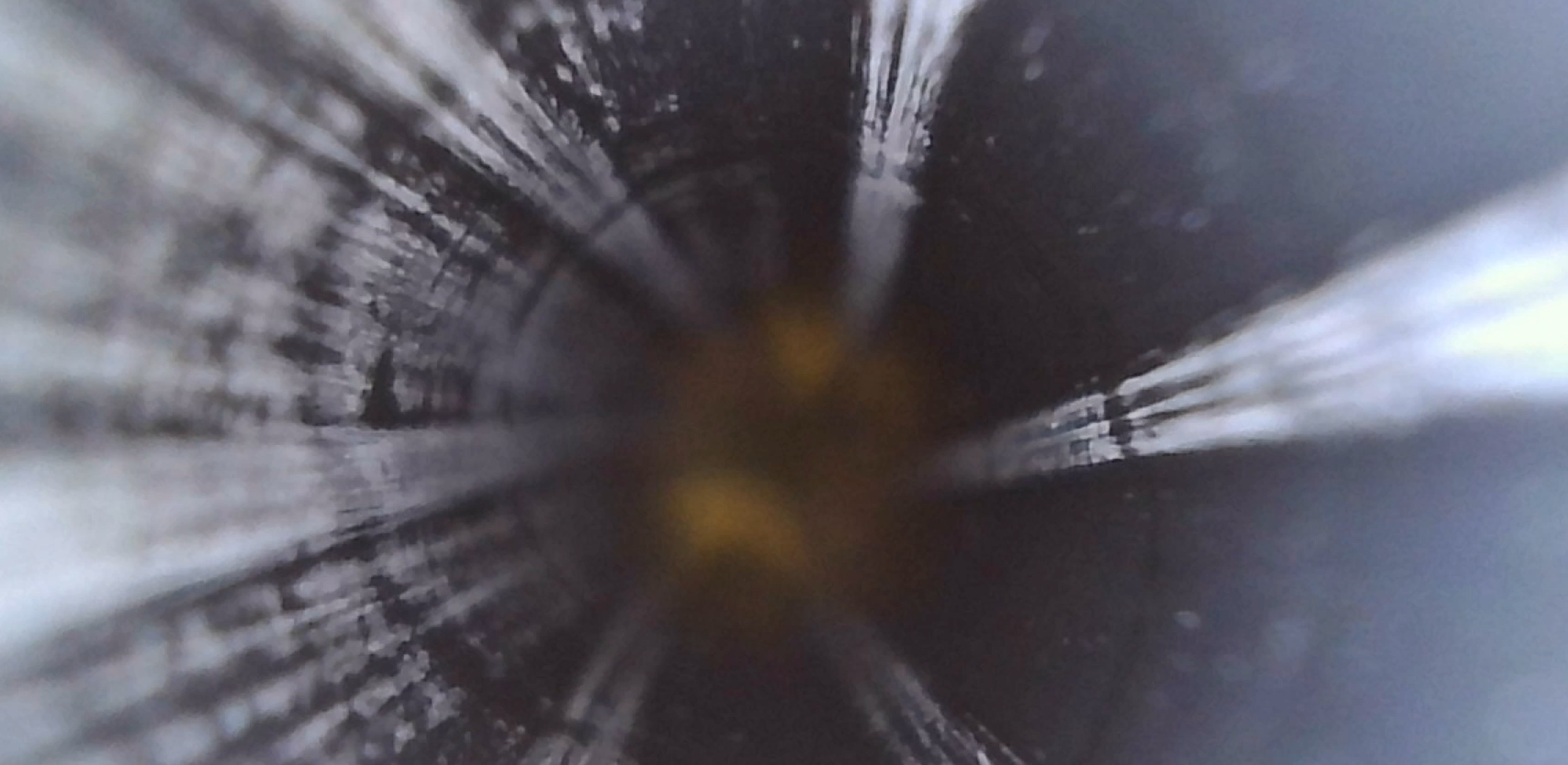

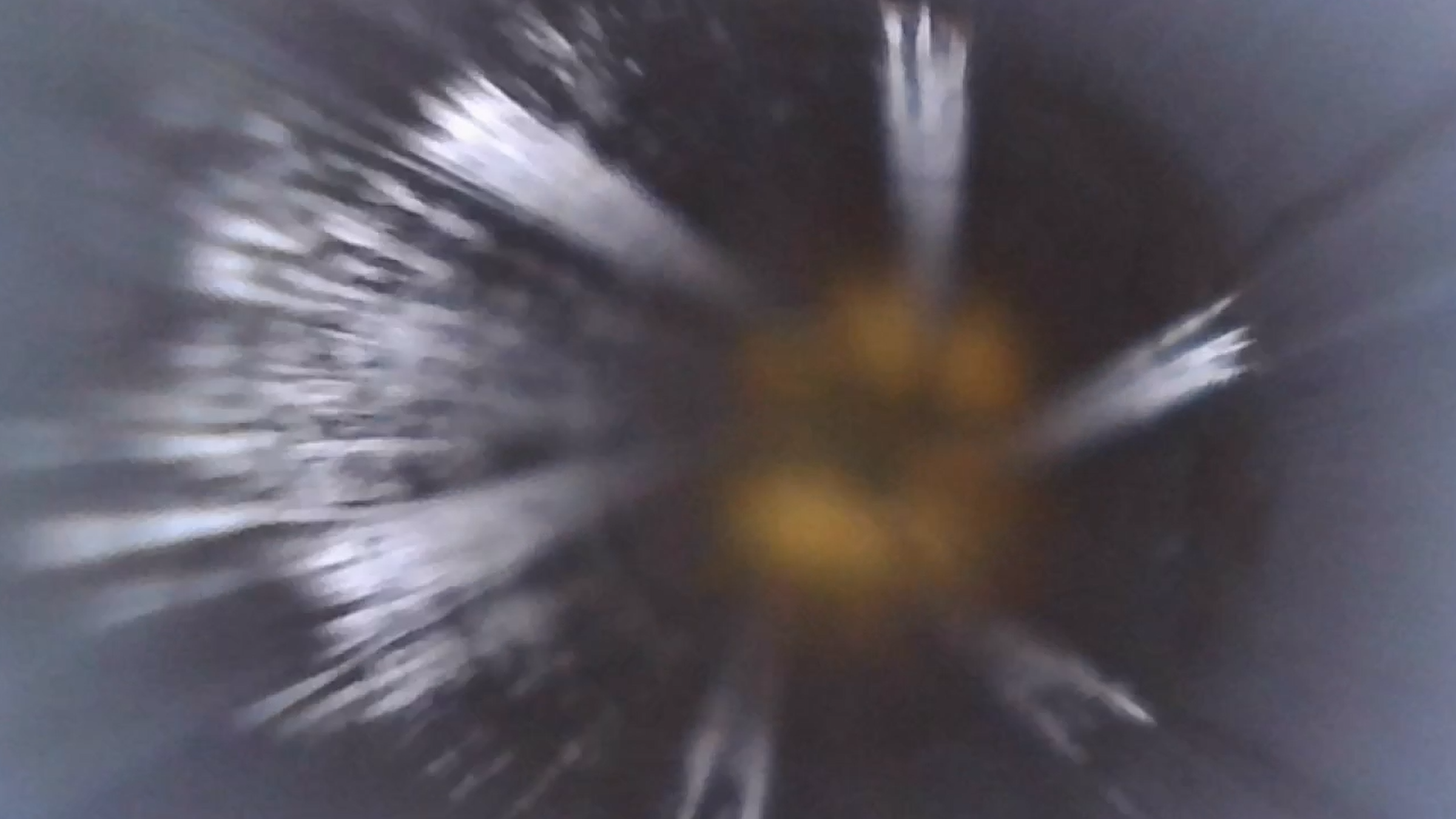

I recently started to see a significant degradation in repeatability in my five-month-old CZ 457 Varmint MTR (>1 MoA @ 50 yards). I bore scoped the barrel (which has around 2500 rounds downrange, has been religiously cleaned using Boretech C4 only) and saw a whitish hard deposit, this after a deep clean (24 hour soak of chamber in C4, dry patched , then C4 wet nylon brush down the chamber multiple times, dry patched again, then C4 wetted bronze brush, dry patched again, then a light oil wet patched/dry patched). Being a relatively new shooter (this is my first rifle), thought I would turn to the very experienced rimfire enthusiasts here to see if I could get your thoughts as to what is causing this and what I should do to remove it and get the barrel back to decent shooting condition. BTW, this deposit is around the chamber area and the first 4.5" of the barrel. Borescope screen shots from video are attached.
Thanks in advance for all your guidance and help - am getting quite frustrated since I can't find much on the web and have no idea what to do to remove this deposit.
Synper.
I'd guess C4 in the barrel, hitting the lead & lube, is making some minor salts from either the lead or the lube contents, and you are seeing salts+ deposits. Lead remover would be my call too.
Yeah try some Rimfire blend, let it soak for a few minutes and brush it, run a RB patch through and repeat. I am betting you will see a big difference.
It’s leading
My B14R has some as well. Rimfire blend won’t touch it
Here’s a photo for reference I found of an airgun when I was looking into mine a while back
I might seem like a broken record, but ditch the nylon brush.
If you are going to brush, get Ballistol and the correct size phosphor-bronze brush. The bronze works realy well on lead and won't damage the steel, provided you do not use an abrasive cleaner; hence the Ballistol.
Lead out works OK but it isn’t brushless by any stretch of imagination.
I use a Lewis Lead Remover to mechanically get rid of most fouling. It’s just a bronze mesh on a jag, so you could just wrap bronze wool around a worn bore brush. That’s what I do for odd calibers like 9.3x62.
Follow up with chemical cleaner and patches.
I tried Ballistol. It is a fine general purpose cleaner. As with all general purpose things, it isn’t great at most jobs. Diesel fuel is common on our farm and it works about as well for carbon removal.
^^^^. We treat these barrels like somebody's arteries. I still use bronze brushes and Hoppes...thousands of rounds and countless cleanings I've never seen accuracy degrade on my most expensive 22lr barrels. Nylon brushes and wet patches don't remove carbon rings or leading.
Reactions: Rimfireshooter99

I'm wondering what influence the C4 soak had. For perspective, my cleaning regimen for both my Vudoo and my RimX over thousands of rounds is to soak the carbon ring with C4 for ~15 minutes, push that wet patch through the bore, use the back of it to wipe carbon off the crown, then a series of dry patches until they come out white.
So, most of the bore only sees one patch of C4 and is immediately wiped dry.
If I understand OP correctly, the lighter of the two colors in the borescope photos is what most of the bore looks like? It's the very dark grey discoloration that is unusual and only located near the chamber?
The white I believe is the leading

Hard tk tell from those photos. My first guess would be lead and bullet lube buildup. I would hit it with a bronze brush and the lead remover solution of your choice.
Apologies for not responding earlier - had several personal things to take care of.
I have hit it with a nylon and a bronze brush (wet with C4, also separately with Rimfire Blend), bore-scoped it, and no change.
Its the white deposit that is the issue - its very heavy in the chamber (I can't even see any dark grey in that area) as well as in the first few inches of the barrel. Rest of the barrel is completely clean given what has been done to it.

I cleaned the barrel using Bore-tech Rimfire Blend (wet patch, then a wet bore mop for 15 minutes, then dry patches and bore-scoping, followed by another wet patch, then wet bore mop for 30 minutes followed by dry patches and bore scoping), all of which showed no change, then (in sheer frustration) by an overnight Rimfire Blend soak and dry patches which also showed no change, then by Rimfire blend soaked nylon brush / bore scoping (again no change), then the same except now using a bronze brush and bore scoping (also no change).
A friend was heading over to Whidden Gun Works in Nashville, GA for rifle ammo testing so I went along with the rifle and showed it to the gunsmith and the ammo testing guys there (what a great bunch of folks, btw!). They had never seen this issue previously either (all of them are VERY experienced, knowledgeable and helpful folks). One of the ammo test guys was intrigued (and kind) enough to clean the barrel using Kroil (and something else… a solution that I don't remember the name of) followed by more bore scoping - no effective change that either of us could detect. The next step was "Iosso paste" with a nylon brush and bore scoping - guess what…… no change! A few other very experienced barrel technicians also looked at it - general conclusion is that the barrel steel is defective - lots of tool marks as well as this white "deposit" issue - they couldn't conclude for sure whether it was (or was not) a deposit. Their general conclusion was that it was a barrel defect, and they suggested that I send it back to CZ, which process was initiated last Monday.
After bugging CZ CS every alternate day (their CS team is very busy from the conversations I had with the nice CS guys), I am now waiting for the rifle RMA paperwork to send it back to them to diagnose and advise what the issue is, and how best to fix it.
I do promise to update y'all once I hear back (it could be me who mucked it up, could be the barrel, could be Lead Oxide, could be ?????). Honestly intrigued by the root cause so I can figure out what it is and avoid/prevent it from happening again, as well as pass it on to all so we can all benefit.

Given that it is a CZ 457 with a relatively easy to remove barrel, consider taking the barrel off and slugging the bore. I would go slow with multiple slugs from chamber to muzzle and muzzle to chamber, keep them sorted and measure them for bore concentricity. Note whether the pressure to push the slug through the bore gets easier, more difficult, or has loose and tight spots.
Obviously if the bore starts tight at the chamber and then loosens the rest of the way down, the bore is ruined and not worth further testing.
My biggest concern is the overnight soak of cleaner. I’m not familiar with the stuff you are using, but there are several types that will attack barrel steel (basically anything with ammonia). I’m hoping it’s lead and not chemical pitting.
Leading can usually be pushed/pulled out with tight fitting patches and creeping oils such as Kroil after using the brass brush. I’ve pulled long shards of lead from bores that “didn’t group”, which suddenly were awesome shooters! Personally my favorite cleaner is Yamaha Combustion Chamber cleaner (available at marinas), and Corrosion-X for light lube and protection.
