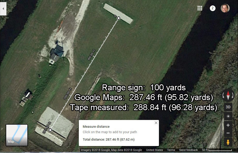

    Good question.
    We used a long tape measure (on a reel). I held it at the target. My buddy took the other end to the front edge of the shooting line. My barrel, when I'm in the prone shooting position, hangs over the front of the shooting line by a few inches, I'd say. Close enough?
    Reactions: Jefe's Dope
    After I returned from the range (and using the measuring tape), I went on Google Maps on my laptop. I was curious. I used Google's distance measuring tool, and I was VERY surprised at how accurate it was! A difference of only 16-1/2 inches! (Admittedly, some of that difference may be accounted for by my ability to use the mouse to accurately place the endpoints. But, still quite close!)
    100-yard line:
