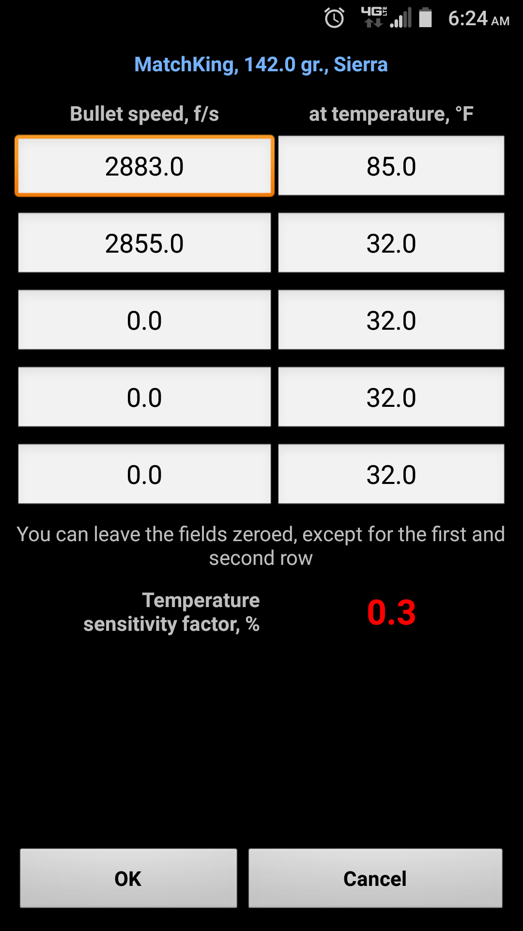

I was going to start a new thread if nothing came up with a search. Zero is obviously disabling the function but for those that are anal I have been using .3% for H4831. A very immaterial difference but a difference it does make...
So, I enter the actual measured difference and Strelok calculates the %. Also, the OP incorrectly converted .4 to 4%. .4=40%. He should had stopped at .4 and used that. I have not backed into how Boris uses the .3 to calculate muzzle velocity based on current temperature. But we can divide the difference above and see the difference is not .3%. He is using it as factor in a formula to get the quotient above.

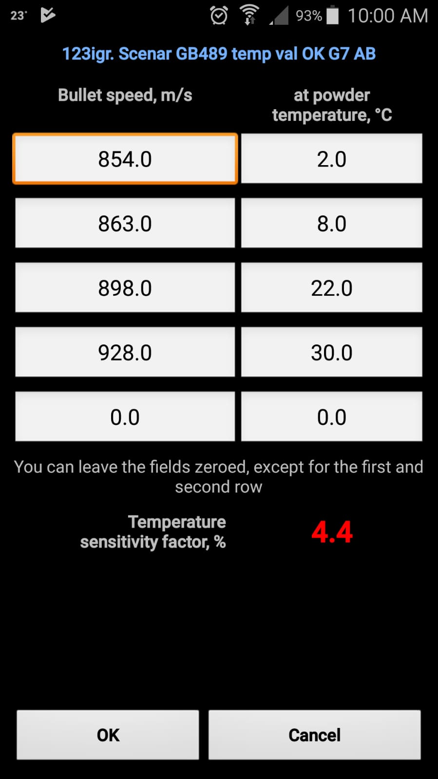

I is some testing regarding this feature on strelok with 2 factory ammo in last 2 years.
First of all it works very well IF YOU INPUT CORRECT DATA.
This app is doing an linear interpolation, for this needs at least 2 valid / verified values to interpolate in between.
My advice is not to use any arbitrary % or out of internet factor.
Is well known the fact that powders are not affected by temperature in a linear way, from 0 C/ 32 F to 10 C/ 50 F you can have a very stable temp with low muzzle velocity change but over 15 C / 59 F to have some spikes also over 25 C / 77 f to have another jump, this is the reason you need valid data for all temp range you are shooting in.
If you use a data book and record muzzle velocity or drops in different environmental conditions is easy to get a muzzle velocity for a specific temp.
Ideally is to have a measurement at each 5 C / 40 F change work between your temp extremes an input in strelok only this who make sense.
For example if you get
850 m/s at 0C
853 m/s at 5C
859 m/s at 10 C
870 m/s at 15 C
884 m/s at 20 C
898 m/s at 25 C
928 m/s at 30 C
931 m/s at 35 C
notice this spikes, jumps in speed use them in Strelok as references, intermediary data will be close enough, is no need to input 850 at 0 C also 857 at 10 C because if you use 850 at 0 C and 870 at 15 C and you interpolate for 10 C (strelok will do this for you) you will get 863 m/s close enough from 859 m/s (what you got in the field), closer the measured values, closer to reality results.
From my testing I got to the conclusion this app needs at least 4 known values to be able to get correct results, maybe with stable powders needs less.
Mine is like this, yes I know very unstable powder, is Lapua factory ammo.
