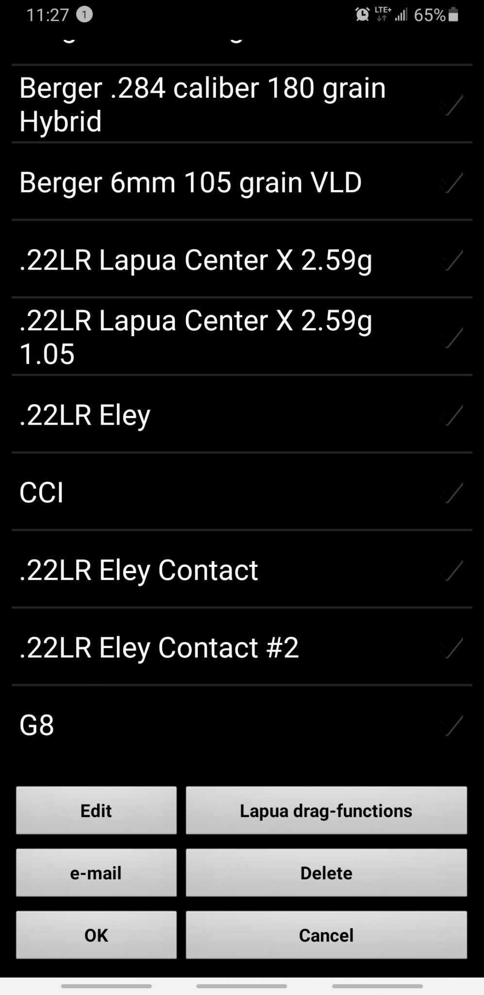

Fwiw, guys, I have been using the Strelok ".22LR Lapua Center X 2.59g" drag curve, available in the selection list where G1, G7, RA4, etc. curves are found, for quite some time. It should be applicable to most if not all SK/Lapua labels. It gives me good solutions out to 415 yards, which is as far as I've seen targets in matches.
I just checked to make sure the curve is still there on the list... uh, yeah, there are five of them, all with same name. I'm not messing with my setup because it works... it would be interesting to know why there are five of them but there is coffee to be consumed and newspaper to be read...
The reason you have 5 is you loaded it 5 times.
"Loaded" how? I remember selecting it from the pick list (where it appeared once as I recall but that was three years ago) to use, but nothing more. That's not to say I didn't mess with it later - I don't remember. No worries for me, but others may find the info useful. Thanks.
Yup when hit the button for lapua drag functions you then select the one you want to load. That then goes on your mail list of drag functions where you can the edit if you wish.
