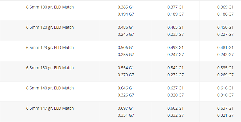

So as I shoot further I notice my impacts become more off. Shooting low. At 1500 I was like 10 feet low. But at 1000 I was dead on. When I went to “true” the velocity to see what was going on at 1500 it said my velocity had dropped like 200 FPS. But I knew that was wrong and went back to 1000 and was dead on again. The only thing I could think of is a drop in BC due to the velocity. How do you all get the velocity and BC at the target to make your longer shots more accurate? I don’t really want to buy a Doppler.
I’m shooting 6.5 CM and I’ve been shooting factory loaded 140 ELDM but am currently working up a load for the 140 RDFs so with this new load I’d like to be able to get it all right from the start.
This is my first steps into ELR shooting so I’m kind of in unknown territory here for me.

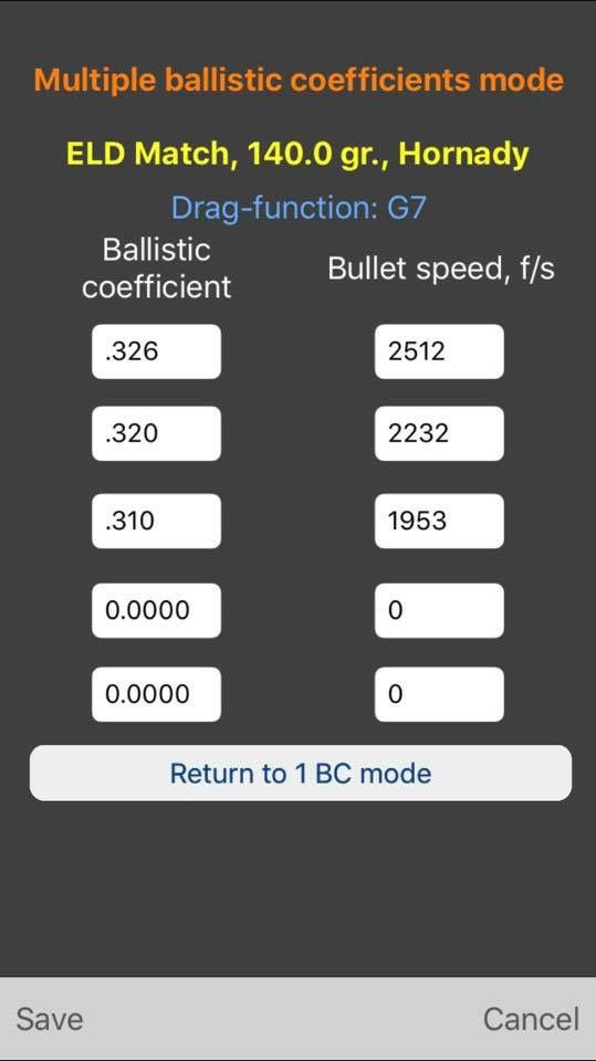

Is your muzzle velocity 2512fps? That's really slow. Secondly, your BC bands are too close together.
The first BC is your initial BC with your muzzle velocity, the second is usually somewhere between 1900-1600 fps, the third is usually after sub-sonic.

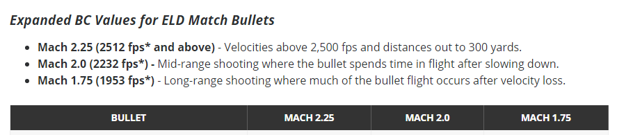

If you are shooting a Hornady ELD-M, go to the Hornady site and dig into the specifics of the bullet data. Hornady has on their site banded velocity BCs for alm,ost all of their bullets. You want to input as many as you can get. (e.g. Flat Line can give you at least 5 or 6 banded BCs for their individual pills; AB custom drag curves are something like 12 velocity bands each with a separate B.C.)
