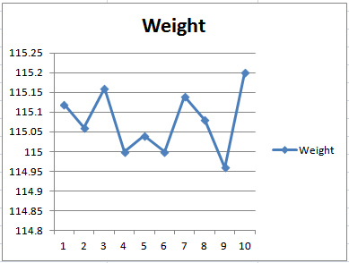

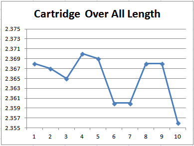

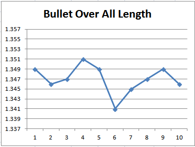

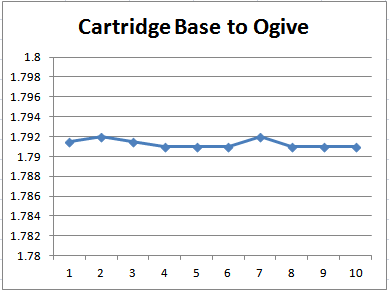

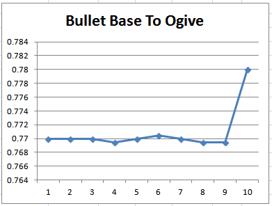

Made these charts awhile back showing all the variables in bullet measurements and how little they matter whenit comes to seating. Im firmly in the brass resists moving for a bullet camp vs the bullet being the bad apple.

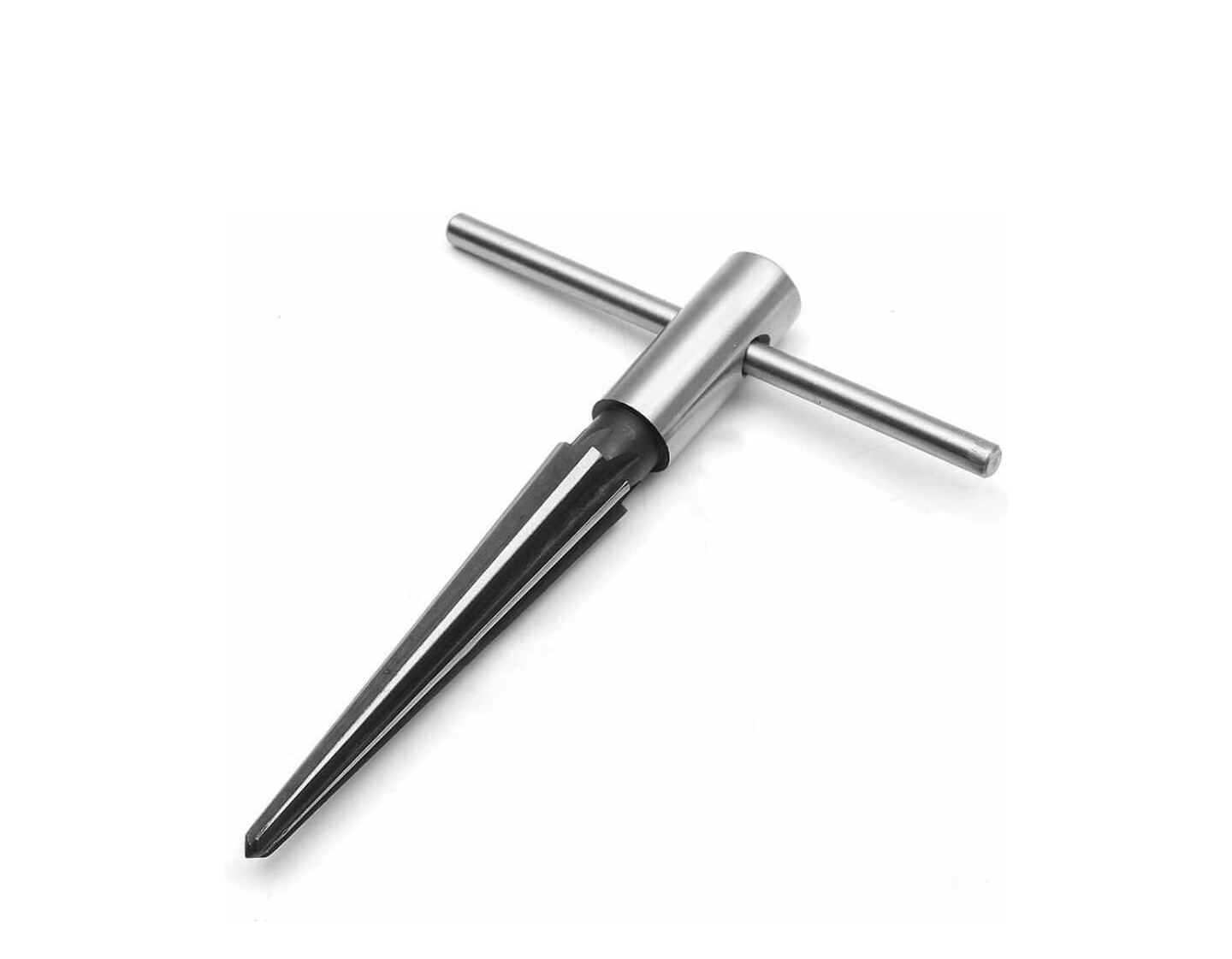

Weaksauce! My Lee does +/-0.0015 or better. I drilled deeper into the stem, put the stem into my drill chuck and used this reamer to make my own ghetto VLD seater.... then polished it with kratex bits :) it's the cat's meow now.
