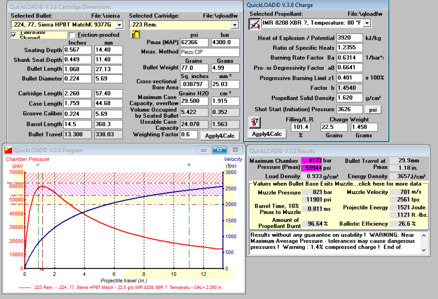

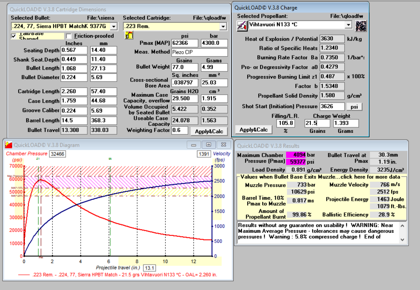

You’ll want XBR and N133 out of a 14.5in. Varget is a bit too slow. XBR and 77smk/scenar is the easy butter for speed, temp sensitivity and burn rate.

With XBR, some (including myself) have gone all the way to 23.5-23.8 with the right chamber and the right brass and the right temperatures. This is well well well above max book. Even 22.5gr with the 77 is in 60K PSI territory on a hot day. Make sure you're using LC 556 brass and not the commercial LC 223.
N133 you can do 21-21.5 with 22gr being around 61K PSI but I would go no higher than 21-21.5 as the risk of hitting pressure and blowing primers is higher with N133 than with XBR.
XBR should also give you an approx 50FPS faster over N133 for the same pressure but N133 will give you a better/cleaner burn.
I really appreciate it. I won't go anywhere near book max because I'll be shooting this rifle in the rain / mud / heat. I'd prefer to stay at a safe distance away from blowing up lol
