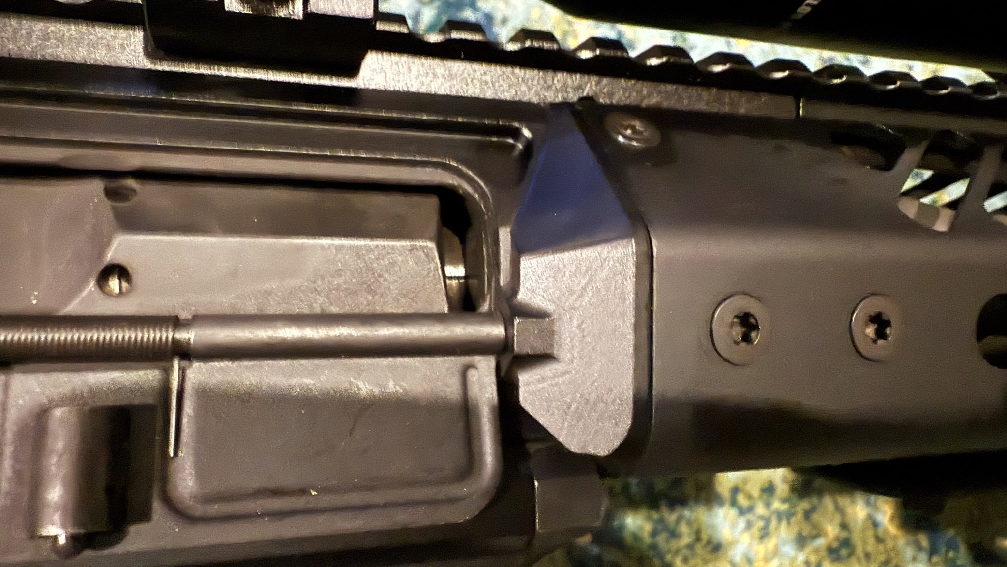

    Any advice on removing 8.6 Blk brass from a Seekins SP10 and Mos-Tek barrel?
    I was shooting suppressed 300 gr and the shot sounded louder than the others. Doubtful a double charge of A1680 but anything is possible I suppose.
    The bolt is about 1/8” or so open (see pic) but actually ripped off one latch of an ambidextrous Geiselle Super Charging Handle the bolt is so stuck. The latch is open though on the CH so that’s not preventing it from opening.
    I used spray lube and a solid brass rod with a lot of force and still not budging.
    Considered removing the barrel but not sure how that would be affected by the bolt extractor holding the stuck brass.
    Thanks.

    Hold charging handle to the rear and tap (slight force) buttstock on table. Your bolt should come back and eject your case. Of course do all your safety checks first...

    The charging handle is already open and not hindering. I’ll give it a shot but this level of stuck is unfucking real. A solid brass rod and reverse mortaring the rod on concrete didn’t budge it 😳
    Hammering the rod didn’t either. 🤷‍♂️
    Yeah, sounds like you have a primer in the cam pin opening on the bcg. That's still my bet on this one. Mine was a real bitch to deal with also. It took a fairly strong series of hammer blows on the brass rod to get it moving. Didn't scratch my receiver or mess anything up so not sure where the "bubba" comment came from above. Either I was going to do this or somebody else was...
    Try putting the carrier further into battery if you run out of other ideas. Might squish the primer in a way that then allows retraction to be a little easier. But might not. Sorry, man. It's a YMMV kinda deal if it's what I think it is.
    Prying w/ a screwdriver maybe budged another 1/8”. Mortaring didn’t help. I’m almost certain a primer stuck in there. I’ll look into moving back into battery but no forward assist so may have to remove stock??? Probably will give to my smith and see what he comes up with at this point. Thanks.
    It sounds like your bolt is not being allowed to rotate out of battery. Regardless of whether it is a primer cup or overpressured brass that flowed, if it is still even partially in battery no amount of hammering from the front is going to get it moving.
    That direction of force is exactly what the bolt and barrel extension is designed to contain.
    If you are intent on trying to get it open via kinetics (beating the fuck out of it) your best bet is to ignore the bolt and try to get the carrier moving to the rear. If you can do that and things hold together, the carrier will try to finish camming the bolt out of battery.

    OP, if you’re still wrestling with this, also try using some kroil and gravity to your advantage. Try to move the carrier slightly and invert the gun occasionally, then give it a couple non-hulk smacks with a rubber mallet. Might dislodge the primer with some luck. Hope it works out without too much drama, man.

    I can’t separate it in usual fashion.
    There’s are larger gas ports on the bc and may be able to use a steel dowel and force back on the bc. Thanks for the advice.
    Once you get the stock and tube off you can tap the BCG back into battery, drop the lower off and try to shake the primer out. Move BCG back and forth. If no success. Drive it fully reward. The primer will be in the lug recesses of course. Normally you can shake it out.

    I separated the upper from the lower, mounted upper upside down. Grabbed a big flat screwdriver, and a shop rag. Though a chunk of leather or flexible plastic of some sort would be best. Place the item of protection between the receiver and the screwdriver, and pry. Shop rag even folded on it self multiple times, I risked cutting through it to the receiver and damaging it.
    When done, zero damage or marks. Just go slow.

    Thanks. I’ve definitely tried that. I appreciate the input though. Won’t budge.
    My money is on that approach failing also.
    I hope I'm wrong.
    That would work on a stuck case.
    If you had a stuck case, I feel like you would have already stripped the extractor through the rim and the bolt would be free to move to the rear leaving the case in the chamber.
    I still think your bolt lugs are still rotated into battery. If this is even partially true, no amount of force generated from the front onto the case and bolt is going to magically rotate and unlock your lugs.

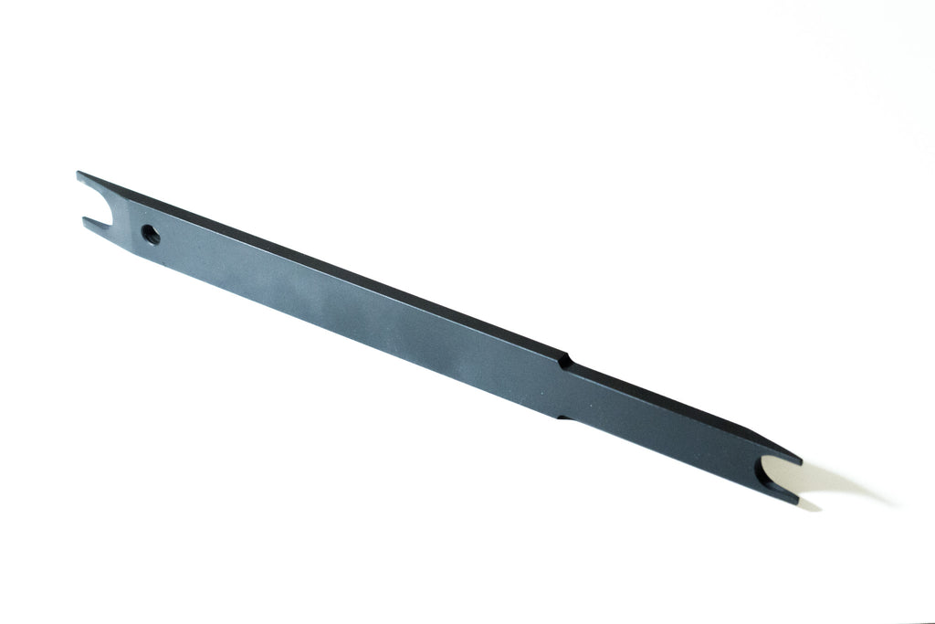

    The reason I suggested the tool I posted above is because it will apply force to the bolt carrier which will cam the bolt and disengage the lugs. As long as the extractor hasn't ripped the rim additional rearward force will dislodge the case from the chamber. If the rim is ripped off then the grease gun option is a viable solution.

    I was able to remove the upper from the lower thankfully.
    Sent the upper to my smith and he’s tried a lot of techniques, none successful unfortunately. Not tried the grease gun though.
    Unsure what to do but a stuck primer is the leading theory.

    The only thing that budged it was clamping it vertically in a barrel wise , putting a giant ass 12” screwdriver horizontally in the rear/bottom cut in the BCG, holding the grip with one hand and clobbering it like Thor with a rubber mallet.
    Inspected the parts, did a functions check, still shooting the gun today thousands of rounds later. I’m not saying you should do this, but it worked for me.

    My gunsmith agrees with Terry about being unable to rotate out of battery with front pressure via barrel. He was unsuccessful trying pressure with various techniques. Not sure what all.
    Anyway, I’ve got $200 to anyone that is willing to give it a shot and successfully get it functioning again. I’ll cover shipping.

    If I have followed the thread correctly, you have separated the upper-lower halves and your photo seems to show the free end of the firing pin retaining pin exposed on the right side of the bolt.
    Perhaps removing the firing pin to allow the cam pin to move as freely as it can might help.
    1. Drill thru the exposed end of the firing pin retaining pin hole to reduce the diameter or remove the splayed pin entirely THEN leverage the lip on the back of the firing pin to liberate it from the bolt. This would allow the cam pin to rotate and disengage any primer part from the cam pin path.

    Hell, thanks. I’ll look for closely and consider that

    Have you tried to force it closed all the way. Might be able to dislodge whatever is stuck then give it another try on getting it to move backwards.
    Wondering if a slide hammer could be secured to the bolt carrier through the back end. This may work getting the carrier back and unlocking the lugs vs using a screwdriver to pry everything open/apart.
