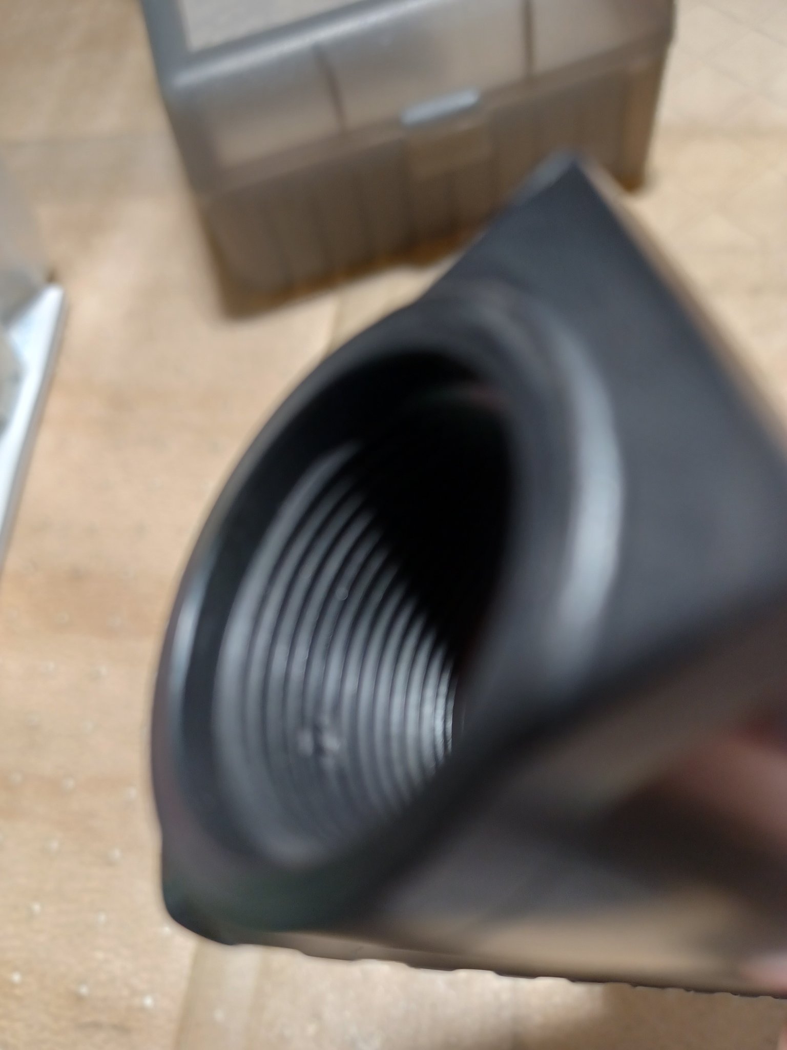

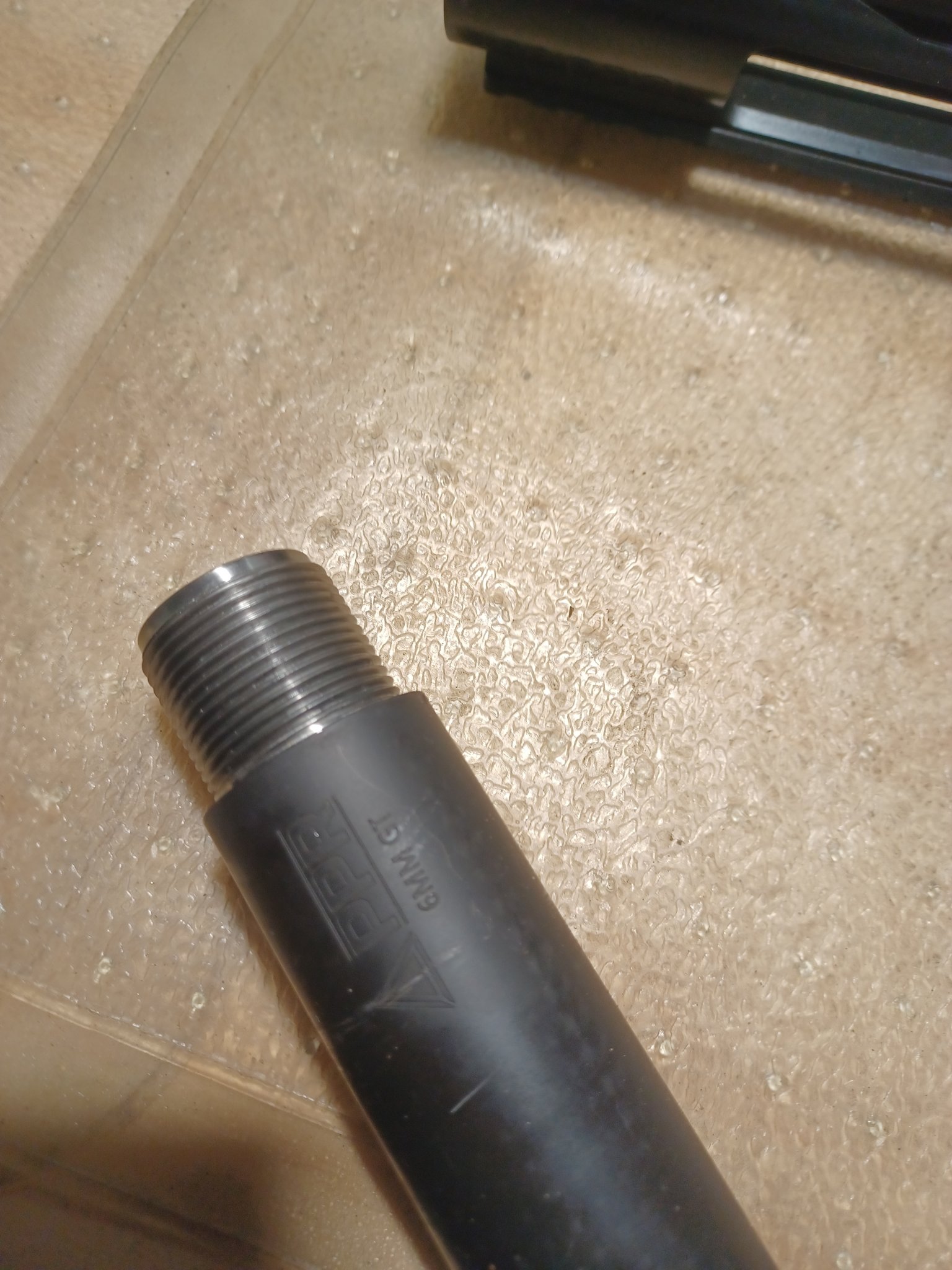

Pic of threads? Just because I’m not the only curious one. That being said I had a custom action and barrel that I bought. When I went to take the barrel off I found the threads coated in red loctite
Just finished removing my barrel. It was cheaper to buy a complete left handed rifle than try and find a LH action in stock....... I read all of the hints above and the sandpaper between the barrel and barrel vise was the ticket. I Kroiled the barrel from inside the action for a few days, put the barrel/action in the freezer, heated the action, etc. but the barrel kept turnng in the vise. Tried dry wall tape (figured I would go from least agressive to more to prevent barrel marking even though I wasn't planning on using it.) Finally put a thin piece of 300 grit sandpaper foled over so grit was on the vise surface and barrel surface. The taper on the barrel only allowed the use of the two closest bolts on the vise. Two good dead blow smacks on the Wheeler action wrench and it popped right off. No marks on the barrel of action.
Happy guy. Now the 3 month wait for the carbon 6 barrel. I put the factory barrel back on to shoot it it in the mean time.
