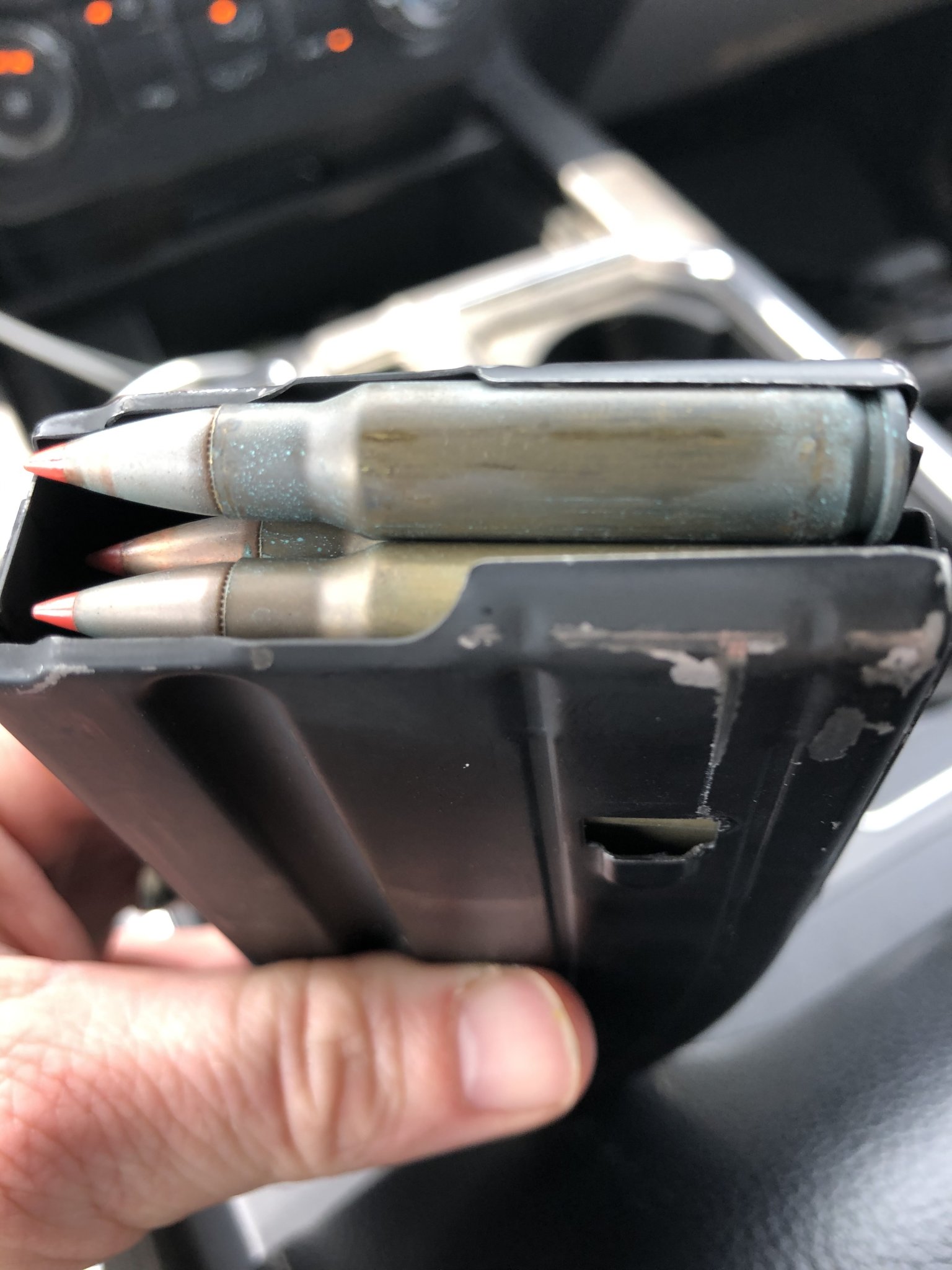

    Do you have photos of the fired brass ? ... And of the loaded but not fired round ?

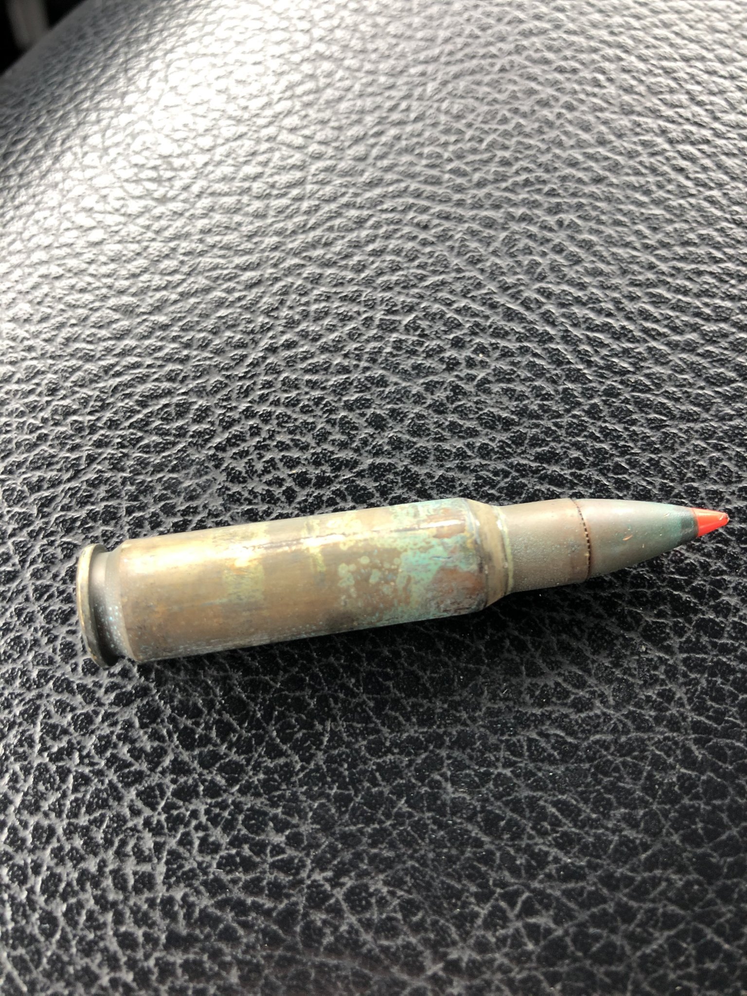

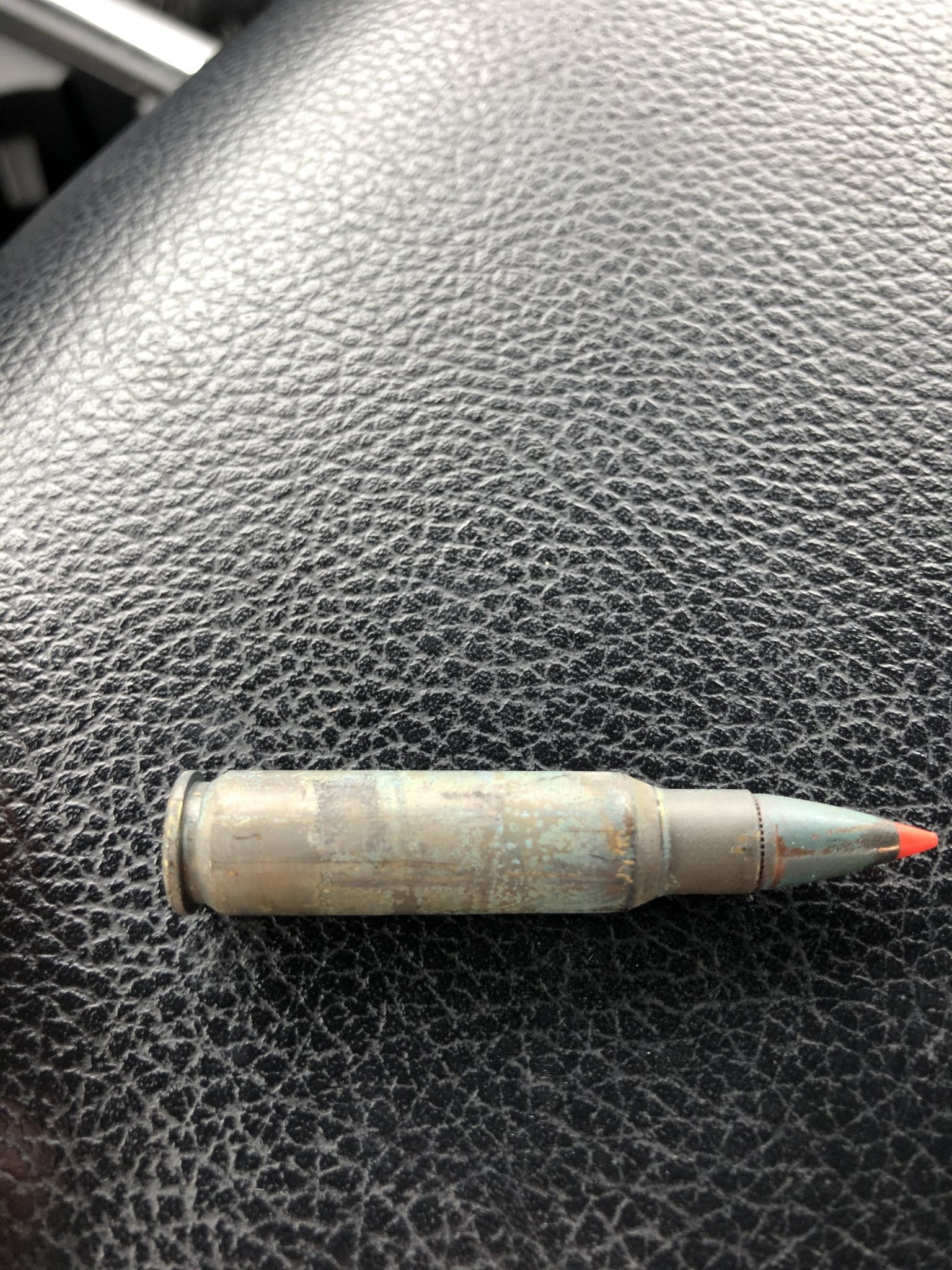

    Here’s a picture of one of the stuck live rounds I had to mortar out this morning. Before this was taken, I did end up polishing the chamber as best I could with Flitz. I didn’t have any failure to extract, but didn’t do a whole lot of shooting to get the barrel all that hot either.
    I'd hit up the owner of ARP. He posts fairly regularly here. Goes by the name Constructor I do believe.
    View attachment 7283074View attachment 7283075
    Looks like it was salvaged from the Titanic. What did it look like before it went into the chamber? How long was it there?

    I’m shooting 100% suppressed, so the rounds are never going to be spotless loading out of the mag. I will say rounds sitting in the mag don’t get any dirtier than my other 300blk SBR?
    Were those rounds stored in salt water or battery acid.
    Nasty looking.
    Had my son store fired brass in steel ammo cans long term that looked like simmilar corrosion.
    I started using car wax in my dry tumbler media, no corrosion or even tarnish since.
    Guessing ss wet tumbled super clean brass could end up like that.

    Again, there is zero external corrosion on these rounds before I use them. We’re talking brand new boxes of factory ammo. No storage, no saltwater, no nothing like that. Thanks for the thoughts but this is barking up the wrong tree.
    I’ve had lots of SBR’s, and used every one of them exactly the same. I’ve never had an issue like this before. I should be able to shoot my gun, leave a round chambered, put it on safe, and trust it to work properly the next time I pick it up. It’s not an unreasonable expectation.

    It would be nice to know what that virus looking case rot is.
    And wonder if it is contagious?
    A list of gun solvents that could cause that would be nice. I have been lucky and managed to avoid them.
    I sincearly hope none of that rot gets into a suppressor.

    I fully accept your NIB ammo comment... but something is corroding your brass and copper bullets.
    That blue green corrosion is "classic" "brass corrosion.
    I can't say I have seen that happening so rapidly / thoroughly corroding NIB brass. ( 35+ years of reloading and shooting, Oorah )
    What / or how / with what, are you using when cleaning your suppressor ? ( Maybe something internally is blasting into your upper )
    And I suggest you take apart a few of the rounds and look at the powder inside of that specific ammo... clumped ? , stuck together ? , compressed ? Smelly ( breaking down ? )
    Look at the bullet bases of the pulled apart rounds.. for corrosion.
    What lube ? ( maybe producing corrosion ? )
    At the very least... try some different OEM ammo... and hold off firing those other rounds... just in case they are "bad".
    We all know , Those corroding cases are not going to help your firearm cycle.... tapered cases ( 7.62x39 ) might tolerate that corrosion, and operate ( far less force to extract )
    Combine the failure to cycle, and that resulting corrosion... and your ammo may be "compromised" some how at the powder... and that "could be" dangerous if the powder is maybe breaking down.
    IE.... better safe then sorry.
    Something in your setup is producing / causing odd corrosion.
    I strongly suggest you check your suppressor as well... that corrosion is most likely in there as well.

    The ammo is Hornady 120SST ammo. I usually buy it a few boxes at a time from various Academy stores during my travels. So same ammo but from many different lots.
    It is an interesting conversation, I haven’t thought about it from the corrosion perspective just yet until everyone brought it up. I know the brass is 100% spotless until it gets loaded in the mag. From my loaded/used mag you can actually see the corrosion starting. With a suppressor I’ve always seen rounds in mag get carbon/powder residue; but come to think of it never seen corrosion like this.
    Once it’s loaded into the chamber it gets much worse. Is this just a continuation of the process started in the mag, or is there maybe some condition in the chamber that is accelerating it?
    I don’t clean my can, ever. The receiver/BCG gets cleaned with a normal CLP then lubed sparingly with motor oil. The barrel has only been cleaned a few times, and only because of this issue. It’s not like a have a bunch of crazy solvents sloshing around in there?
    Just a piece of advice from an old guy, not a fudd.
    I was born in the 1950's been shooting and cleaning guns since the 1960's.
    FLUSH ALL THAT SHIT OUT OF YOUR GUN AND CAN ASAP.
    Whatever the combo of stuff it is that eats brass that quick is not good for your barrel or suppressor.
    Get yourself a standard brand and use that. Being old of course I suggest Hopes since I have never had a failure due to them.
    Not to argue that there are not better products but seems you are not any better at finding them than I.
    Quit f-ing around before you toast the barrel and can.
    Wait.... those corroded rounds in the mag... those were ONLY hand loaded into the mag. ( IE never inserted into the firearm, strictly and ONLY loaded into the mag
    And that mag was not inserted while you fired a round ?
    I had "assumed" that the rounds in the mag were after a round had been fired.... since the top 2 appear "more" covered in corrosion, the 3rd one looks "less" covered.
    And I could see where one of the rounds had been stripped away ... ( might have been wrong)
    If those rounds were loaded into the mag ONLY ( not the rifle ) .... where are those mags stored ? .... In Web Gear ?... maybe soaking wet at one point in time web gear ... then put away not fully dry ?
    Leather used to be notorious for this kind of corrosion.... with it snug fitting loops holding revolver cartridges... retaining moisture closely to the cartridge surface. ( part of the reason for nickel plated cartridges )
