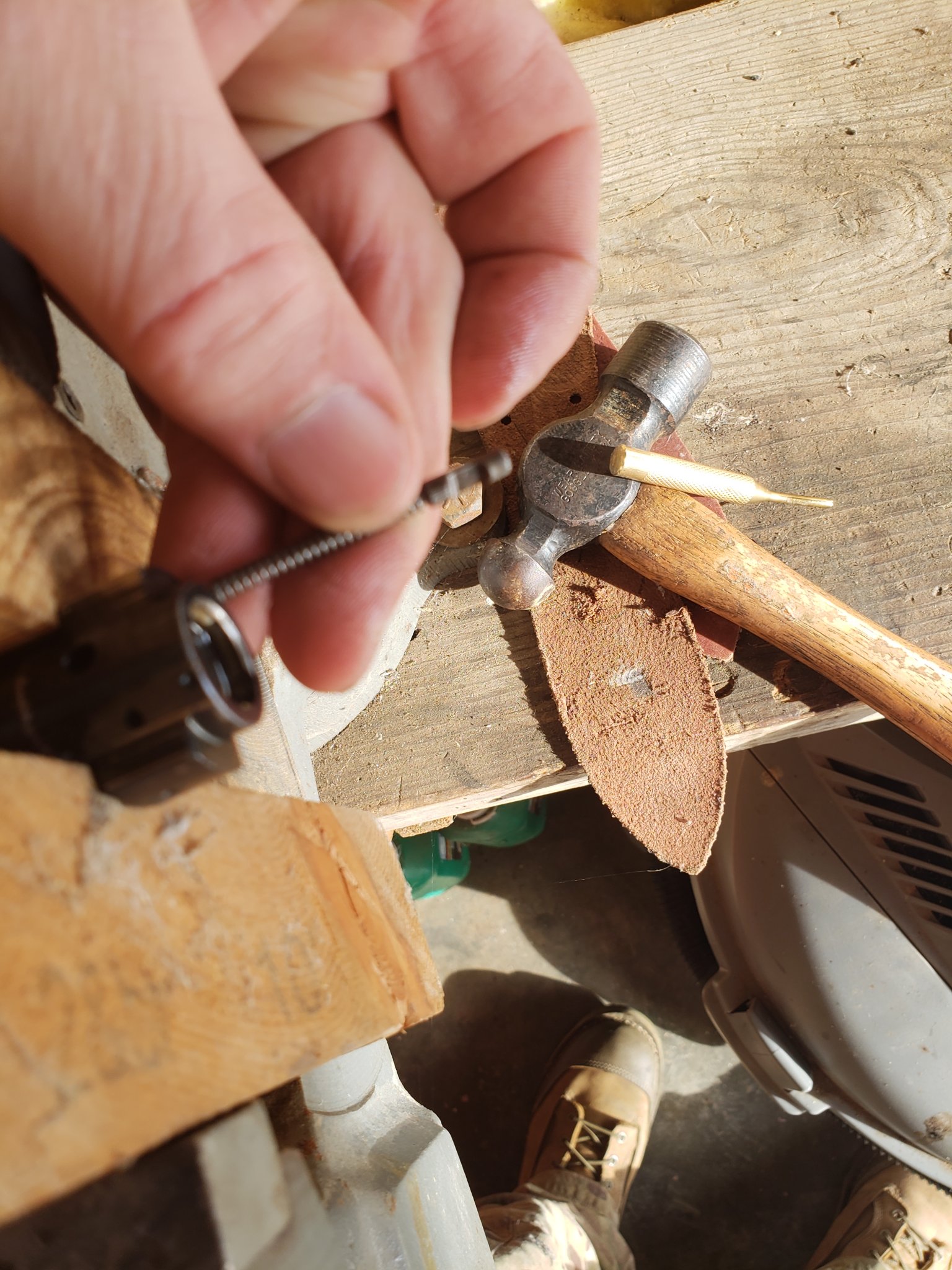

Thanks for the advice everyone. Ill give the brass punch a try after work.

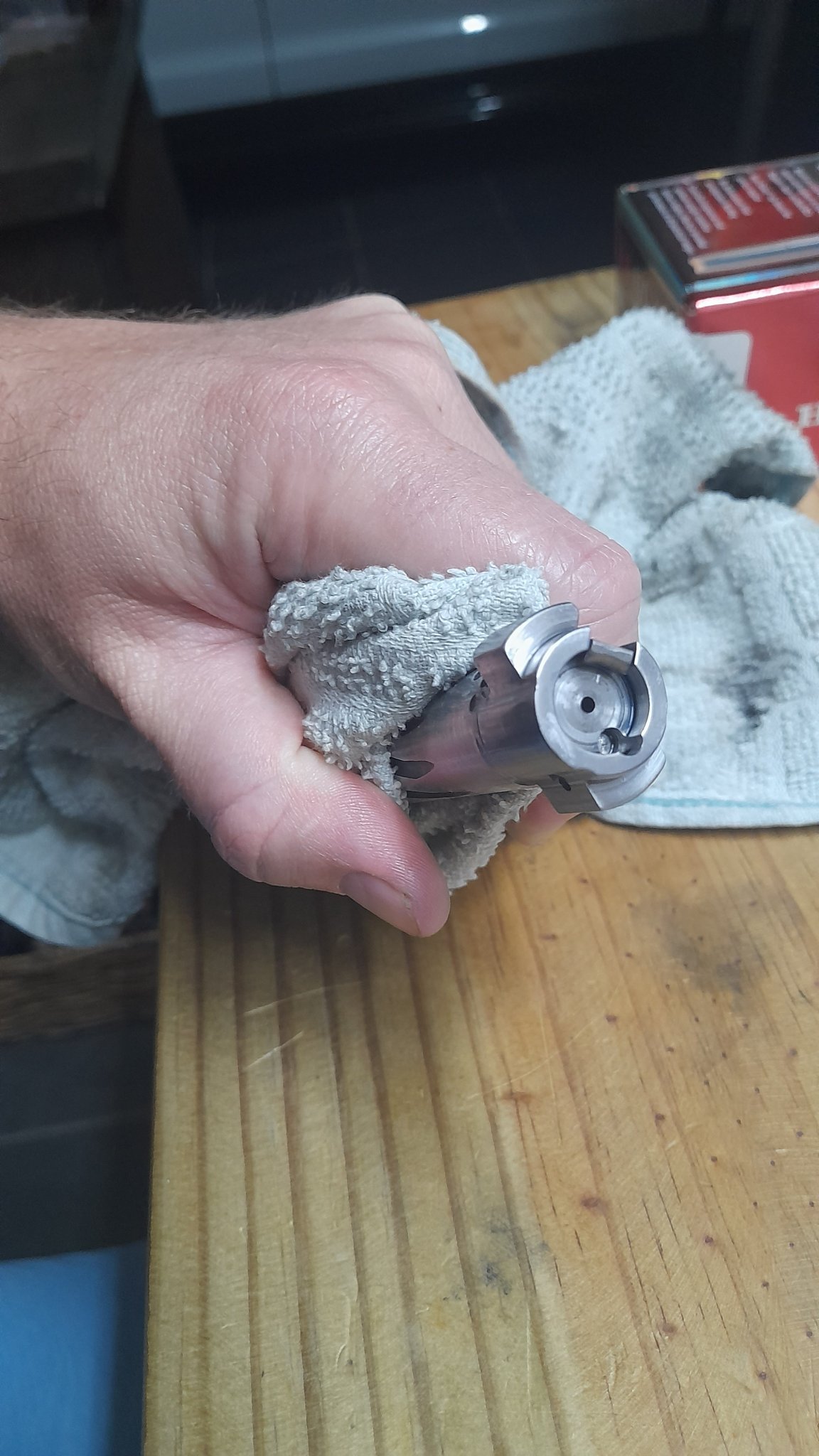

Sorry to resurrect this.
Had pressure problems. Long story but my plunger/extractor doesn't want to move.
Got home from the range. Was a bit angry, but not too bad. Stripped the bolt. Popped it in the sonic cleaner, probably should have waited longer, soaked, etc. Gave it a firm tap with a punch. It moved, went down, now it's just stuck further down.
If I look through the pin hole I can see the bottom of the plunger just on the left hand side. So I can't put the pin back in. Not sure if any of this is a problem.
It's in copper solvent now. I can go get whatever else. Have I broken it, or will it just drop out when whatever is in the hole melts?

The ejector retaining pin (the roll pin)has been flattened where the ejector smacked into it, and is now binding it. The over pressure event launched it into its hole. Usually the pin can still be driven out. Go slow. If youre not up to it, send it to a gunsmith.
