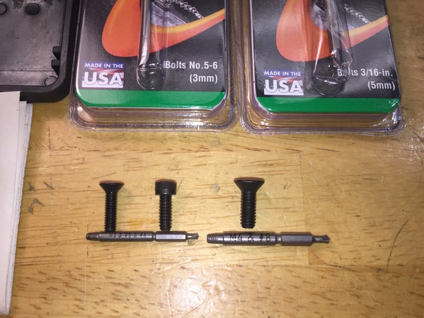

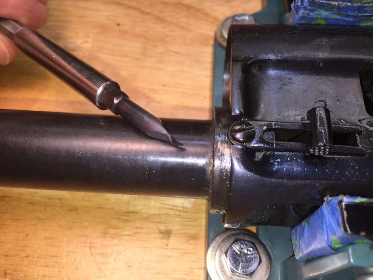

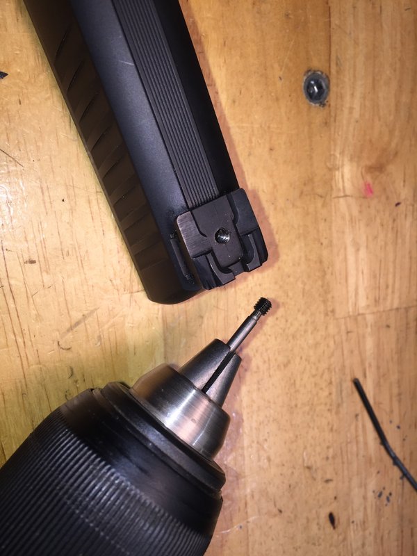

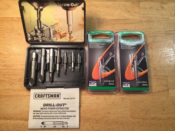

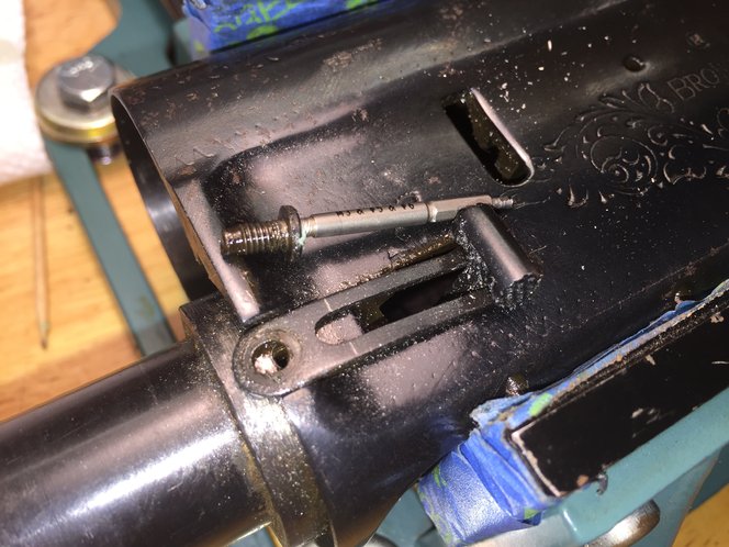

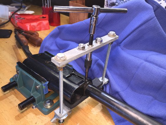

IF the screw head is accessible in order for you to get a reversible hand drill with the bit installed, then I would try using one of these Grab-It bits. They run about $10-15 each online.
I have every imaginable tool and bit to remove gunsmith screws and employ all the usual tricks to remove the difficult ones in order to save special screws; however, sometimes you just have to drill them out.
Make sure you tape-protect the surrounding scope rings before starting.
Here are two recent examples of using the Grab-it when other time-honored methods failed.
A 6-40 rear sight screw and a magazine lock-out screw from a 1957 Belgian Auto-5 (screw jack method failed as well)
