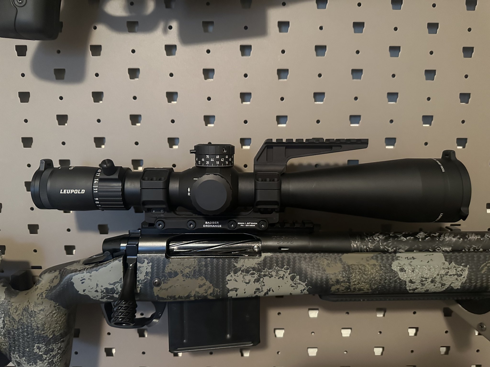

Have all 20MOA mounts and have always used height above bore at turret centerline-should that be at centerline of objective instead?
What, in your opinion, is the best most robust mount to use with a 20moa cant on a 338LM with a NF 7-35 ATACR ? Want something that will have the best odds against moving from recoil. Here is the kicker, money is no object as when you calculate the cost of the firearm, the almost $4k optics why scrimp on a mount.
Spuhr, badger max, arc m brace. Top 3 out there. Im a badger max guy
Well off to the races. Just ordered Spuhr 20moa, LRA Send-it and mount for the spuhr. Damn this crap is expensive. I thought the +$3800 Scope was bad. another $1k but I SHOULD be set now.
