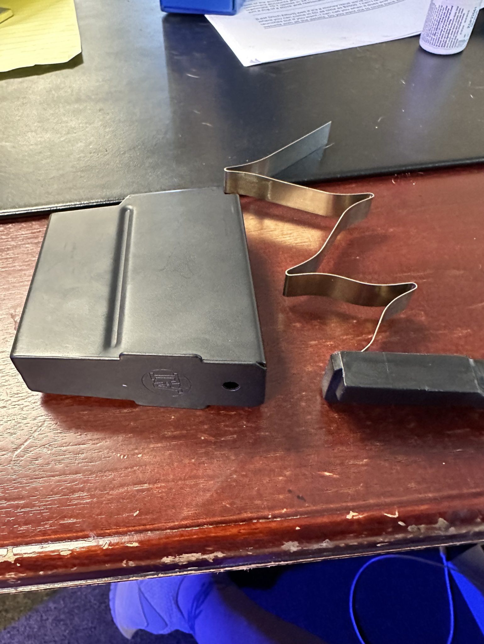

I was messing with the mag cause it won't feed worth a $hit and apparently I disassembled it. Looks like the bottom is one piece - is it or is the bottom plate removable? Cause I cant seem to put this back together...
I was messing with the mag cause it won't feed worth a $hit and apparently I disassembled it. Looks like the bottom is one piece - is it or is the bottom plate removable? Cause I cant seem to put this back together...View attachment 8472870
Yep it's welded it's a little dance to get it in there but it will go
Reactions: Aggrofish
It is one piece and not removable.

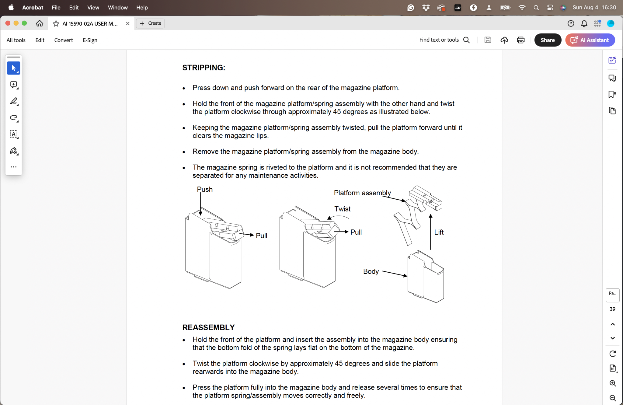

Here is a photo of the process to reassemble from the AT manual in case you don't have one
