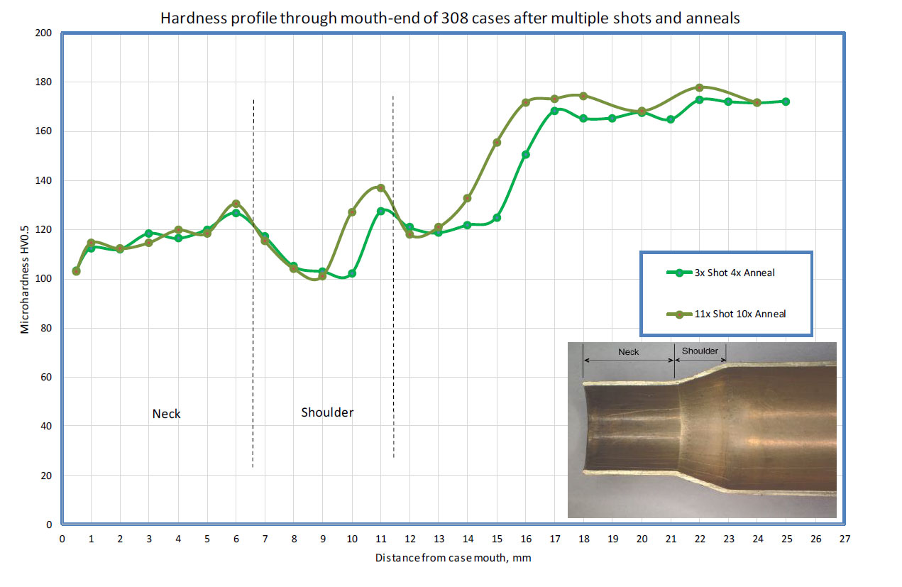

I dont anneal for case life. Most on here dont.
What we are after is setting the case neck hardness the same each time so that we are able to get a consistent amount of neck tension on every single firing of the cases life. Extended life before splitting is just a bonus.

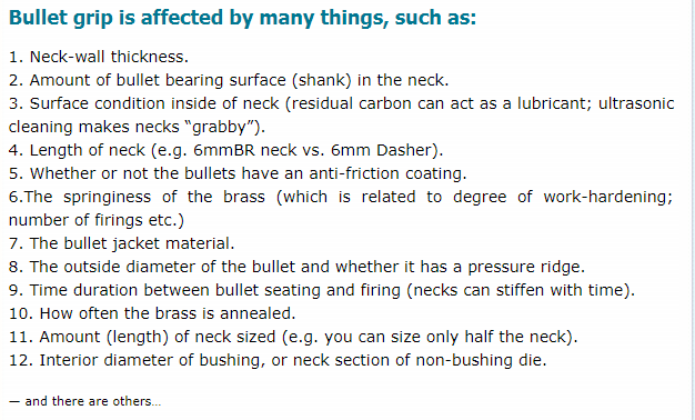

Yeah, as the hardness increases (and springiness/malleability) you could try to swap bushings in an attempt to maintain an equal amount of bullet grip. http://bulletin.accurateshooter.com...n-bullet-why-bushing-size-is-only-one-factor/
But how you would do it beyond constantly testing and guessing Im not sure. Do it enough I dont doubt you could develop a feel for it. Hyrdo arbor seating presses will help quantify how much force is holding the bullet, or rather actually how much force it takes for you to insert the bullet.

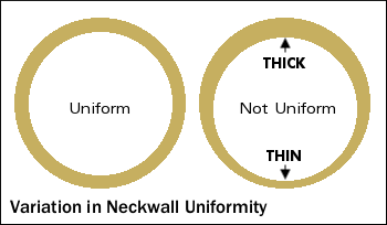

Most use bushing dies to avoid overworking the necks, not to set the final neck tension. Different thicknesses of brass require different bushing diameters for minimal amounts of working the brass.
Unless you have perfectly even turned necks youll probably want to use an final reexpansion to have a consistent internal diameter.

Annealing helps with keeping neck tension consistent (which affects SD and ES) and it also helps alleviate brass from getting split necks.

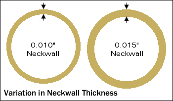

More than likely it is. You can measure the neck diameter of your loaded brass and then compare that to the neck diameter of your fired brass in order to find out how much your brass is getting worked.
Let's say hypothetically you start with .308 brass which is prepped for seating bullets and has an outside diameter of .336" with neck thickness of .015" per side for .030" total. When you insert your .308 projectile it will have .002" neck tension and expand your neck to .338". After firing your neck comes out of the chamber at .344" (.006 expansion) and then you have to resize it back to .336" again (.008") to reload it. .002" + .006" + .008" = .016" per firing cycle. This example is fairly representative of a match chamber but .016" adds up over 10-20 firings. A sloppy factory chamber may get you closer to .030" per cycle.

.015x2=.030
.015 is the thickness of one side, double it to get the total amount of neck material
.336-.030=.306
The sized case outside diameter minus the thickness of the case neck material gives you the inside diameter
.308-.306=.002” of “neck tension”
If you take the bullet diameter and subtract the inside of the case neck diameter you see how many inches of interference fit there is between the case and the bullet.
His loaded round necks outside diameter would be .338” by adding the sized case diameter to the amount of interference fit.

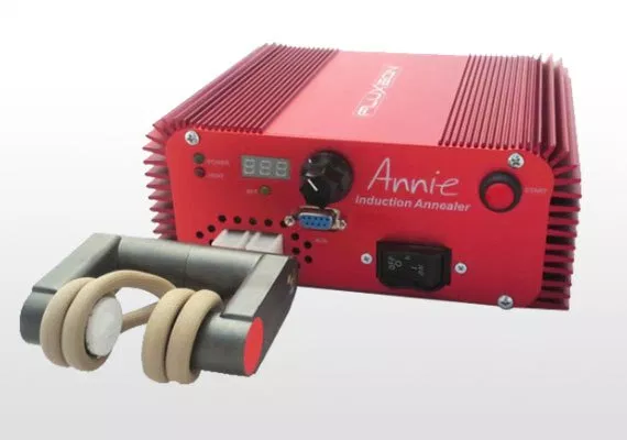

Personally, I purchased the "AMP" unit. The justification was "consistency". I can feel the tension of every bullet seating, and know they are the same (as close as humanly possible). I anneal as part of my process in every loading.
Now that AMP offers custom programming, all of my cases have specific programs (per lot). Rabbit hole? YES. But it works for me.
