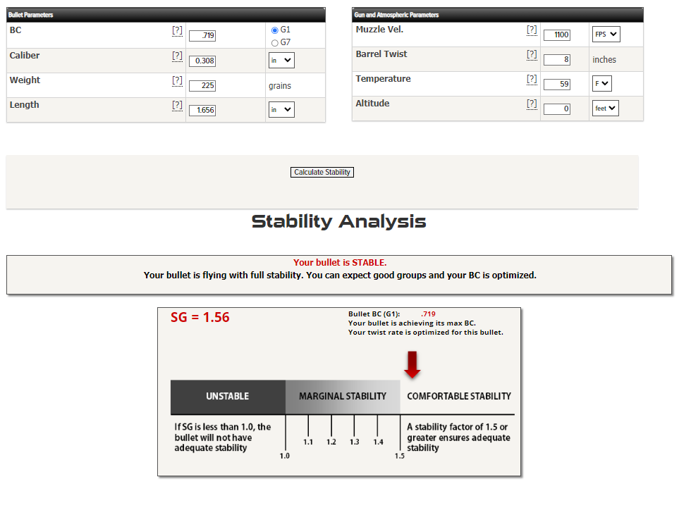

I started thinking this because of the "Berger Twist Rate Stability Calculator"
Everything with a high grain weight, I put in it comes out "Unstable" I don't want to damage my silencer. I know to test and look for keyhole in the target. My silencer is still in jail waiting to be approved. So I figured I would load up some test rounds in quite a few grains to see what it likes. Trying to do some calculations to get a starting point. Everything in Bergers calculator comes out "Unstable".
Seems like you need to learn to work the calculator, here is the heaviest one from your list
