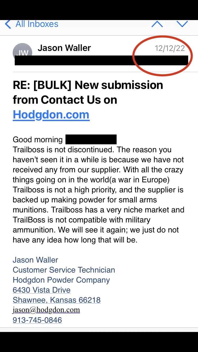

You tell no lies. What powder are you guys using now?
Here’s an email a buddy got back on Dec 22
They claim it’s going to return but not anytime soon 😩
