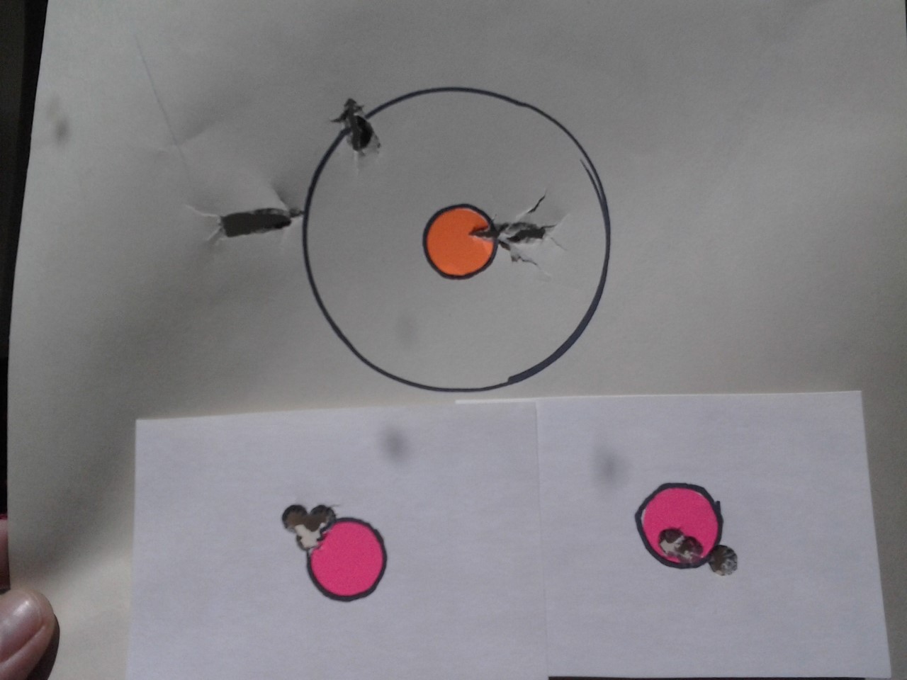

Excellent point to work without a can first, I'm glad I did when I tested these rounds! As you can see they were hitting sideways at 100 yards...

I have found that you need a 1:10" twist barrel to reliably stabilize a 220gr RN bullet out of a .308. 190gr matchkings work well with about (10.7gr of TB) and a muzzle velocity of 1,050 fps in 1:11.
12-13gr TB for the 220RN bullets. 220gr matchings are longer and did not stabilize reliably with a 1:10 twist barrel.
