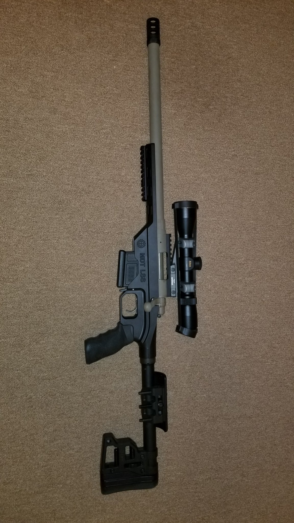

Contact Kevin at Mars Armory. He has done a ton of work with the 45 Raptor and is pretty knowledgeable about the caliber. Also built an awesome 450 BM for me on a LH bolt gun I had

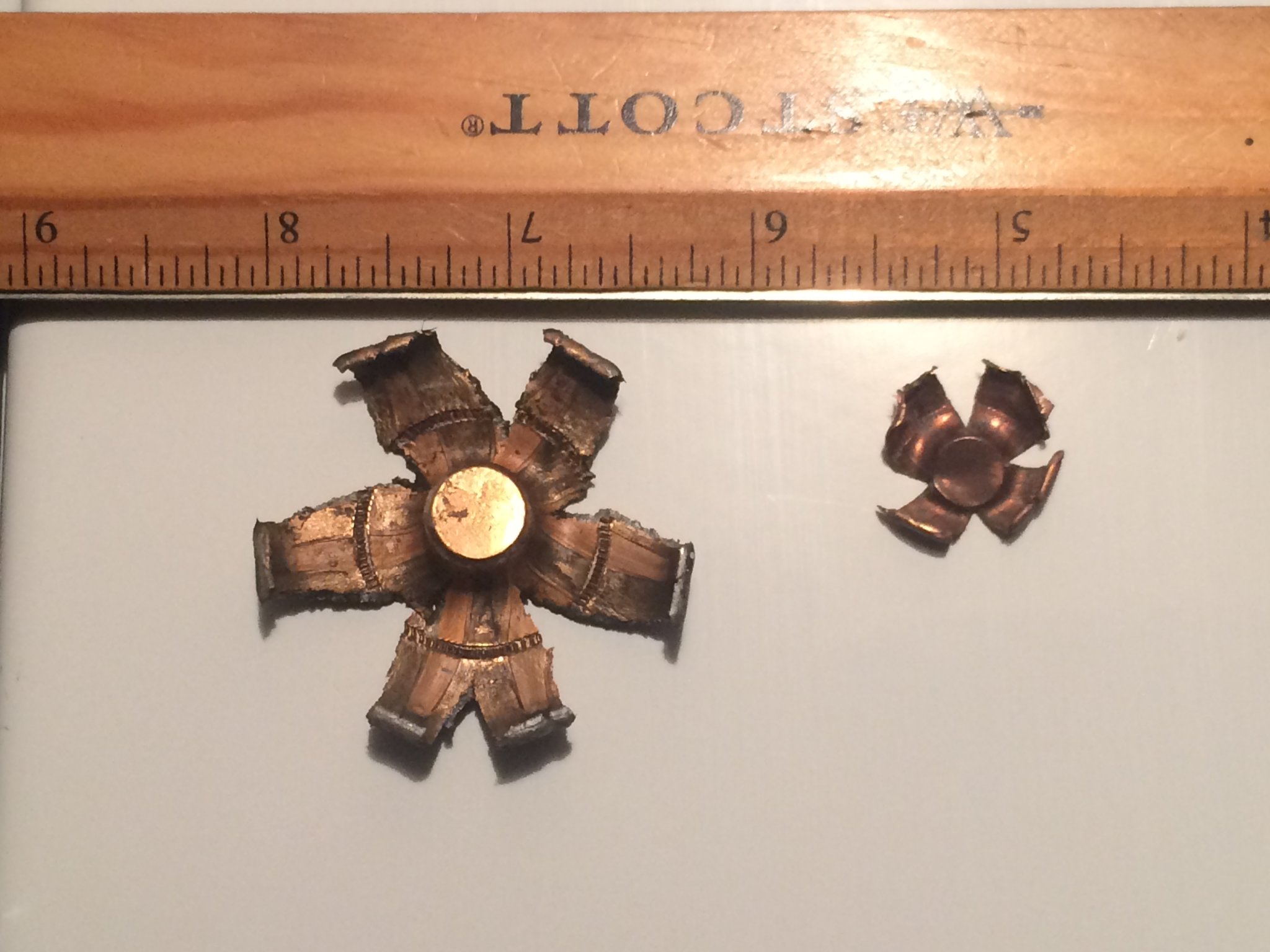

Going subsonic was a big mistake. Accomplished all of my design criteria; cycled perfect, heavy round, subsonic. Problem on deer size game was subsonic. Didn't produce large temporary wound cavity. Went supersonic with 395g Hornady Sub-x round going 1600 fps. have yet to see results on game.
Good terminal performance with subsonics (in any caliber) can be a tricky thing, depending on your expectations. My best results have always been with custom made cast bullets designed for that application, generally with a heavy shank and massive (for the caliber) hollow point. I've often been disappointed with subsonic performance of off the shelf bullets, with just a few exceptions, and faster almost always kills better if quiet isn't a criteria.
