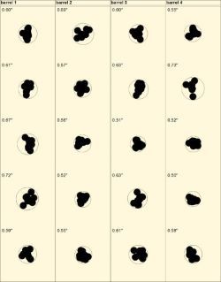

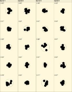

I am asking the people who BR [test] their rifle for certain ammo's that shoot well, is there one ammo that you always use because it performs well for you? Lets limit the ammo to SK costing less than Lapua and Eley less than black box. I am also talking about over the counter 22 rimfire such as CZ'S, Tikka, and Bergara etc. I realize some people are shooting just about anything they can get at this time. If you could get what you want, is there one ammo you would always buy? [no matter the lot #]
I've had good results with SK Standard Plus. However the vertical dispersion seems to be greater than that of Center-X at 200+ yards.
No. :(
What performs well from my last delivery, often doesn't from my next purchase of the same brand.
I blame it on variations in components and differences in tolerances during production at the factory.
This month it's SK Biathlon. The month before it was Eley Match. Next month it might be Midas+.
Same rifle and setup, simply variations in cartridge quality. The chronograph confirms the results on target.
No. :(
He's right🥴
I am going to differ with Justin on this. I realize he has a lot of data. I do not document my results like he does.
What I see is that my Winchester Mod 52's seem to shoot about any lot of Eley Match or Eley Tenex quite well.
Under .35-.4" at 50 yards and under 1" at 100 yards for two to three consective 5 shot groups.
I do not shoot 50 or 100 shot groups as my attention span is short.
Other ammo is higly variable and some is consistantly bad.
I shoot a CZ 457 MTR in ARA bench rest competition, factory class.
Of the ammo you are referring to, I'd say that SK Rifle match would -in general- be the best bet for the most accurate ammo in the rifle brands you mentioned.
However, there's a "but."
In my opinion, it's not about the brand, it's about the lot number. You can get a lot number of any brand of ammo that shoots lights out, yet another lot number of that same ammo just doesn't perform. I think SK Rifle Match may be the best brand for mid-priced ammo, but different lots of it give different performance.
Pay attention to what J. Amateur has said, he's shot enough of every conceivable type of .22 ammo and has the data to back up the claims he's made.
I started shooting bench rest this year with two bricks of outstanding SK Rifle Match of the same lot number which shot really well in any of my rimfire rifles, and did pretty well with that ammo. But I've been able to pick up a few bricks of Tenex of the same lot number, and it does better. But if your shooting outdoors like I am, and you want your best scores, learn how to read the wind. Good wind calls are just as important as good ammo.
I will challange anyone to send me a sealed, undamaged box of Eley Tenex and I will shoot 3 consecitive 5 shot groups on one target at 50 yards and 3 at 100 yards. Groups will be as I stated above or better. Bring on your worst Tenex. :)

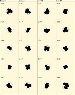

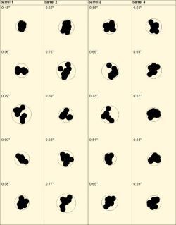

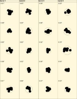

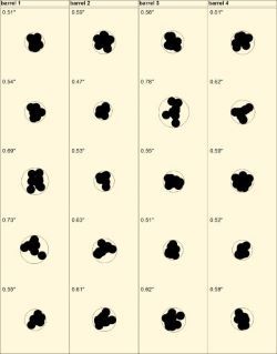

Shooters may find that a certain variety of match ammo usually shoots well in a particular rifle. It's important to keep in mind, however, that not all lots of a certain variety will shoot equally well. At the same time, some lots respond very well in some bores, but not as much in others.
This is true for all match ammo behavior, no matter whether its Tenex, Match, Midas + or X-Act. Lot variation occurs with every production run of match ammo. It occurs all the time. It's not a function of whether it's this month or another because the same rigorous quality control goes into each lot. It's simply very, very difficult, despite the most rigorous attention to quality components and manufacturing process, to produce all match ammo that's equally made and equally good . There's no such thing as perfect match ammo. They simply don't respond in barrels the same way. Not all lots shoot equally well in any rifle.
When it was available, this was illustrated by the Eley Lot Analyser. For each lot of ammo produced, Eley made available its test results through four different test barrels. Some lots of Tenex, for example, were better than others, and some shot better in some barrels but not in all others. And not all lots shot with equal consistency through the same barrels.
Below are nine random lots of Eley Tenex. Each column shows ten shot groups with a different barrel. They show how much variation there can be between lots and between barrels -- and even within the same barrel.
Reactions: Booner1334
