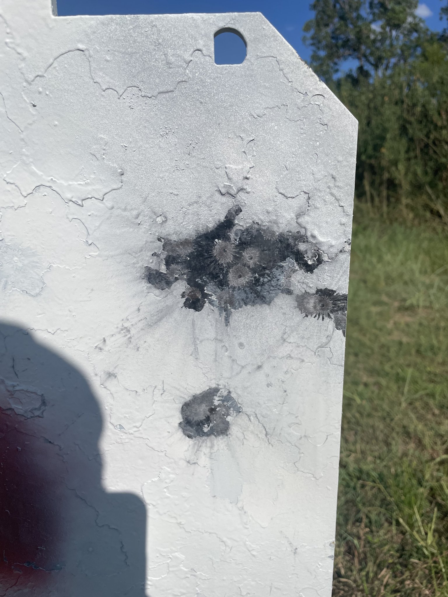

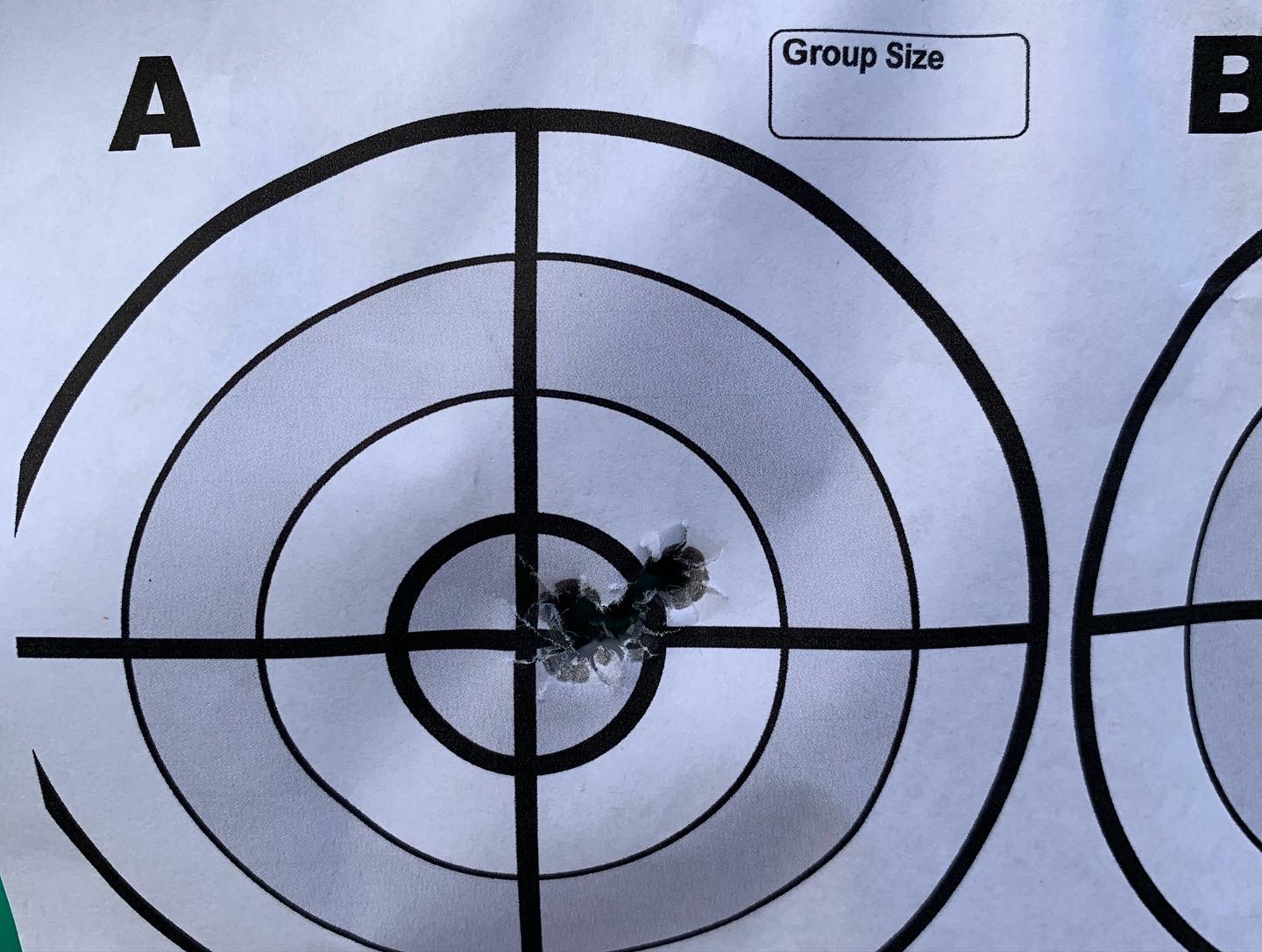

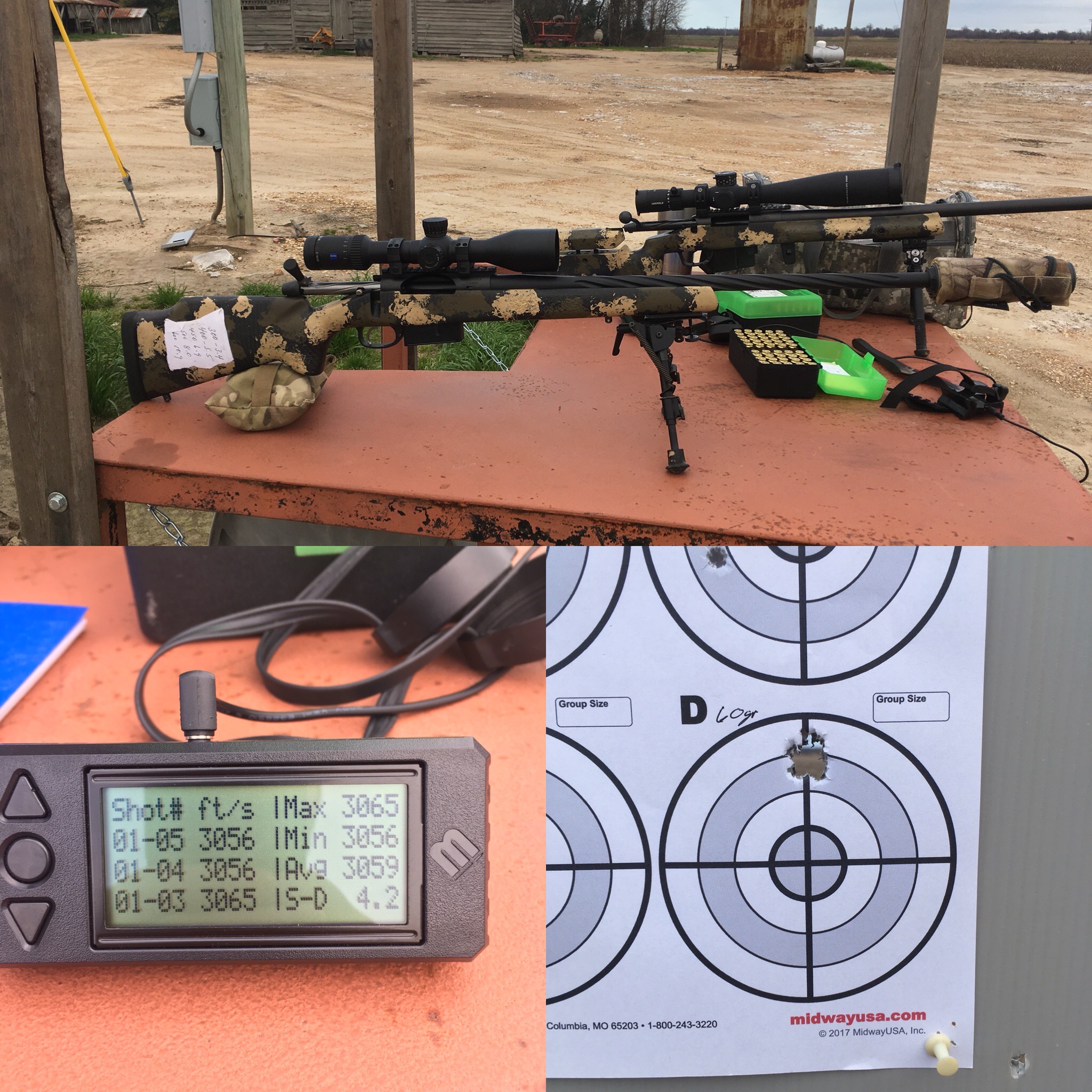

    So I'm scratching my head with this one and maybe it's self induced. This is with my XM3. The first groups it ever printed were astounding easily a 1/4 minute group with norma golden target 175gr. Since the first picture I had the flash hider loosen when trying to take the can off. Took it home and intended to torque it back in place with my barrel vice. I was missing my torque driver set so couldn't remove the barreled action from the stock or just didn't have the right hex screw. I decided to torque it down anyway. Since then it has printed groups like below. I'm starting to wonder if I damaged the bedding? I didn't see anything physically but it just has me perplexed. I thought maybe it's just me and I'm out of practice. However printed the 5 shot group in the attachments today with the LMT LM8 and I'm by no means a proficient gas gun guy.
    Example A:
    This was resighted with the norma in the center (horrid) and load development of 168gr TMKs over varget after remounting the flashider, Settled on 45.3gr. I since remounted and timed with the barrel in my barrel vice. Test seating depth today. Should've grouped the norma again but forgot to. The last two pics are setting depth groups I shot today.

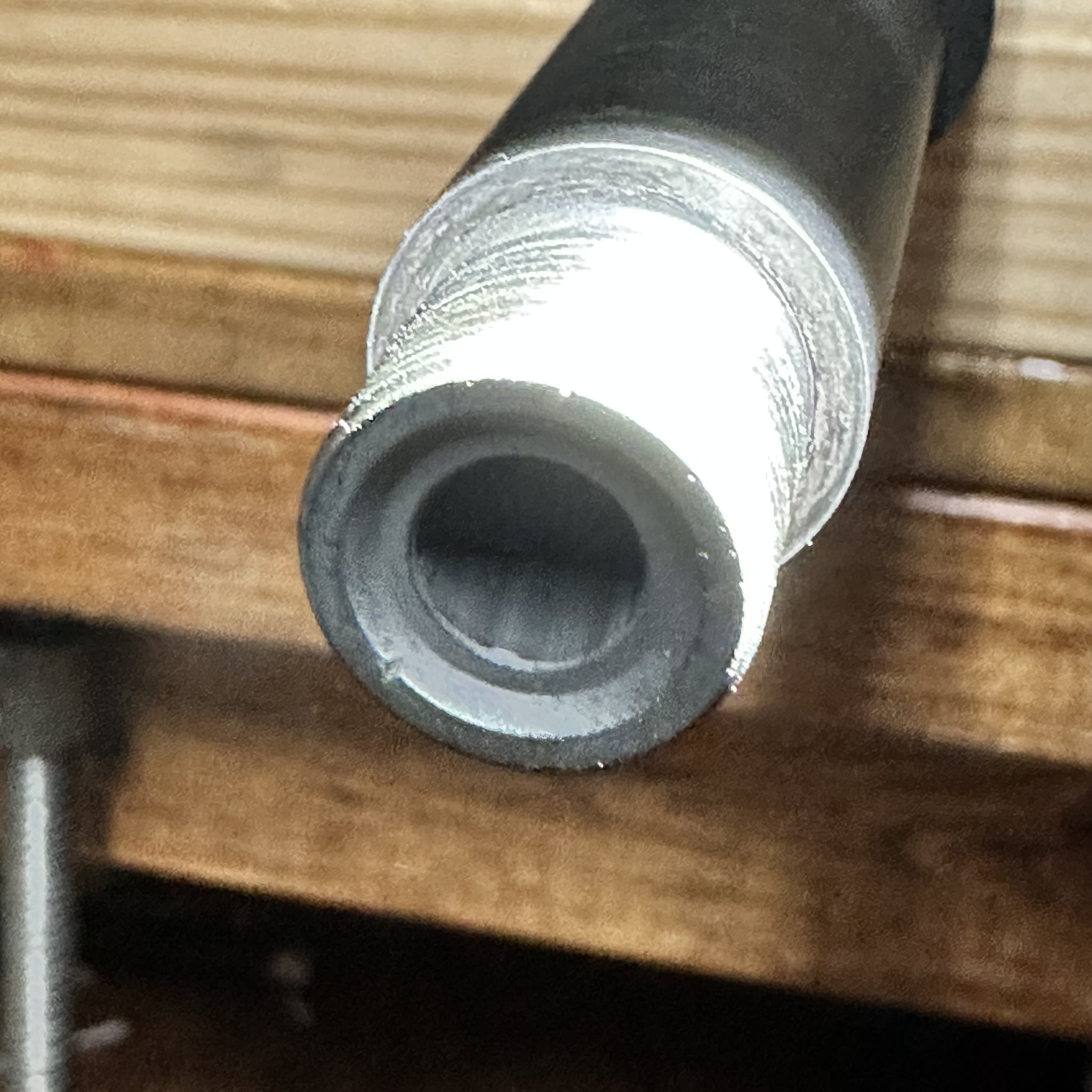

    Otherwise remove the stock and retorque the action screws and muzzle device. Also check crown for damage but highly doubt that’s the issue

    That was the initial 4 but i honestly hadn’t printed it on paper until the flash hider came off. Crown looks fine. Bedding looks fine. I’ll retorque it i guess. But the Norma hasn’t remotely grouped under a minute since which is why i was perplexed

    I’ve had the Surefire slip-over style muzzle devices on 3 bolt guns (2 brakes. 1 hider)
    Every single one caused me problems with either accuracy and consistency. Not sure if it’s the reduced profile it requires or carbon build up on the crown…they have done me no favors (though they look awesome)

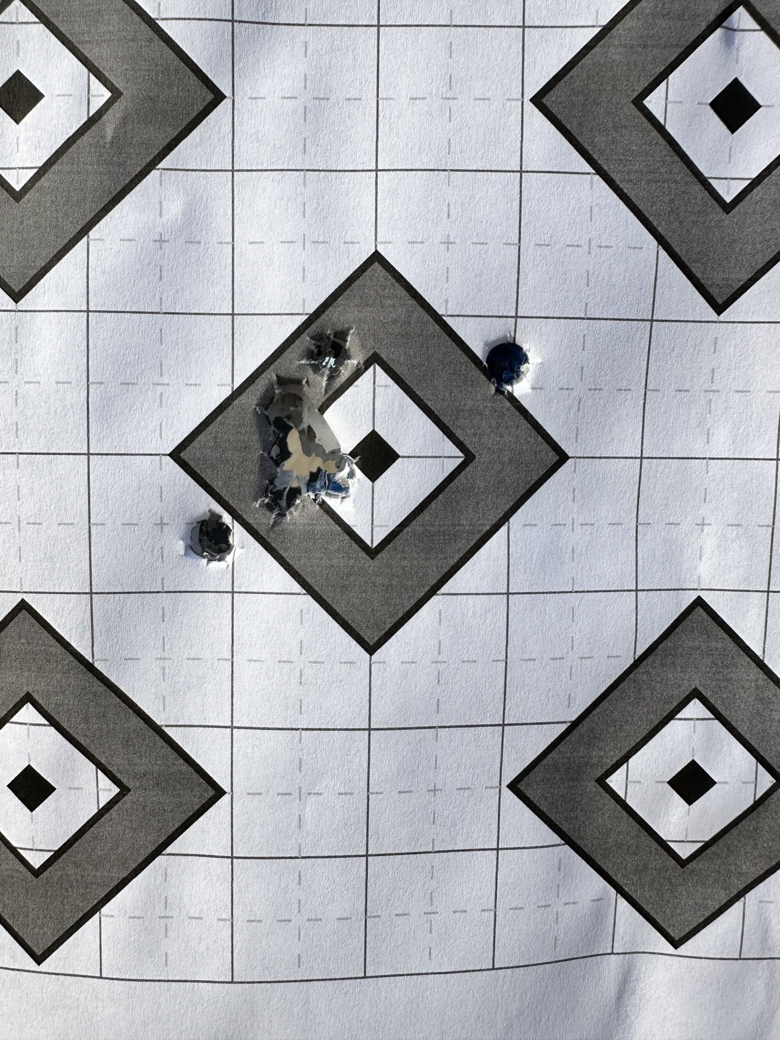

    I think I’ve narrowed it down to cheek weld of all things. Noticed when i relaxed normally. I’d have a little scope shadow on the right side of the image and am constantly readjusting, reticle moving left to right. So going fix my cheek weld and start over.
    8 shots with the Norma 175.

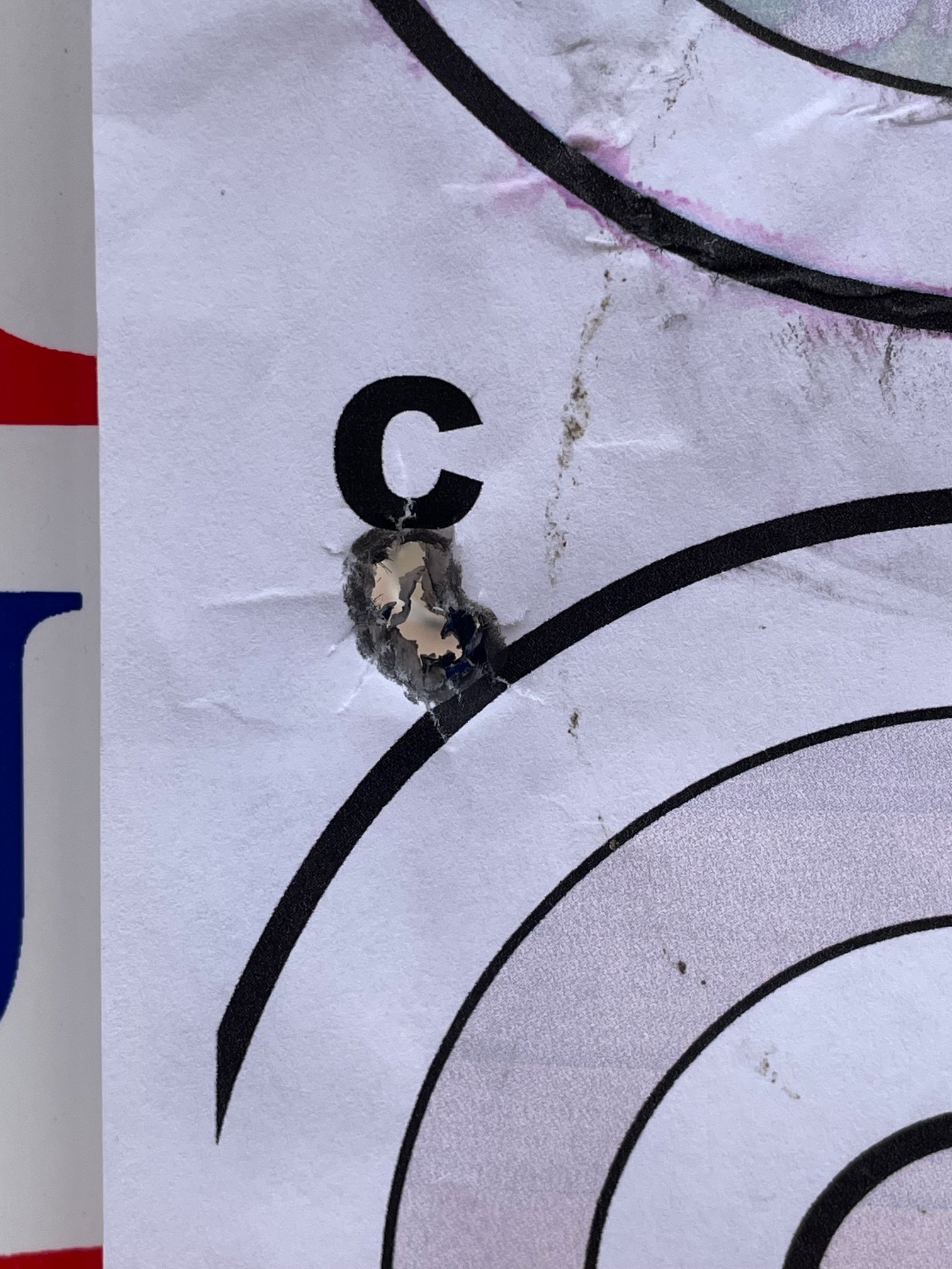

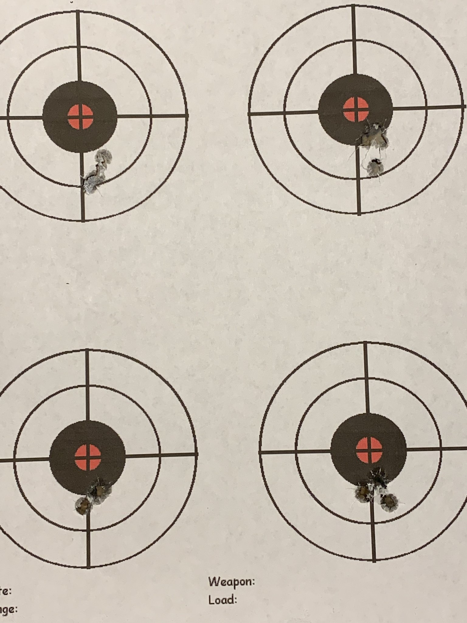

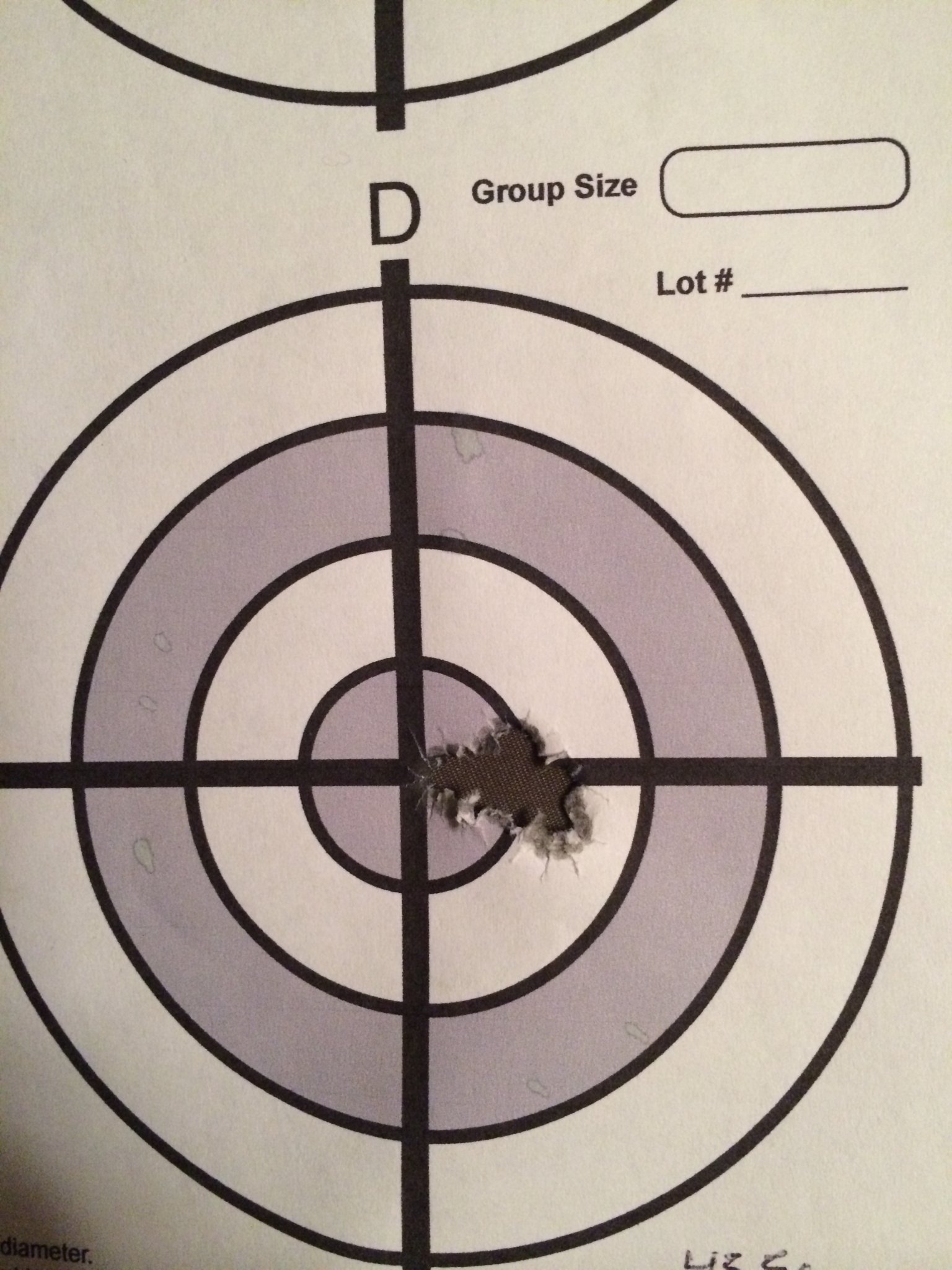

    I might just be in denial that it’s the rifle but i can’t help myself. Never had a custom perform so poorly especially in 308. Hence the attachments. Ranging from 6.5x47-7 Sherman short mag. Don’t get me wrong it’s depreciating. When i come back from a long absence it takes a while to get back into the swing of things. I’ve certainly don’t shoot like i used to cause i just don’t have the time due to residency. However i like to think my fundamentals are pretty sound.

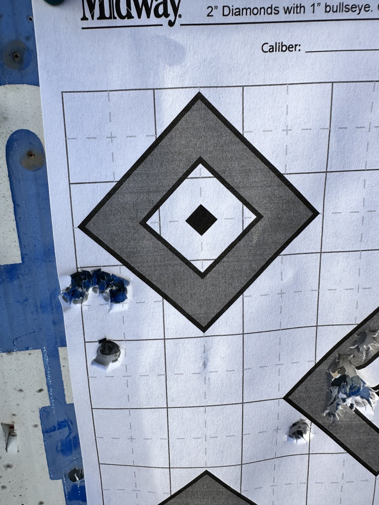

    So this was yesterday afternoon 10rd groups 168gr tmk loads on the top 175gr Norma golden target on the bottom.

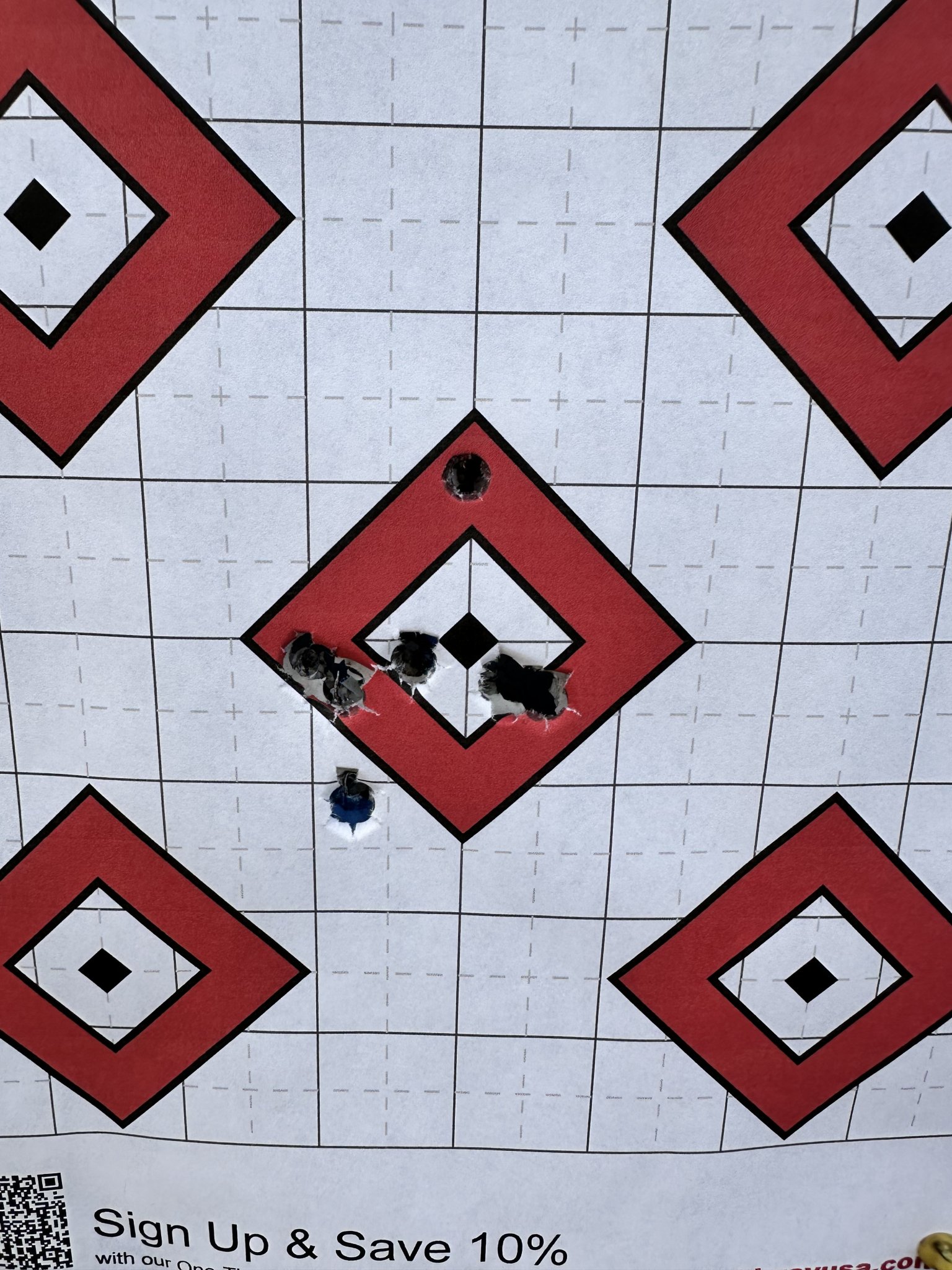

    This right now. 7 shots with the TBAC same 168gr tmk loads. DMS might be on to something and I’m just not at stable as i am with my heavy ass chassis guns. Cause outside of that initial flyer to the right, which was the first shot. It doesn’t look half bad
    Hmmmmmm
    You shot better groups in winter than now in summer

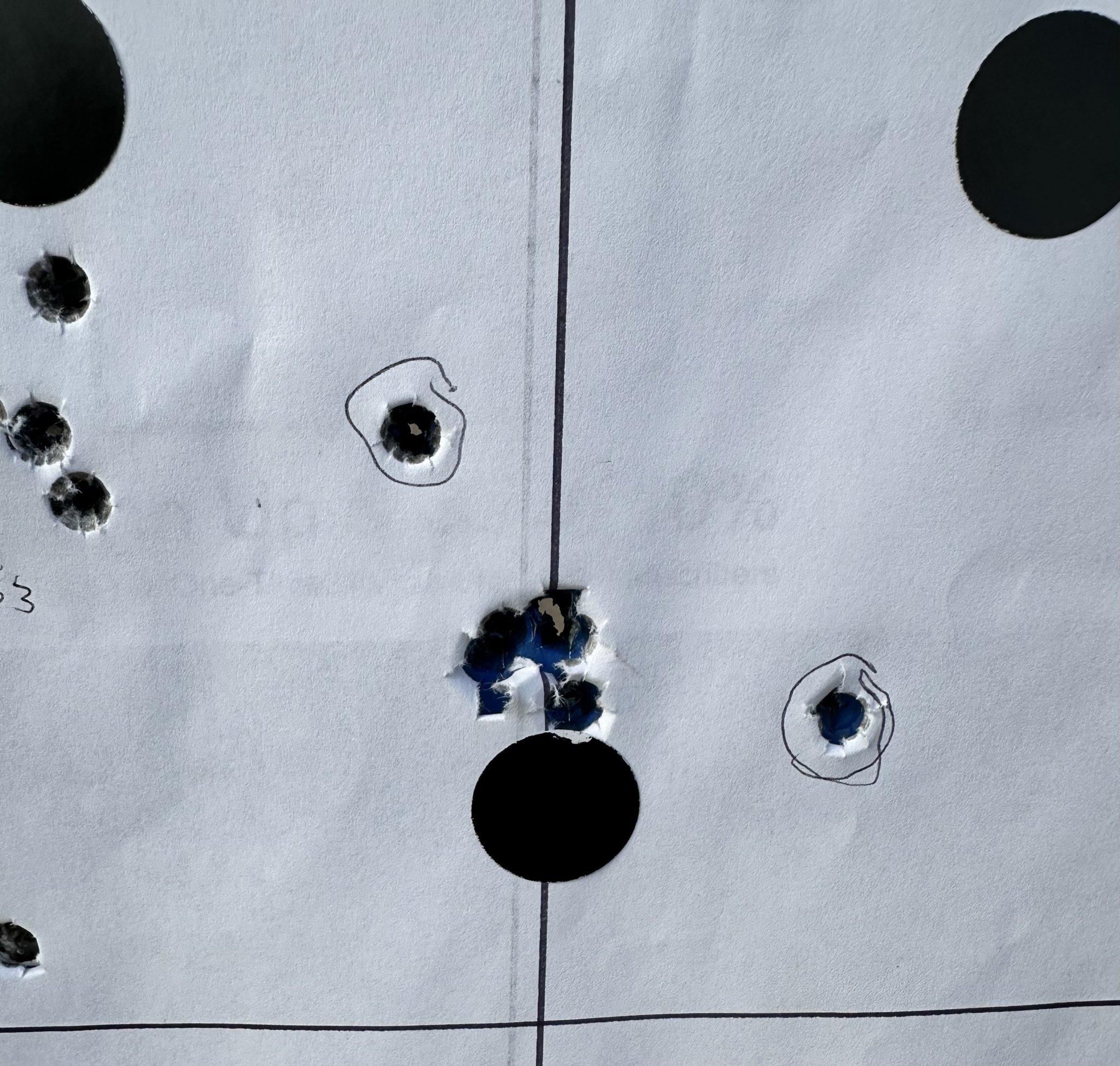

    Same TMK load
    So right now i think it’s a myriad of issues. Fitment being the biggest one that i don’t think i realized early on setting it up and running it quickly. Another would be my consistency. As i said it’s a depreciating skill and I’m not shooting as much as i used to. I’m still unsure on the difference between the surefire and TBAC

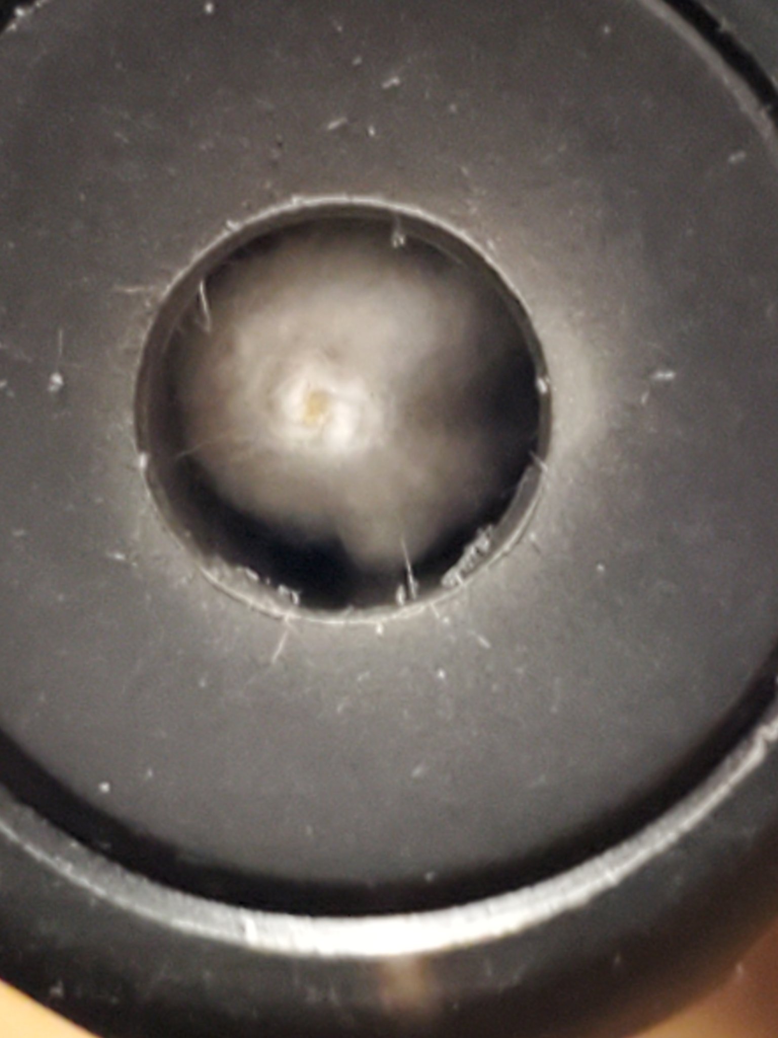

    If you run a patch down to the end you can get better look at the crown. Also using zoom instead trying to put the camera closer helps.

    Forgot to mention before the fiasco with the flash hider being removed this was 1000yds with the 175gr golden target. Which is currently looking better than my 100yd groups lmao

    Agreed haha. Parallax has been fine now that the rifle fits groups are looking much better. I put the surefire back on. I actually need to bring it to you Terry for the CMP installation.
    I really think it was a combination of fighting the gun and just being out of practice.
