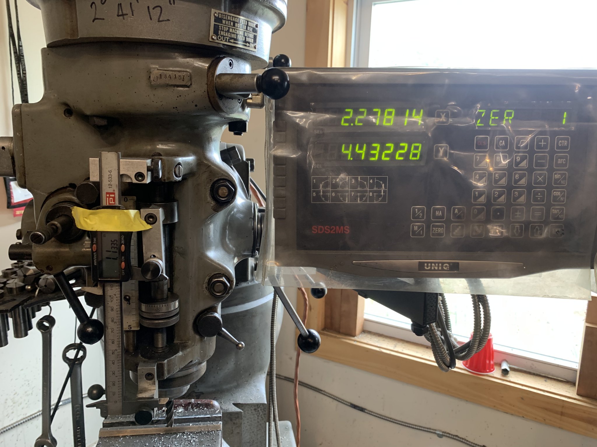

Suggestion to save yourself some $. Get a two axis dro for x and y. Buy a really good one. Then take an old vernier (we all have a few lying around) and mount it on the quill for your vertical z-axis. Kits to mount verniers are cheap and this lets you invest more in the best 2 axis dro while getting the 3axis readout you want.
Cheers, Sirhr
My dro. Pardon the tape on the vernier... it got moved to the mill when we lost the battery cover!
Cheers, Sirhr
Ben ta 3 kownty fairs, a goat ropin', even seen a bear tho a baseball wonct. But I ain't ever seen this. :)
I, as well, am looking toward a DRO for the mill and then, maybe someday, for the lathe. This idea had never entered my mind. Makes perfect sense, simple and elegant. Felt like someone just enlightened me that I could eat ice cream with a spoon. The depth stop can be used as a fine adjustment dial?
Possibly a knee mount as well.
Thank you much,
MrSmith
Thank you much,
MrSmith
Up here we call it "Old Famer Smart."
You still use the depth stop to set your depth as a Stop. But you can use it to control your cuts along with the vernier readout.
You can use your tool to touch off on the work and set the zero on the vernier. And there's your depth. Or touch off on the table and there is the height. Easiest $39.99 Z-axis DRO you ever did see.
Cheers,
Sirhr
