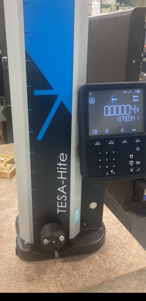

If your looking for a very tall unit with a wide range, we have one of these in our shop:
We added one of these in place of the "scriber"

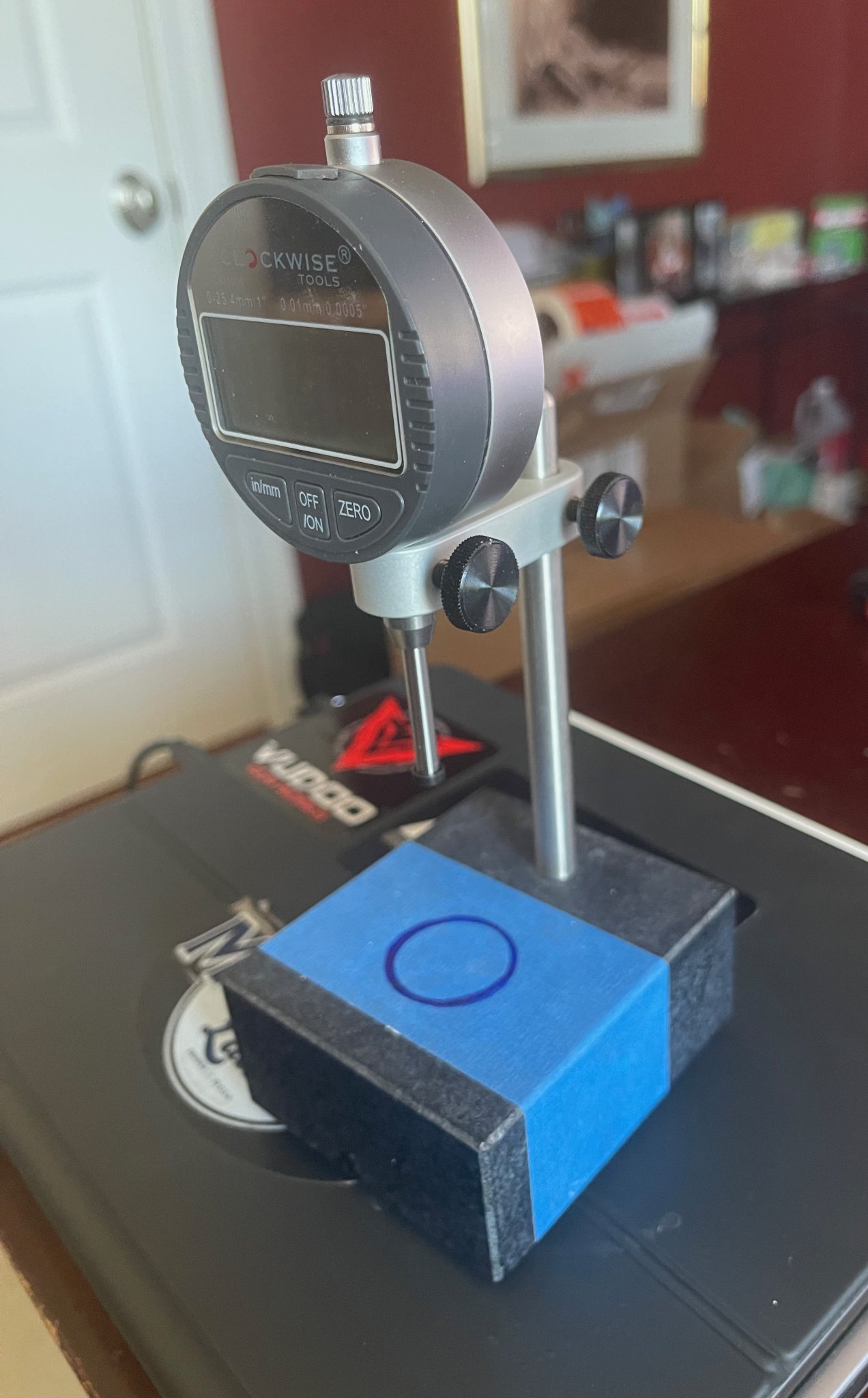

Summary so far, by order of magnitude cost...
$20 New post for existing sinclair base
$100 Small granite stand, china sourced
$1000 Pro grade granite stand, usa sourced
