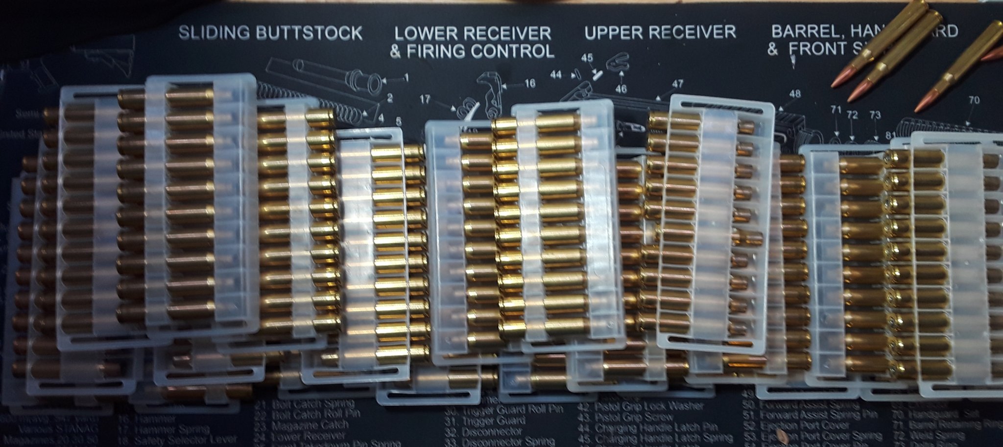

In 5 gallon sealed buckets (some seperated by headstamps) in a cool dry environment. Growing up was always taught to "save ALL your brass", so here I am...LoL.
Last week I took the time to start seperating out the brass. Was an endeavor in itself, but I did get some help from the boy. Took some of the brass and put into empty ammunition boxes (which I also save)...
Its not prepped yet, but its ready.
For example, sorted out about 600 rounds of 3006 federal gold metal match brass from Hornady match brass...and stuck them in empty holders...
