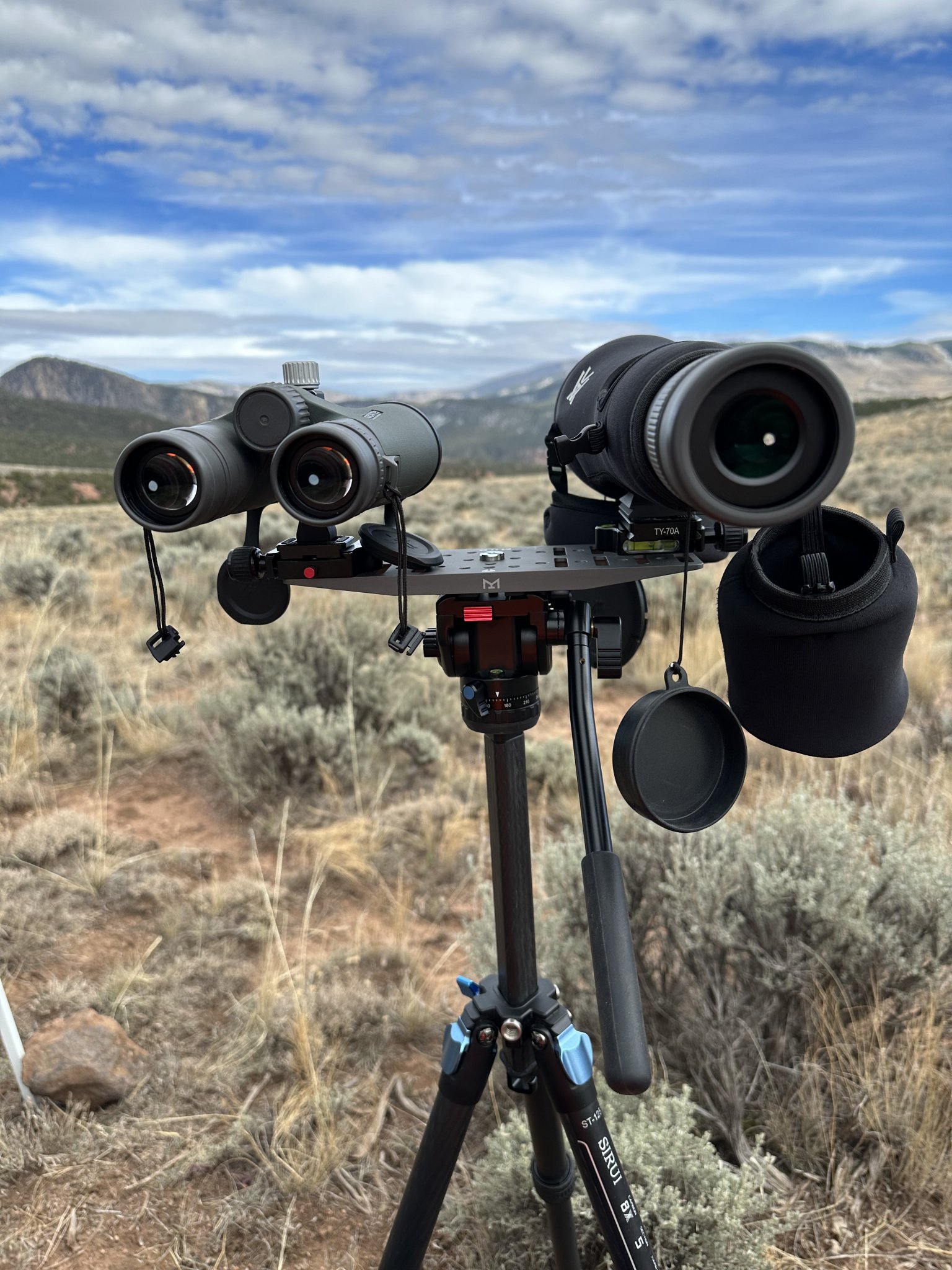

RPG I run this setup but with NL 10x and a BTX 85mm simultaneously on a MUB plate, and a UTA with a Siuri TY70 plate to add height to the binos to match the eye level with the BTXs. I will try to get pictures uploaded tomorrow. Here is the same setup with my old Razor HD bino/spotter setup.
I find this setup perfect for prolonged glassing sessions while scouting or hunting as the NL Pure & BTX combo are unbeatable. The Razor spotter is a solid scope, but now it just gets used at the range.

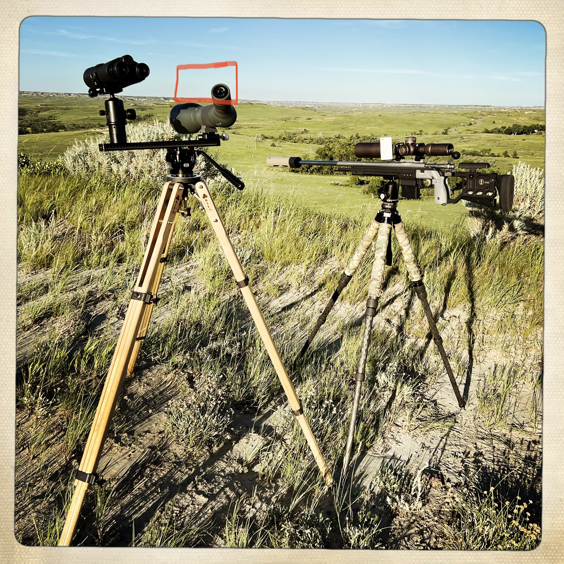

I have a regular angled spotter that I co-witness with 15x Leica LRF binos, but it’s rotated in its mount as the setup is for video through the spotter. The red outline on the pic shows how my phone would mount as I was using my phone for the pic.
One barely has to move your head to either look through the binos or look at the iPhone connected to the spotter.
The two thick disks I used to raise the binos are from Wimberley. I would imagine you’d need a ton of those to get your binos high enough and then it’d get unstable.
