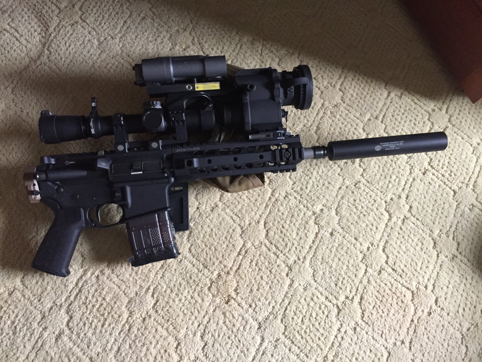

    I run a 10.5” SBR suppressed with a Crux Ark 30 can and an adjustable GB. She runs really well and have run her hard in a 2 day class without any malfunctions. I have also had her out to 300 yards during the class on silhouette plates with a T2 and Wolf Gold ammo and made consistent hits.

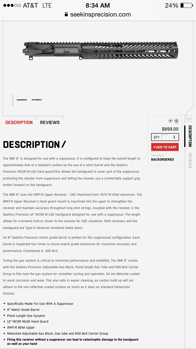

    If you can afford the ammo and like short barrels: 300 AAC Blackout is my recommendation . 30 cal. AK-like ballistics in supersonic and whisper quiet subsonic suppressed.
    An 8" & 9" 300 BO became my solutions. I started with a 9" AAC upper (with non-adjustable GB). It runs GREAT with both supersonic (with or without suppressor) and subsonic (with suppressor) loads.
    Then I built a 300 BO to use as a non-ATF "trunk-gun" with the same characteristics (but without a stock). So, I took an LMT upper, Wilson Combat 8" barrel (also with non-adjustable GB), some really good mil-spec parts and attached a Shockwave brace on a new stripped lower. Now I can legally cross state lines with my "Pistol" and don't need to file any ATF paperwork. It runs GREAT as above.
    I prefer not to use an adjustable GBs because they have been known to create their own cleaning/sticking issues. K.I.S.S. is my moto. Both 300s run great both supersonic (with or without a can), and subsonic (only with a can), using heavier buffer and spring combo. Nothing to tune, adjust or clog.
    BTW, I don't see any real purpose running subsonic without a can. Shooting supersonic loads through the suppressor does cause more gas blowback however, but that’s a trade off I’m willing to deal with to K.I.S. So, I don’t often use the suppressor when the use of supersonic loads is indicated. But if silent running is the goal, subsonic rounds through a can work very nicely. Different situations call for different solutions and the short 300 BO can fill widely different roles.
