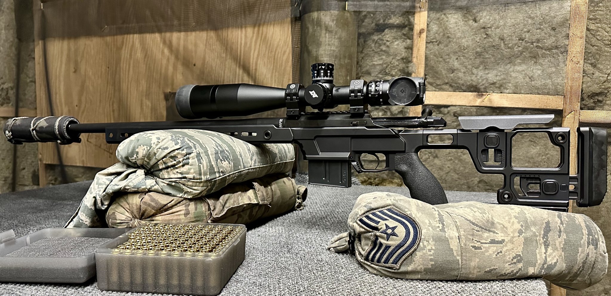

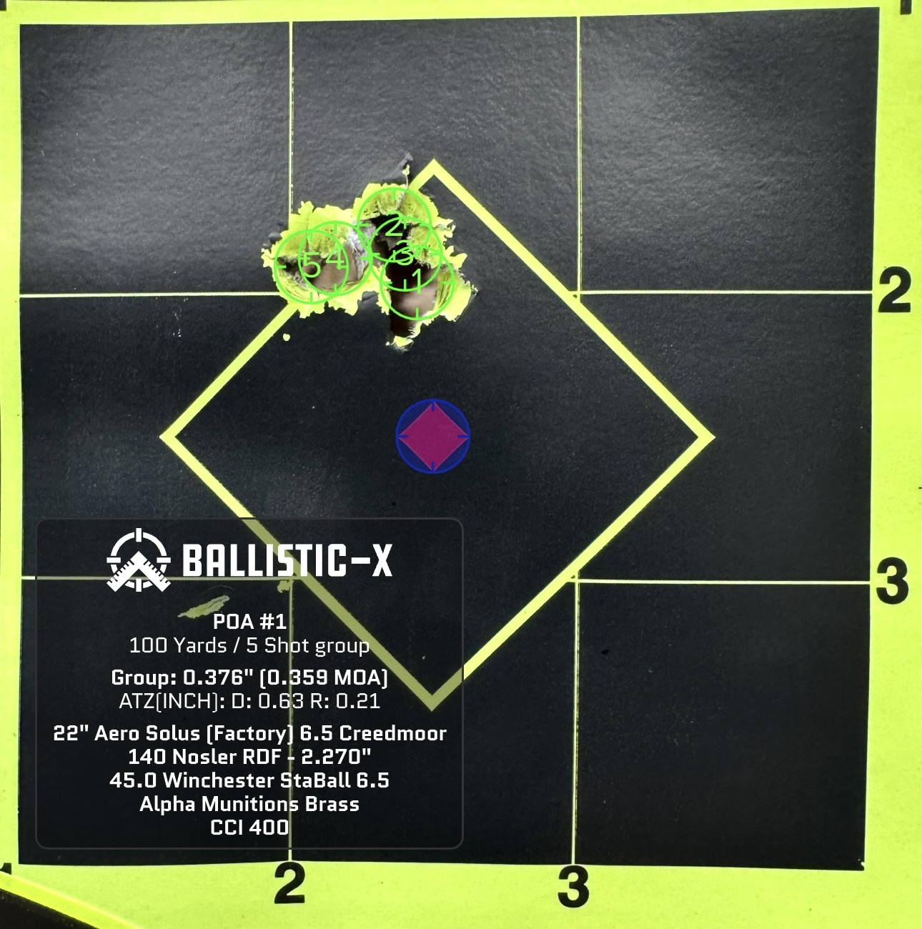

This is the best option... And Classic Firearms has 1 left for $1899...
Mine shoots extremely well with handloads...

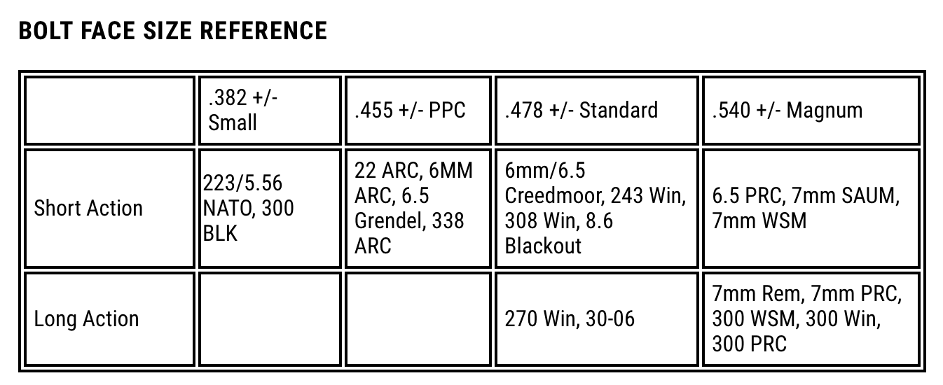

Contact MDT and ask them if the Howa in the Oryx can use all brands of AICS magazines, for some reason I thought it could only use MDT AICS.

The Howa, in a chassis, will use AICS detachable magazines.
The Aero is a Remington 700 footprint, can use AICS or AW magazines, and barrel changing will be easier as it uses pre-fit barrels whereas the Howa will have to re-barreled by a gunsmith. Also, as someone above said, the Howa will have less aftermarket support than the Aero Solus so it depends what your priorities are.
Clear as mud?

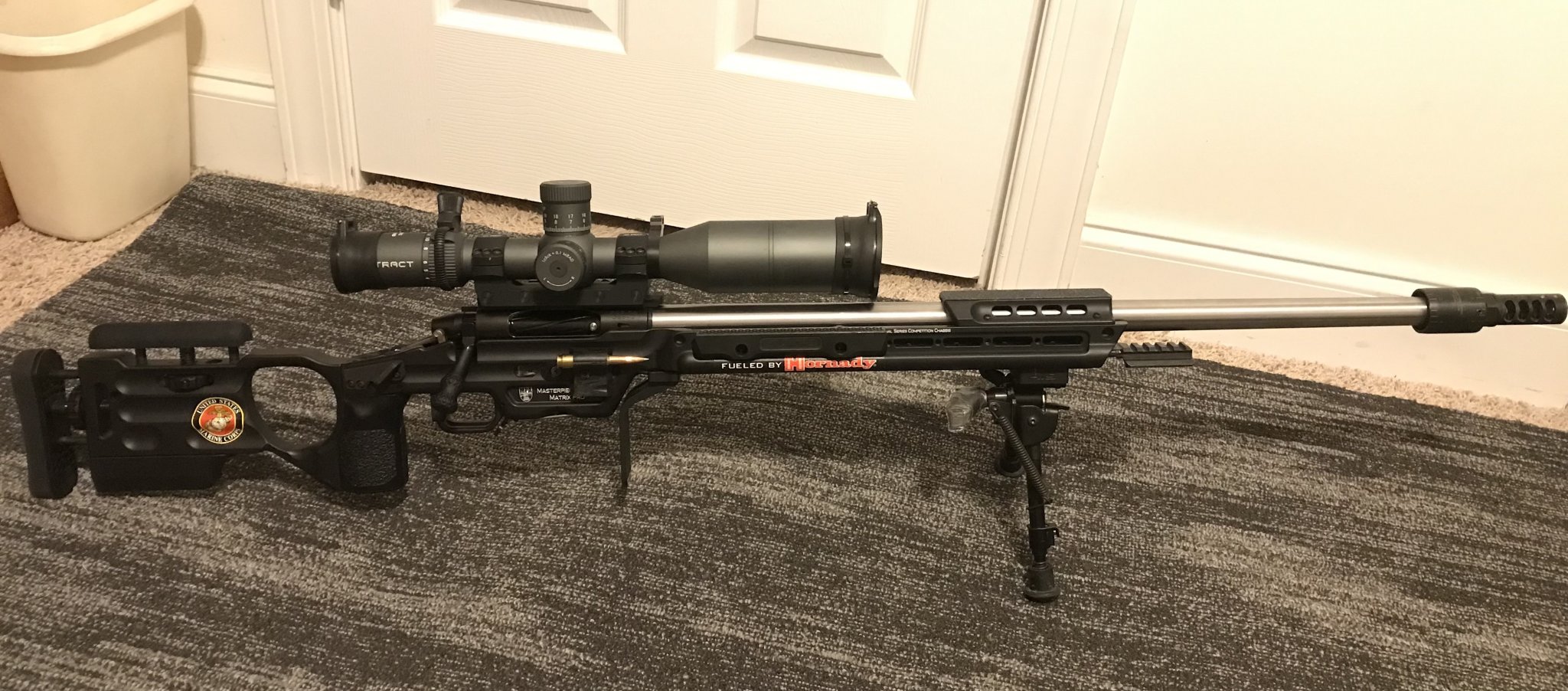

May seem bizarre to you but not to anyone who shots long range rifles. My Creedmoor has a 28” barrel on it. It’s free velocity with no downside. You are not clearing rooms with these rifles. You are reaching out to long range.
I have multiple Osprey barrels and have another Creedmoor on order now. Having had and have many Bartleins and other brands I can say the Ospreys are right there with them for accuracy. And I agree to pass on the cerakote as you will shoot the barrel out and a swap it.
Here is my 28” barreled Creedmoor so you can see what they look like being longer.
