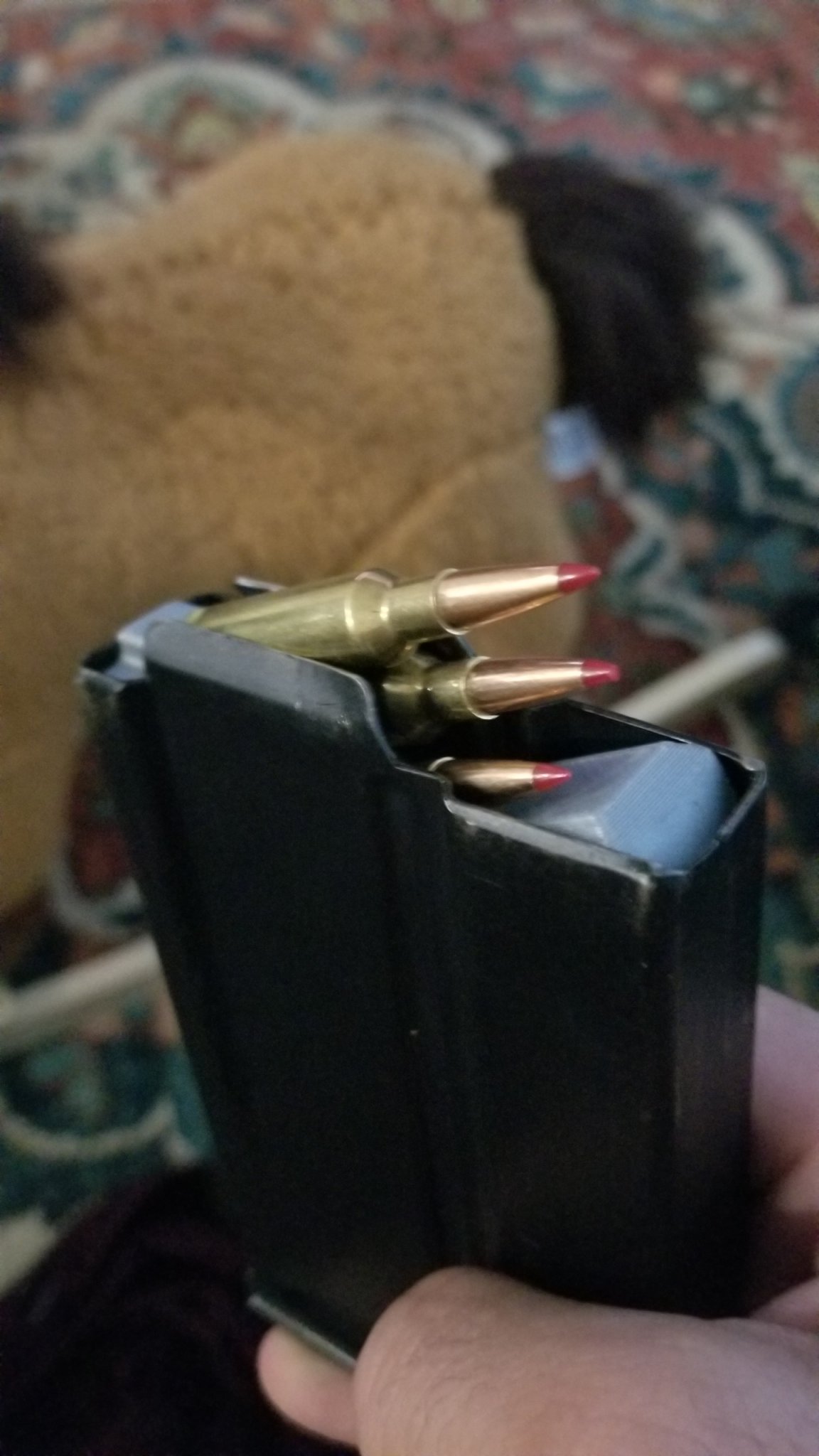

    I have a match tomorrow and would like to run my Valkyrie. I'm trying to adjust the feed lips on my AICS mag with primal rights kit but seems like no matter how I adjust the nose of the follower stays up and only the rear slides down into the mag as pictured. Any suggestions?
    on the bottom of the follower, how is the spring attached?
    if it's not rivets, and is a screw - you can loosen the screw and move the spring forward/back depending which way the follow keeps tilting.
    so move the spring back toward the back of the magazine and it should put more pressure on the back of the follower.
    try that
    edit: it's a primal rights kit - so it should have the screw
    try that
    First method worked. Thanks, I'm new to this and wouldn't have ever even considered that.
