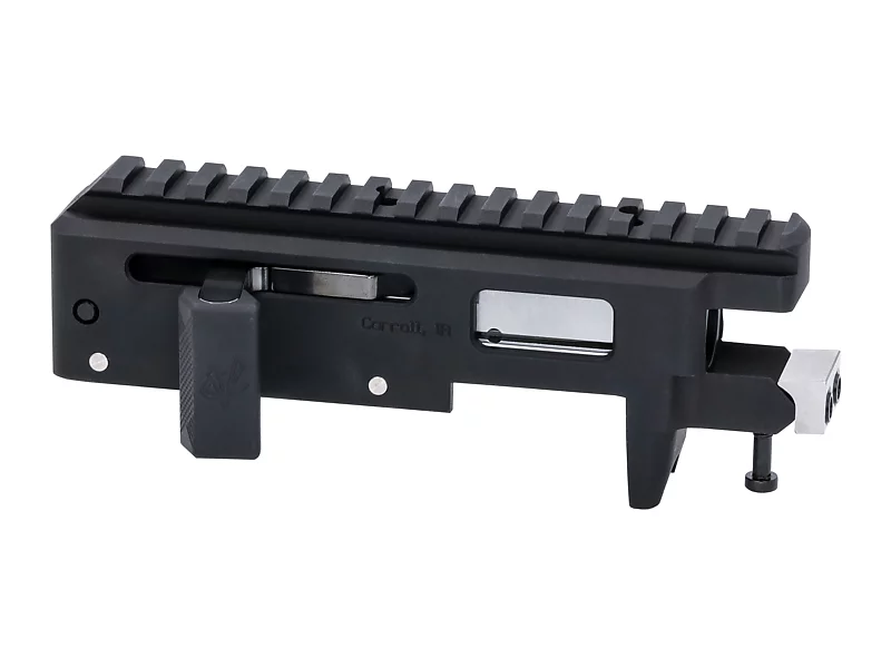

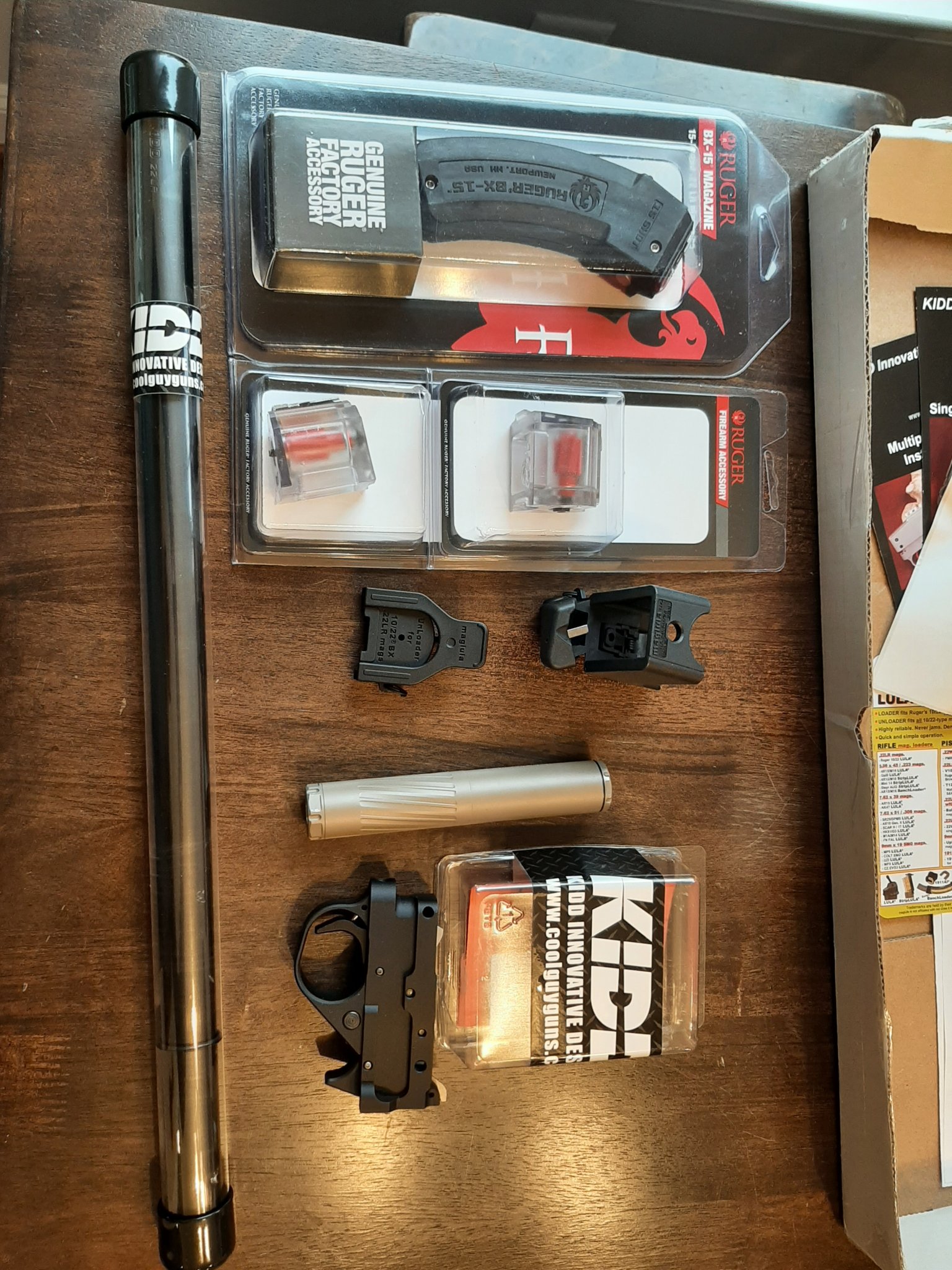

    Welp, been looking at the Summit action for about 4 or 5 years now but been to busy running regular PRS matches. Decided this year is the year and I needed a 22lr. Since I have a mental illness and didn't want to just hit the easy button with a vudoo, nows the time to try the Summit. While I'm not traveling states chasing a season trophy I hate to lose so this will possibly be a long journey to make it work enough to start winning matches. Follow along.... don't, whatever but this will be a spot for a serious Summit build since there is hardly anything on someone doing one. Might be a reason but we'll find out.
    Parts list:
    -Volquartsen Summit action black
    -Kidd single stage trigger
    -Kidd 20" match heavy barrel threaded
    -KRG Bravo w/ some fixins
    -Tbac 22 suppressor
    I prefer to use the suppressor but I'm not going to force it if it starts going sideways.
    Scope: I'll end up borrowing one from another gun until I decide what I want. Top contenders are a Athlon Midas Tac and a Bushnell DMR3.
    First batch of parts showed up today with the stock due Saturday and action due Monday.

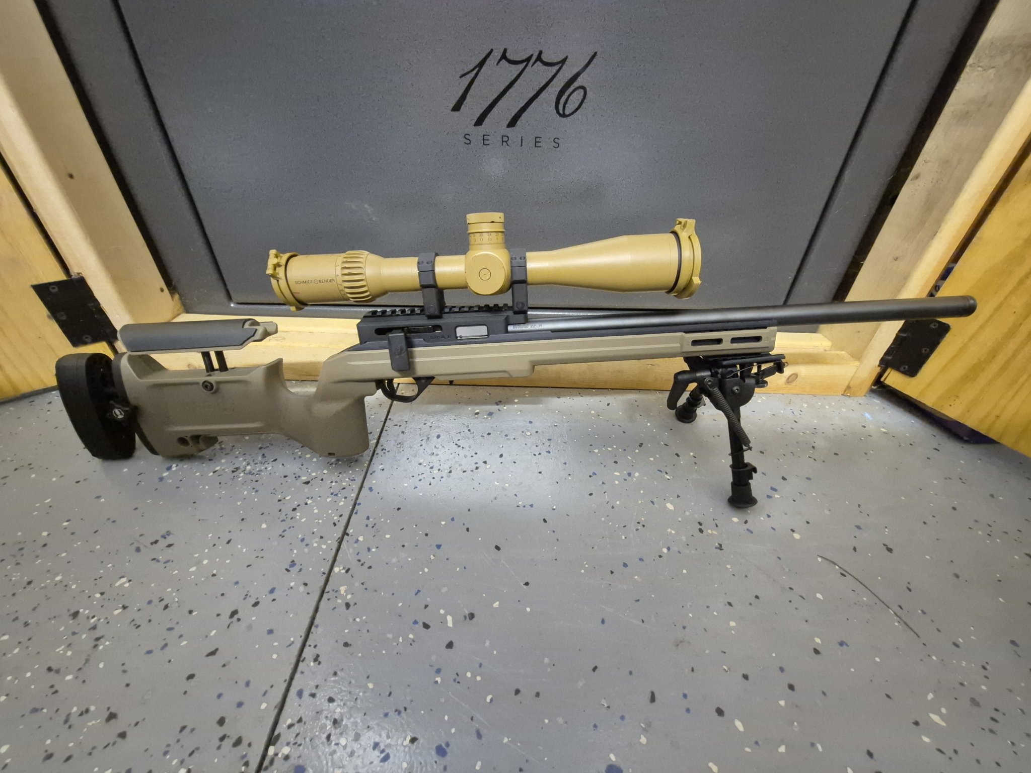

    This is my summit build i had then sold it, I will be rebuilding again.
    Volquartsen Summit 18” if possible
    Kidd Trigger w/ upgrades
    Kidd Magazine Latch Plunger SS
    Victor Company stock w/ cheek riser
    Victor Company Titan22 Spike
    Atlas-BT65

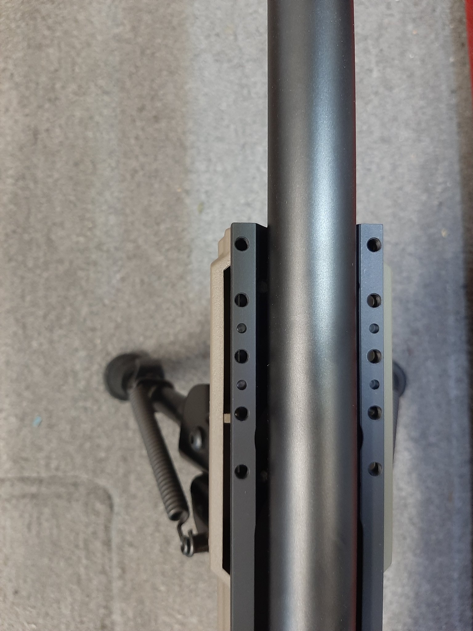

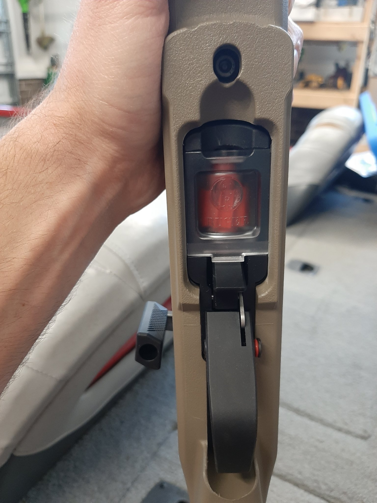

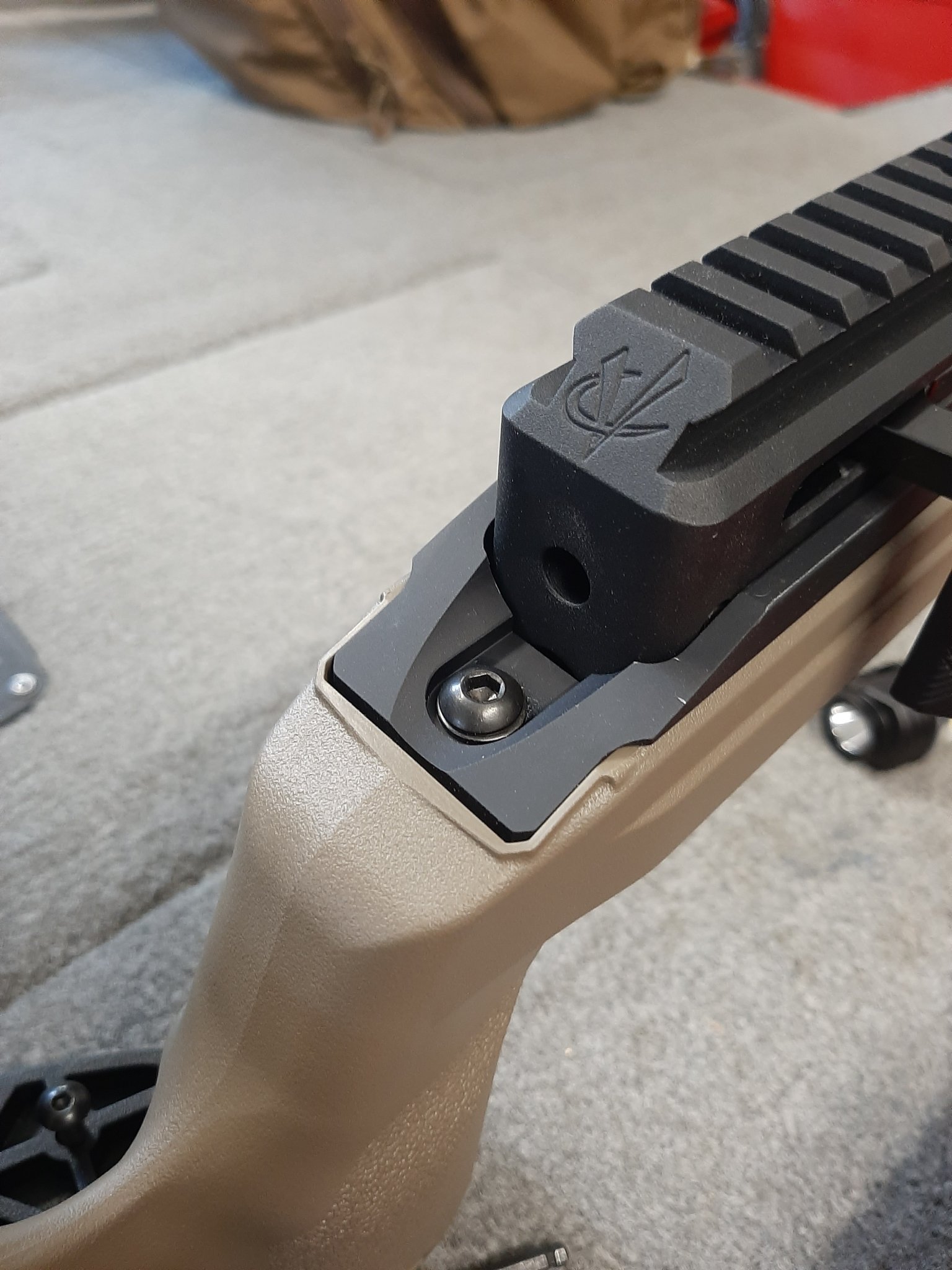

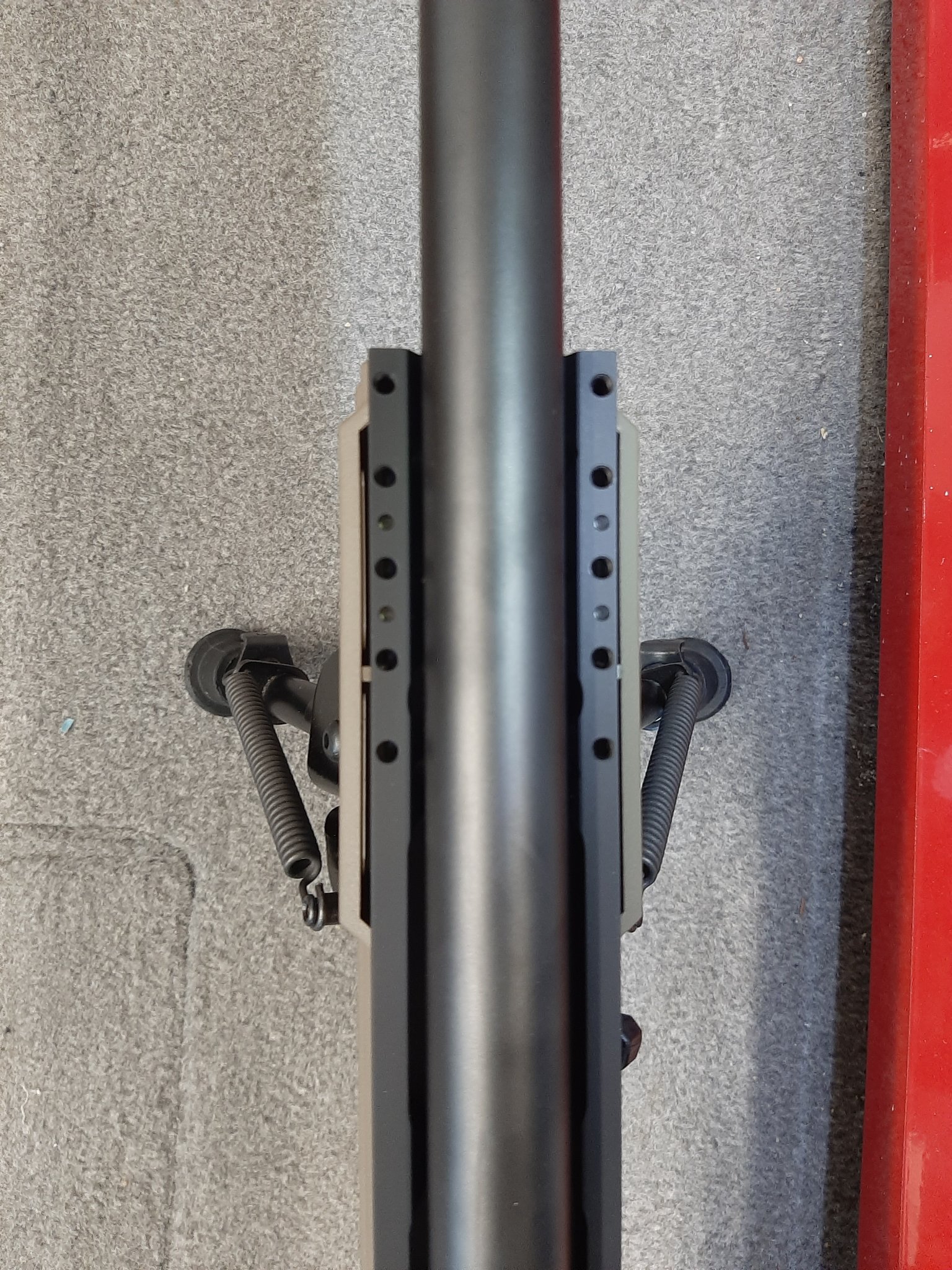

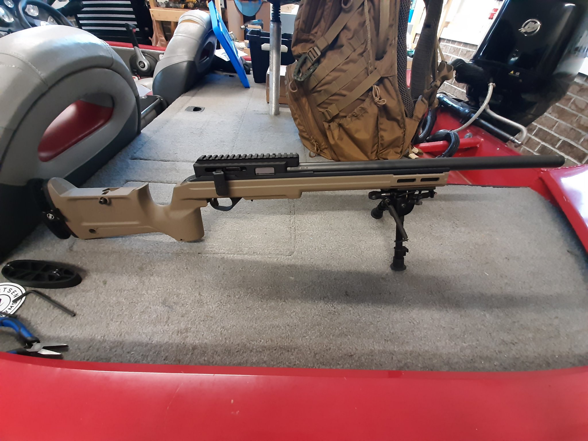

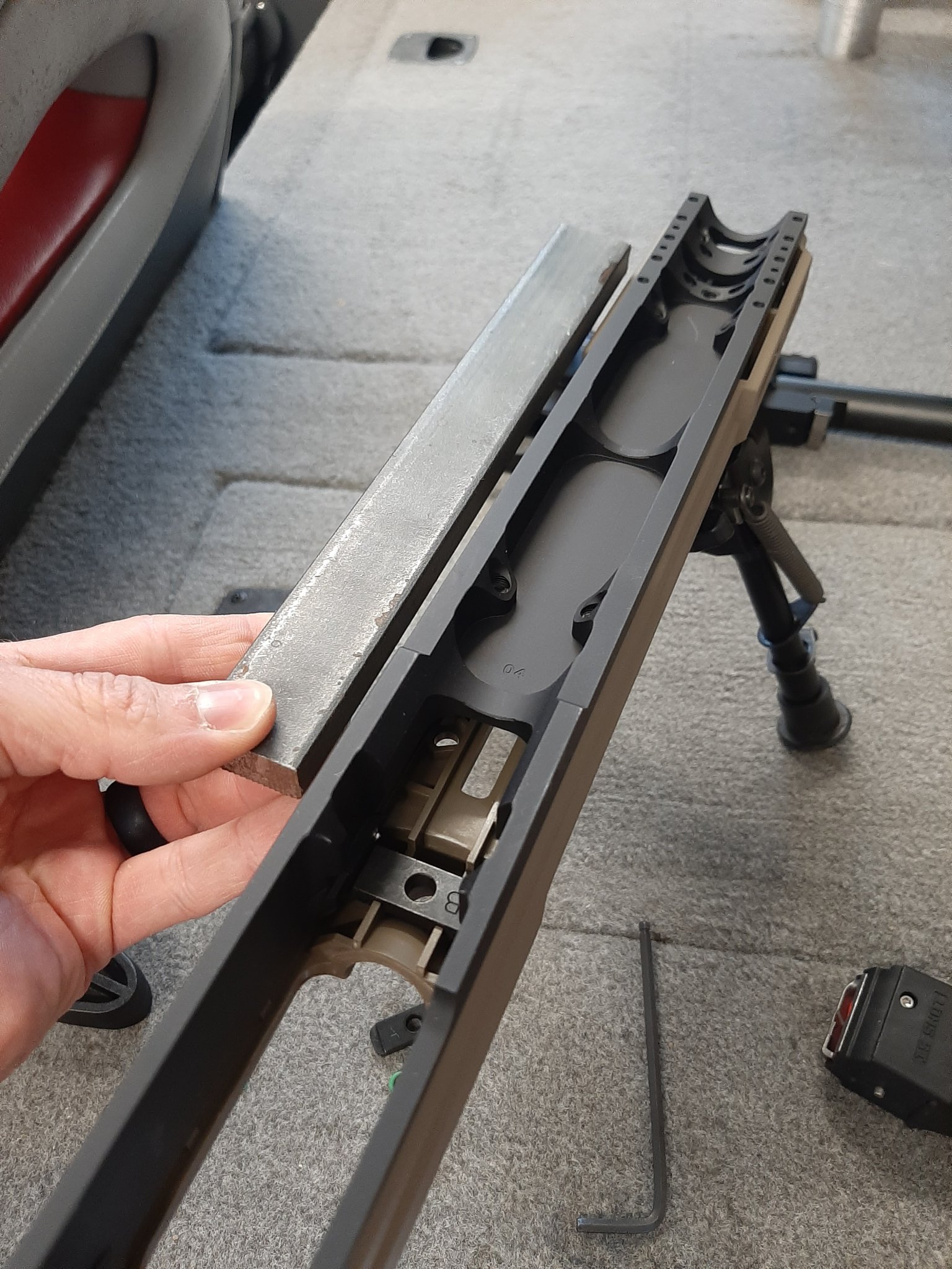

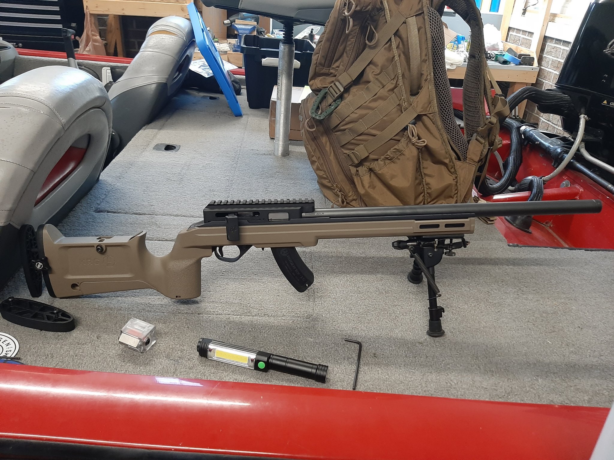

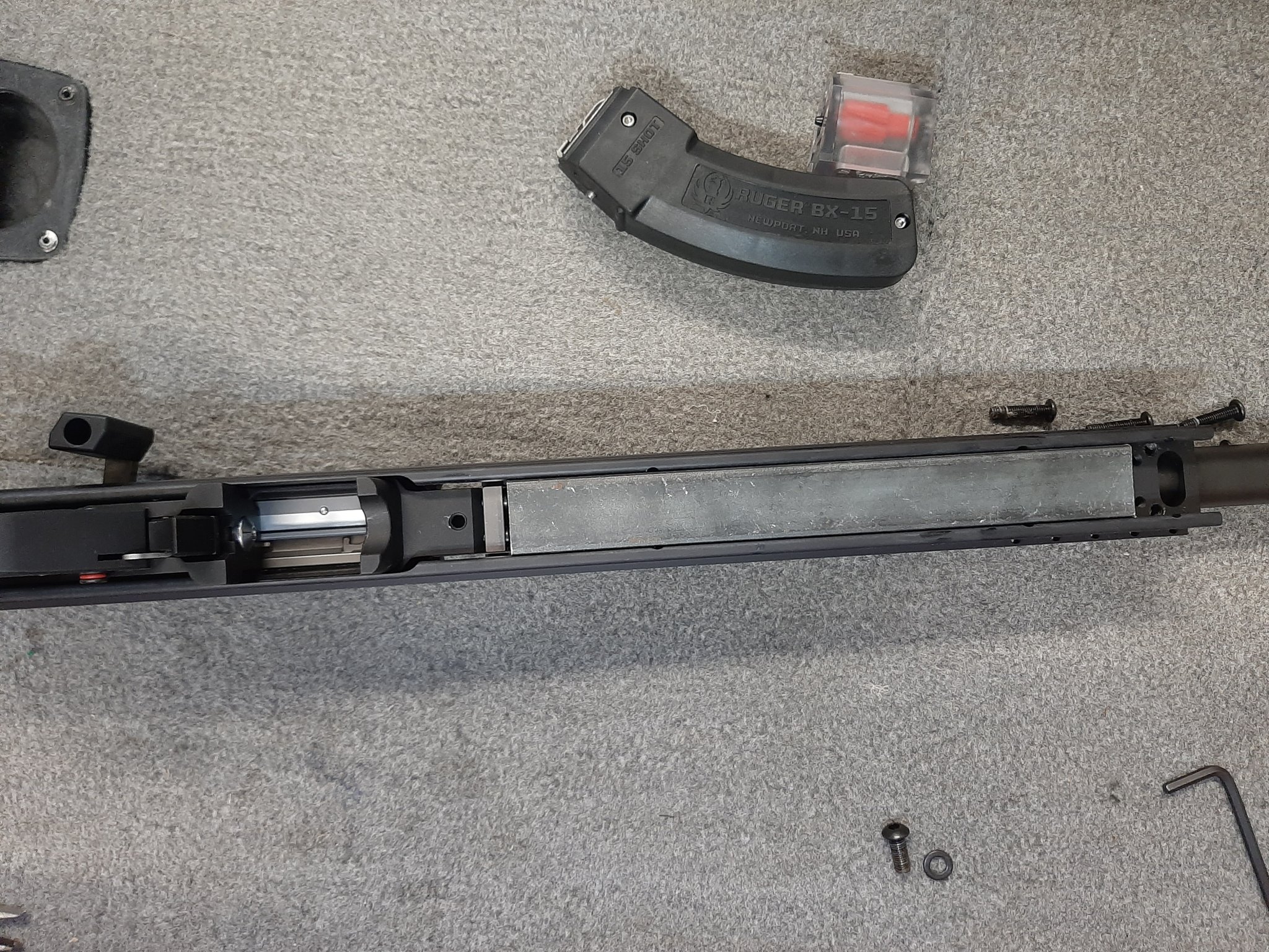

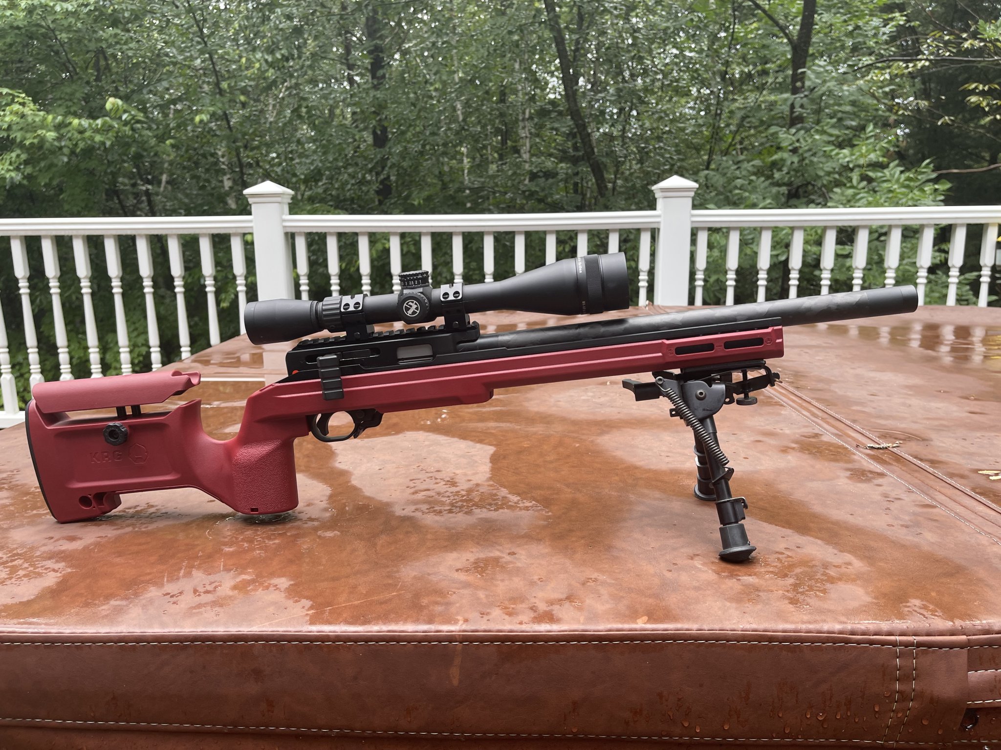

    Ok. Here are your pics. It may end up in 2 posts, well see how far I get.
    Gun with the 2 types of mags. I had to slightly sand the sides of the mag well on the krg skins to get the clear mags to drop freely. Supposedly the mags are slightly larger than the black ones but I didn't want to mess with the mags.
    Rigidity issues. Straight and then a tap on the barrel and were crooked.
    Rear tang spot
    This 1"x.5" bar fits near perfectly between the metal backbone and krg skin. The second pic shows the backbone removed and upside down sitting in the channel. If I run it far back enough and mil part of the height I can use it as the front mounting point and have the action completely bolted to the metal backbone and not reliant on plastic.

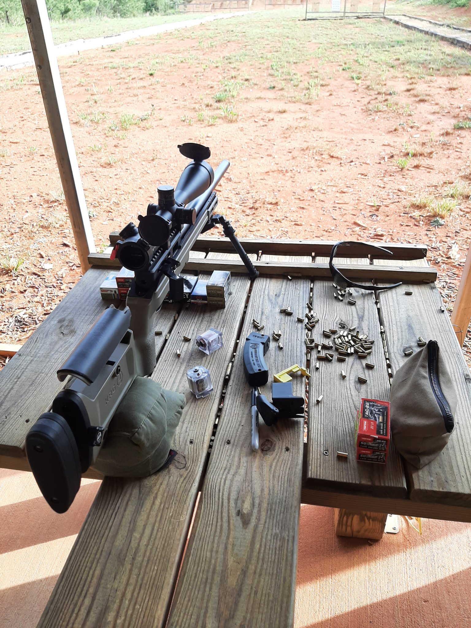

    Ok, since weather wants to be bipolar and screw my fishing plans I went out to get a base for the Summit. Had to scramble together a scope setup, ideally I'll mount something lower but it looks like the mag ring will be my limiting factor based on where I need the scope and action design. PST Gen 1 6-24 for anyone curious. I decided to go without the suppressor for now until I start getting the accuracy I need and then I'll slap it on and select an ammo with it.
    So far, the cheapest ammo, Aguila Super Extra shot the best at about 1/2". All groups are 10 shot and 10 rounds of each ammo was burned before recording a group to get the lubes settled. I believe a few of these (CCI SV, Eley Match 1068) could do better since most of their dispersion is horizontal and it was a tad bit gusty. I didn't play with action screw torque or barrel shims, etc. This was purely to get a base line. The action broke in a bit and I think I can take .001 to .002 barrel shims out and get a bit more engagement on the driving band which should help. It did run flawless though, not a single FTF, FTE or FTL through all the different bullet types and all 3 mags. Not super great performance yet but I think it's capable with some work.
    The tenex I was surprised at. First 4 or 5 went into a 1/4" group and then fell apart.

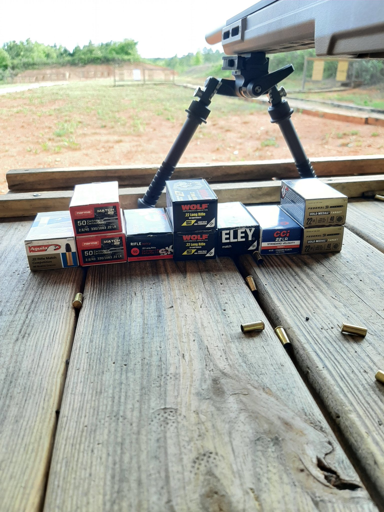

    Update 2.
    I took .002" of barrel shims off to tighten up the toggle lock. Tried a few more ammo types and retested a few. Similar procedure, 10 shots to get lube settled and then this time I did 2 5rd groups. CCI SV was just over 1/2" and the second group was 1". Everything else was 1" or more.
    Cci SV (retested, newly bought)
    Aguila Super Extra (retest)
    Norma Tac Match
    Norma tac22
    Federal gold medal target
    That makes 10 different types of ammo ranging from $4 a box to whatever Tenex is going for now...$25? I've emailed Kidd to see what their suggestion is or if I can just return it. There is a kreiger .9" Dia barrel in the px now I may pick up to spin up for this.
    When I adjusted the barrel shims I also took all my brands off ammo and dropped them into the chamber and I could get them all the way in without hitting the lands/rifling. So I'm getting zero pre engagement. Not sure if kidd designs their chamber this way or someone went a few thousands too far with the reamer. Most 10/22 barrels advertise bentz chambers but kidd was supposed to have a more proprietary design that was a bit tighter than a bentz. From everything I understand some engagement is just about required for 22lr accuracy.

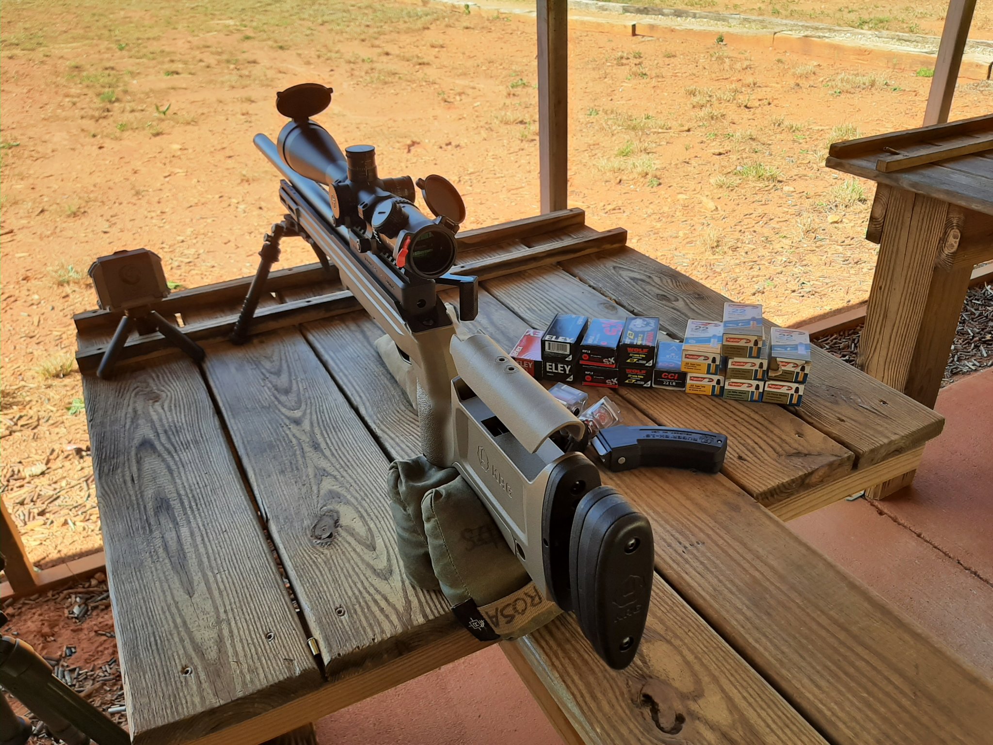

    Got out today to test the new barrel. We've made progress. I'm not satisfied but I feel like we are no longer having barrel issues and this thing just needs to get some rigidity to it. Gotta talk to LRI and see if they are willing to put the Kidd tang on this thing and then I'll do the front part with my steel bar.
    Seems like the Eley primed ammo did the best overall. Wolf MT, Eley Match were the stars with honorable mention by Norma Match22. While the Eley didn't do fantastic I feel like a few more rounds to season the barrel and it would settle in well. It's also old as dirt, this Eley ammo was back when I had my 40x about 5 or 6 years ago, a fresher batch may do better still.
    I really need to pick up some lapua and see how it does...
    You can zoom in on the target pic for group size and velocity/es/SD. At least the numbers correlated with group size... gives me hope. Same procedure, burn 10 to season the barrel and then (2) 5rd groups of each ammo.
    Got dope on the WolfMT out to 400 and I think I'll hit a match with it on May 4th. I'll need a better scope or a mount with can't built in. I only have 14 mils of available travel and I have to hold 6 mils to hit 400. I don't expect to do exceptionally well but it will be a good shake down.

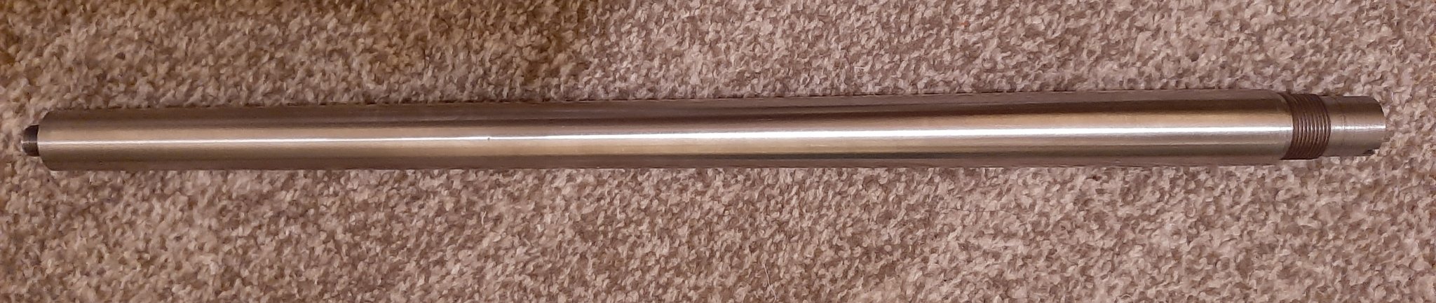

    Alright folks. At my parents and went digging.
    Found my old Shillen Ratchet barrel for my 40x. It was a short lived build and has maybe 200 rounds on it. Tenon end measures 1" and muzzle is .905". I'm going to turn the rear part down just enough to clear the action (maybe .920-950?), trim the chamber to get rid of the extractor cuts and try the ravage reamer used in the original (and maybe current?) Vudoo rifles. After trimming the chamber it is 20.8" to the tip of the barrel threads. Even if I chop off the threads well be just about 20" once I clear the backbore.

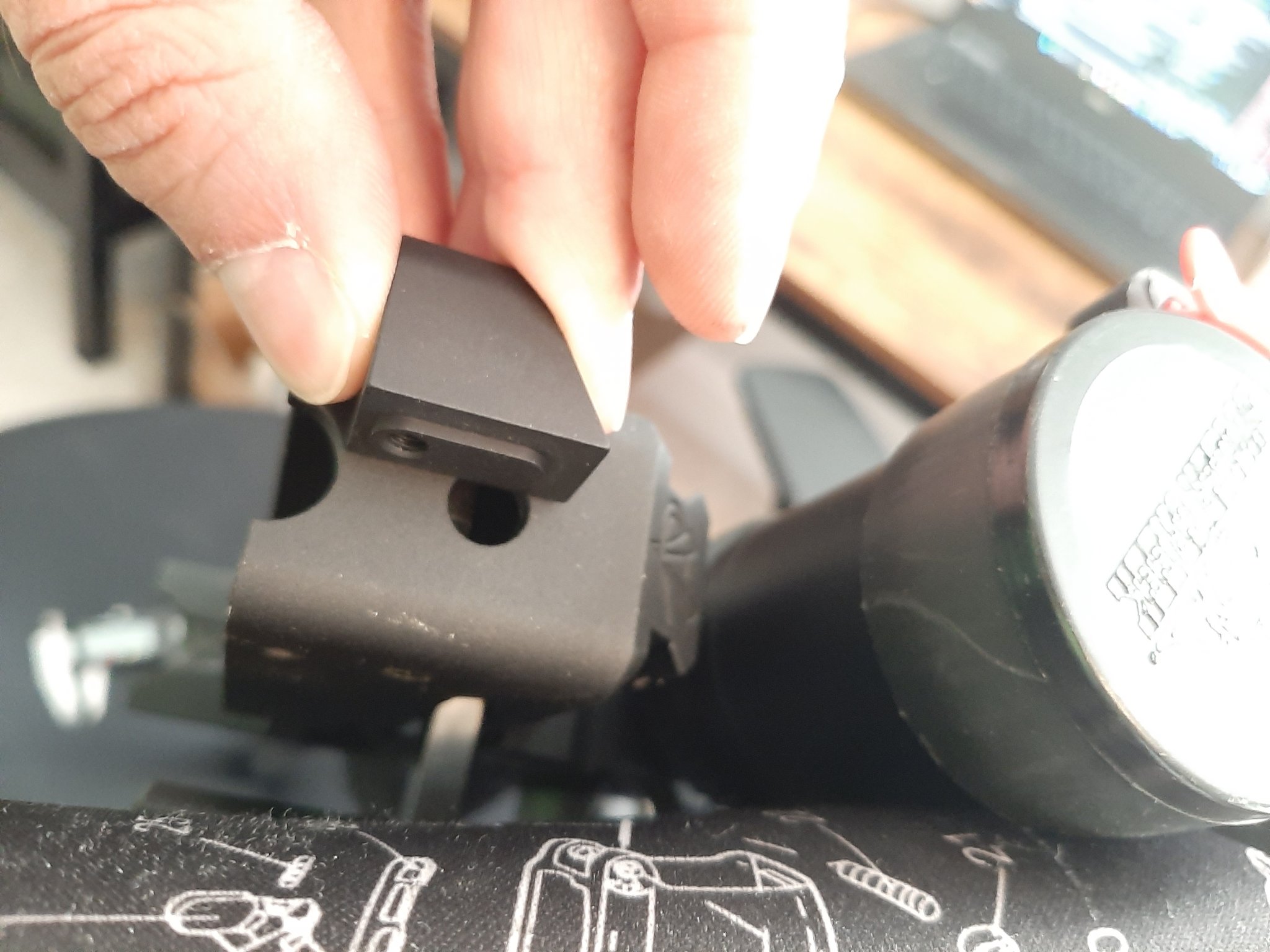

    Ok, couple of things, mostly thoughts.
    1) I received the Kidd tang kit (from order to door was 3 days, incredible service) and as mentioned LRI said they could figure it out based on how simple it sounded. Didnt sound like they have done one before, but its LRI and I'd trust them with just about anything. I dont think I'm going to use the kit though looking at the back of the action and the tang kit. (see pics below) Over half of the tang part that will "lock" into a groove milled into the receiver will be unsupported in the hole in the receiver made for easy cleaning. I dont believe this is going to give a nice solid mount tab like its intended. I think I'm going to grab a small block of aluminum and make my own. I'll throw it on my lathe first and turn a small circular nub that fits right into the cleaning hole and use a button head screw to secure it. There is enough free space on the inside of the receiver I dont have to counter sink and a low profile button head is fine. To keep it from just spinning I'm going to drill a small hole below the cleaning hole and press a pin into my home made tang as a locating pin. I'll do some cutting and grinding from there to shape the rest of it and then bed it into the pocket on the stock. Clean, least invasive to the action and i still fully retain the use of the cleaning hole with removal of one screw.
    2) There are two machine shops local to me, I'm going to draw up a simple sketch and bring them my steel bar and have them properly mill it so I can run it inside the stock as added weight, my front action mounting point, and let it extend out the front as a spigot. I dont feel like spending hours grinding and the loss of access to a mill has forced me to this.
    3) I think I'm going to buy a fedderson barrel as a second one to test. I'm going to try and resist the urge to buy one until I've done 1 and 2 above and tested the Kidd barrel. I'm also going to reach out to him and see if I can get him to do the barrel but not chamber it. The reason for this is I can get a barrel and use my own Ravage reamer. Well see...I think this is more impulse talking than a legit reason but well see.
    Reactions: Mark_Dorman
    Looks pretty good so far. That action is so tall though! The rigidity thing makes me glad I never picked up a KRG Bravo. I know they're decent stocks, but I wouldn't be happy if mine did that.
    For videos, you might need to host it outside of SH and link it in. I usually just use Google Photos and link it, but you can also upload to Youtube if you have an account and embed it.
    That's on the 10/22 mounting design.
    I have always seen improvement in the o-ring barrel bedding with the 10/22 and I always attributed it to the lack of proper action mounting. The kidd tang is necessary in a chassis.
    It's also the thing that has me never pulling the trigger on a summit.

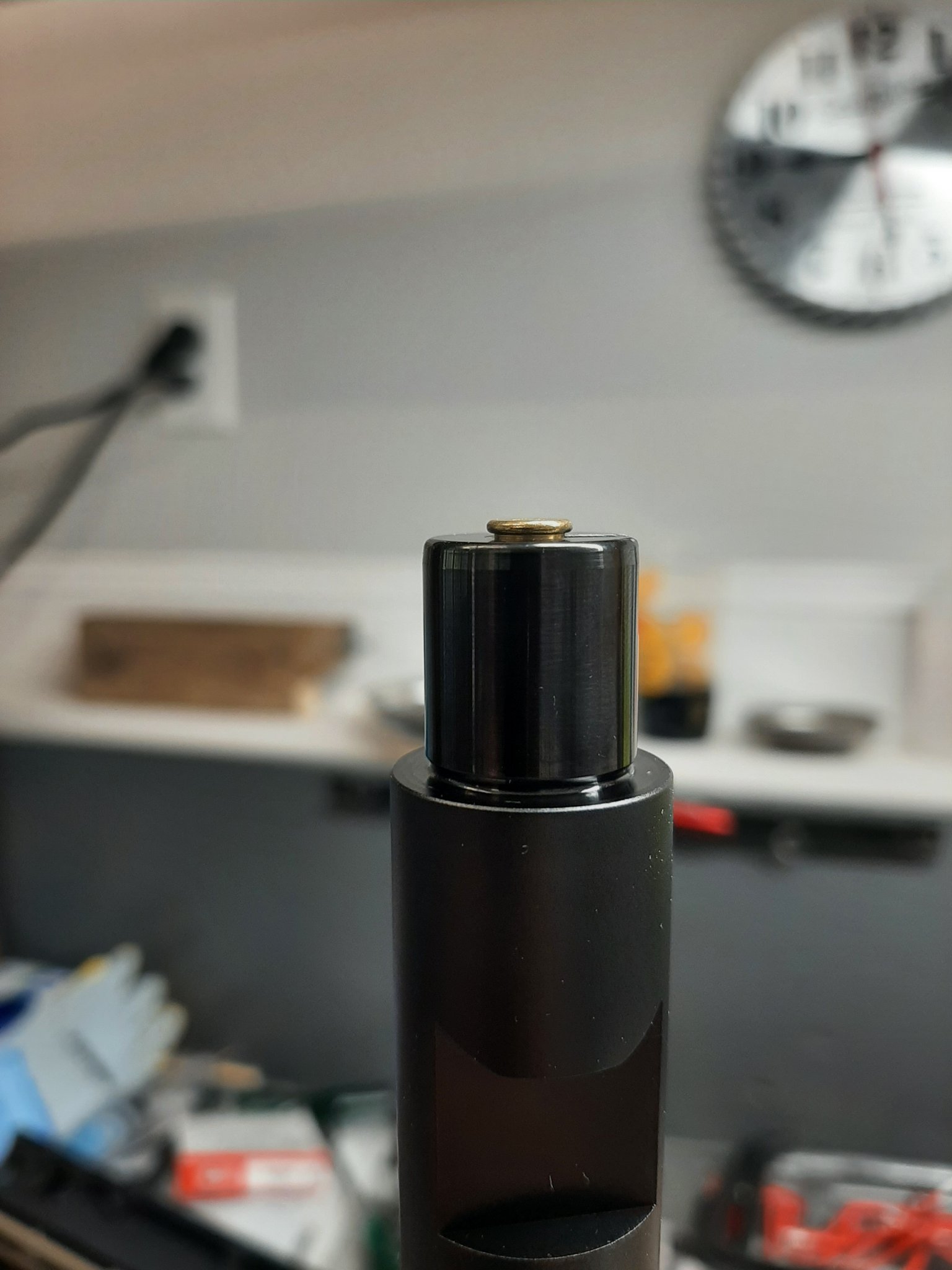

    Well no progress made but I decided to slap it back together and run it at a match this weekend. With the Wolf Match I was averaging 1/2" at 50 and with the SK Rifle Match I was about 3/4" at 50. Going to bring both but I intend to run the Wolf. I have zero data collected and not even a zeroed scope. Borrowed the s&b from another gun with the lowest rings i had sitting around that would work. Just using this as a shakedown match.
    As she sits for the match.
    Well things went really well and I'm loving the toggle action. Zeroed the rifle with the Wolf ammo and after the barrel settled in from the cleaning I have her she was printing a pinky nail sized 5rd group and figured why bother with the SK. For having no dope at all I picked out and the SK Match bullet profile in the Kestrel was spot on out to the farthest I shot today.
    Scored 82 of 87 possible points. Shots out to 350yrds. Unfortunately I tied for 3rd and only got 15/16 on the tiebreaker stage and the other guy got 16/16. 2 of my 5 misses were shooting targets out of order and that cost me the 3rd place.
    Still think I can squeeze some consistency out of her but going up against vudoos and rimX builds built by some fancy people I couldn't ask for more. This thread isn't done yet.
