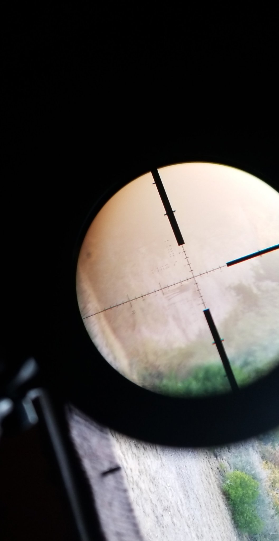

I don't see why you wouldn't run one 100% of the time. It does help protect your lens and of course, it acts as a shade to prevent glare from the sun to wash out your image.
The below image is one example of what can happen. That is a Minox ZP5 and my image went to shit with the sun hitting it at that particular angle. Why Minox did not make a damn shade for these is beyond my mind.
Needless to say, I have already found one from a different manufacture and it fits.

What brand fits the Minox? I have two and one of my deer stands faces west.
