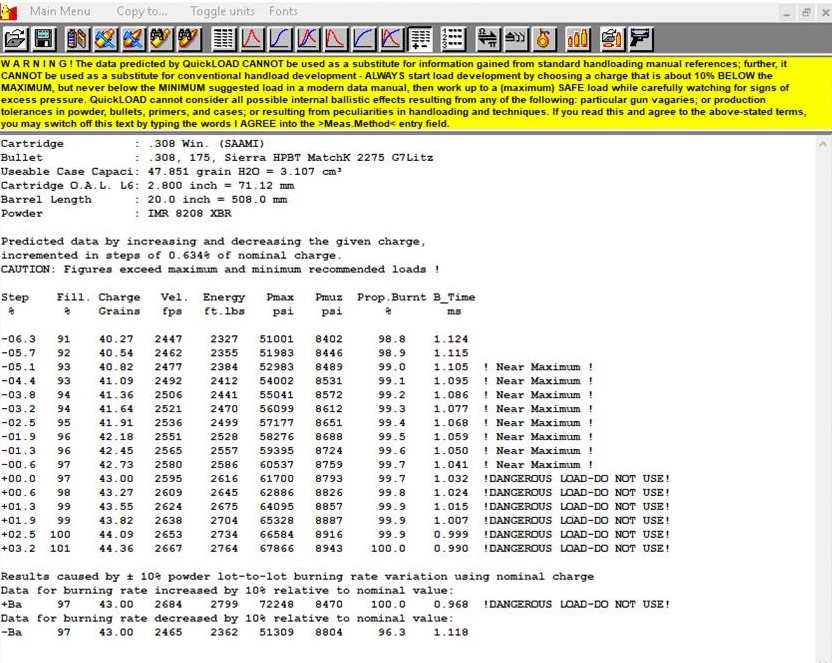

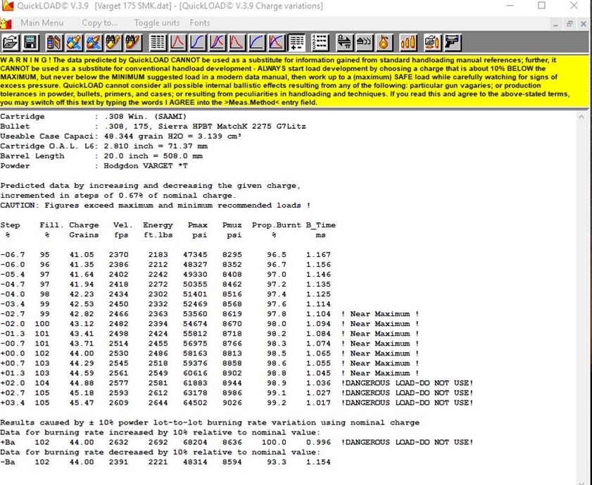

You didn't say anything about the barrel(s), like. . . what's the lengths? If you've got a 20" barrel, I think you're asking too much for a 175 SMK. . .depending on how hot your lot of Varget burns (can only tell with chrono data). With the default burn rate and a 20" barrel, here something that might give you some ideas. . .???
Reactions: RegionRat
You didn't say anything about the barrel(s), like. . . what's the lengths? If you've got a 20" barrel, I think your asking too much for a 175 SMK. . .depending on how hot your lot of Varget burns (can only tell with chrono data). With the default burn rate and a 20" barrel, here something that might give you some ideas. . .???
