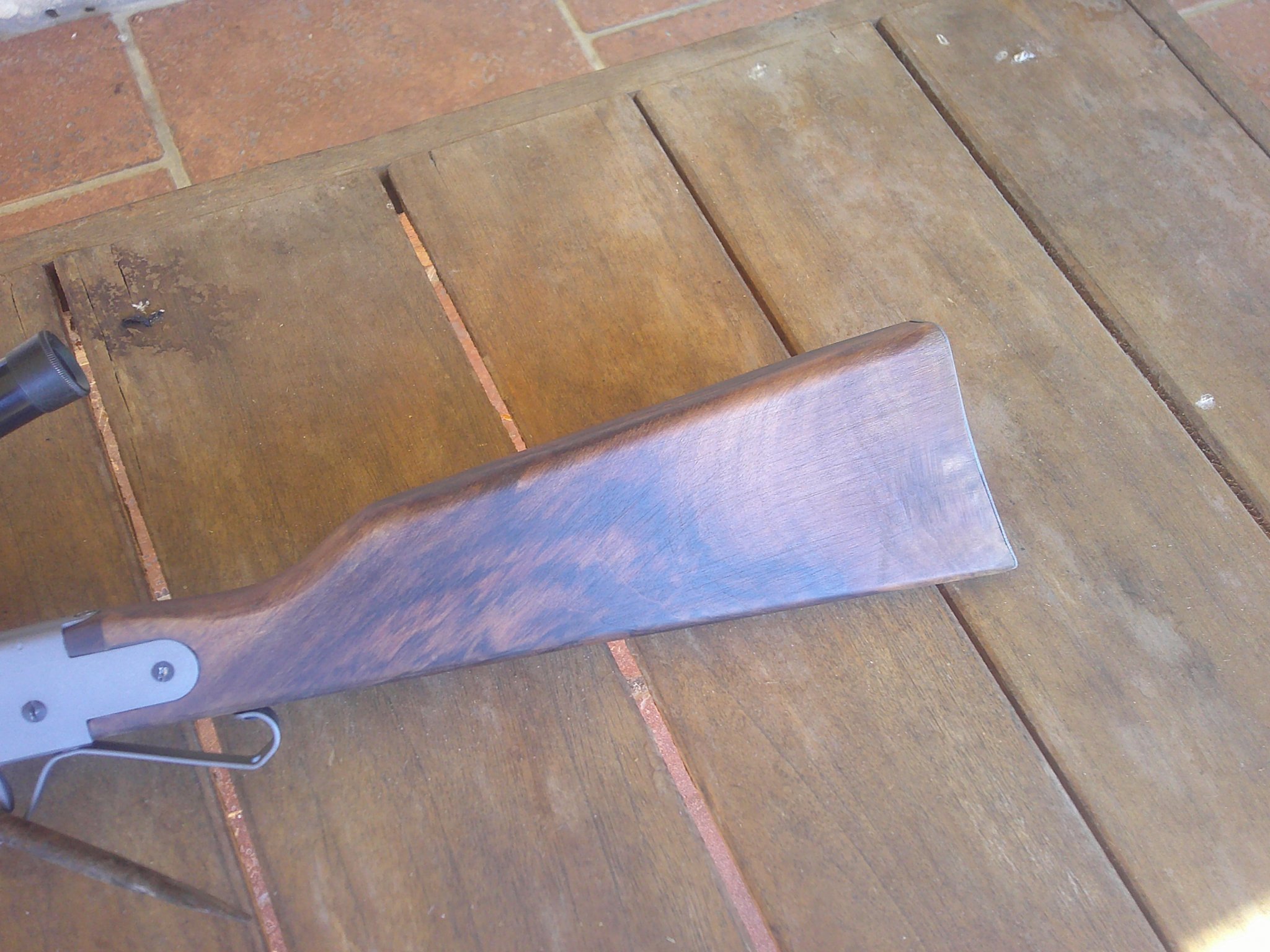

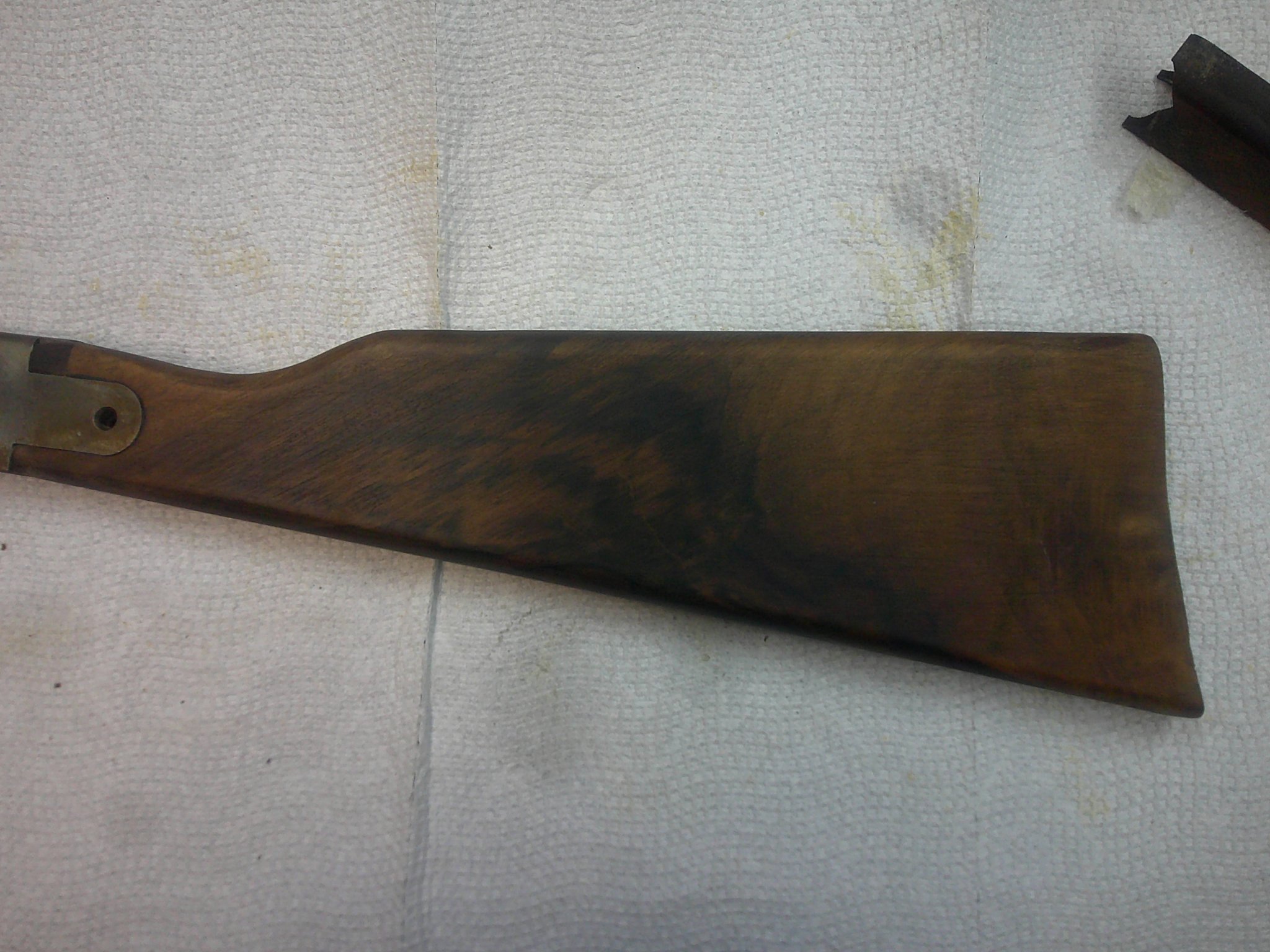

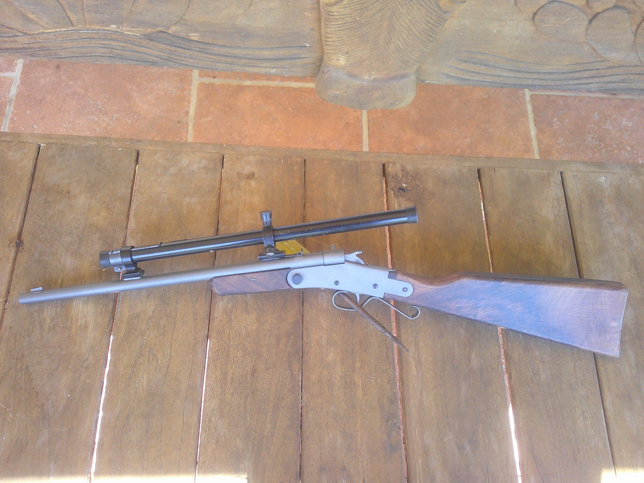

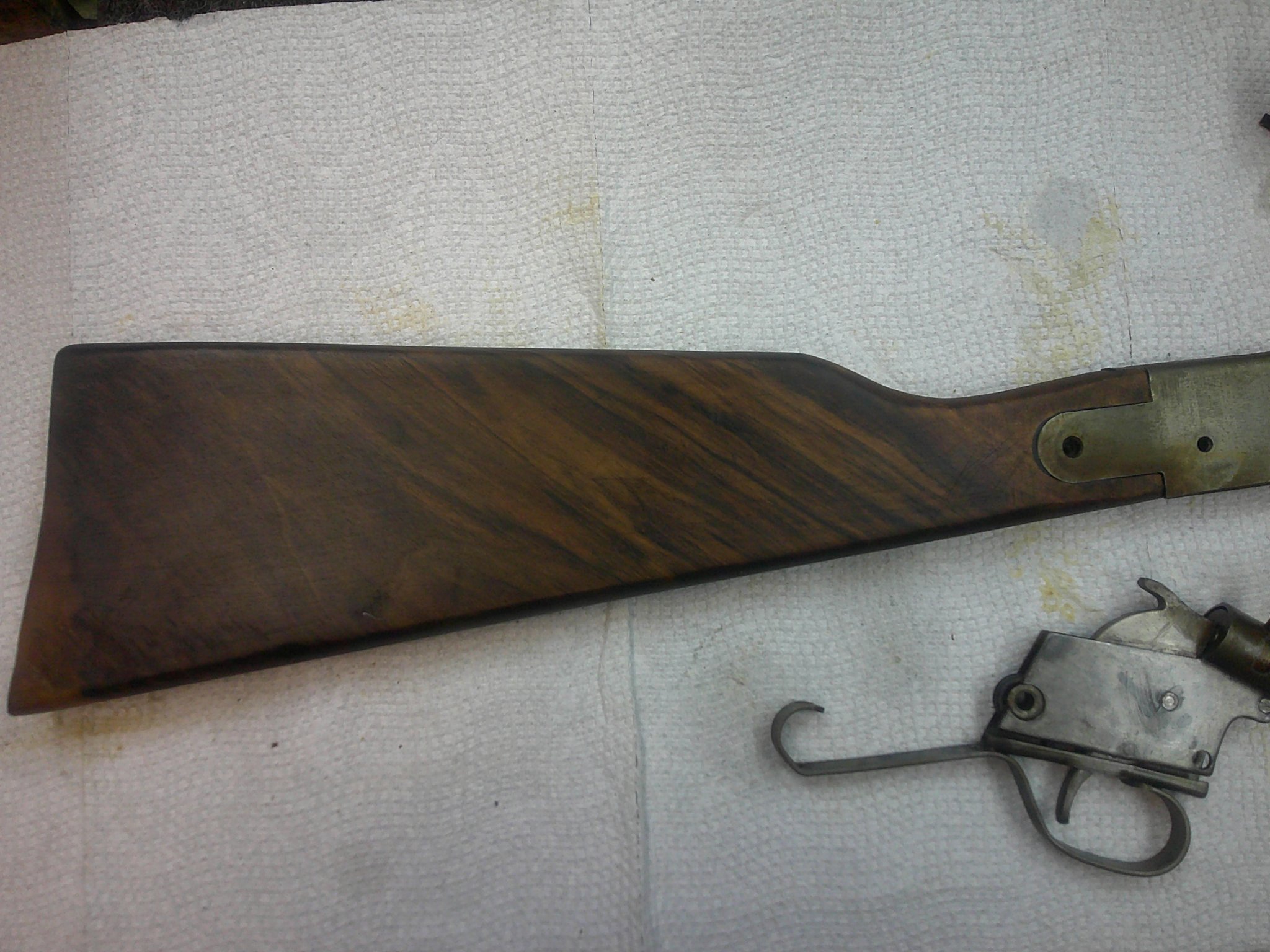

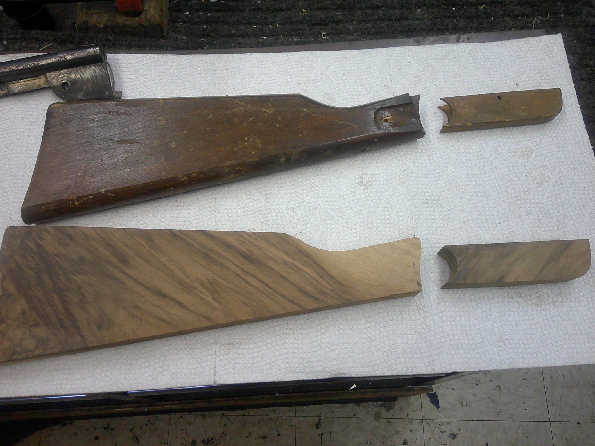

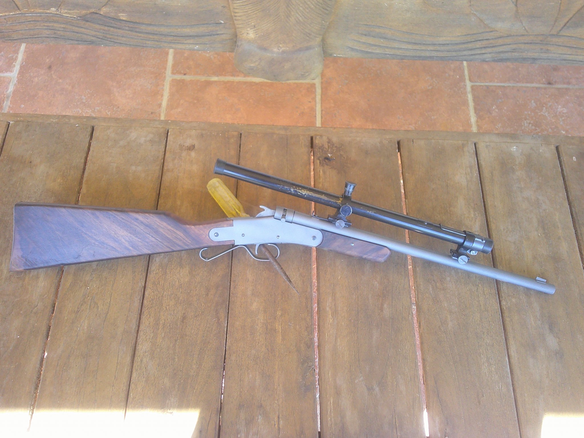

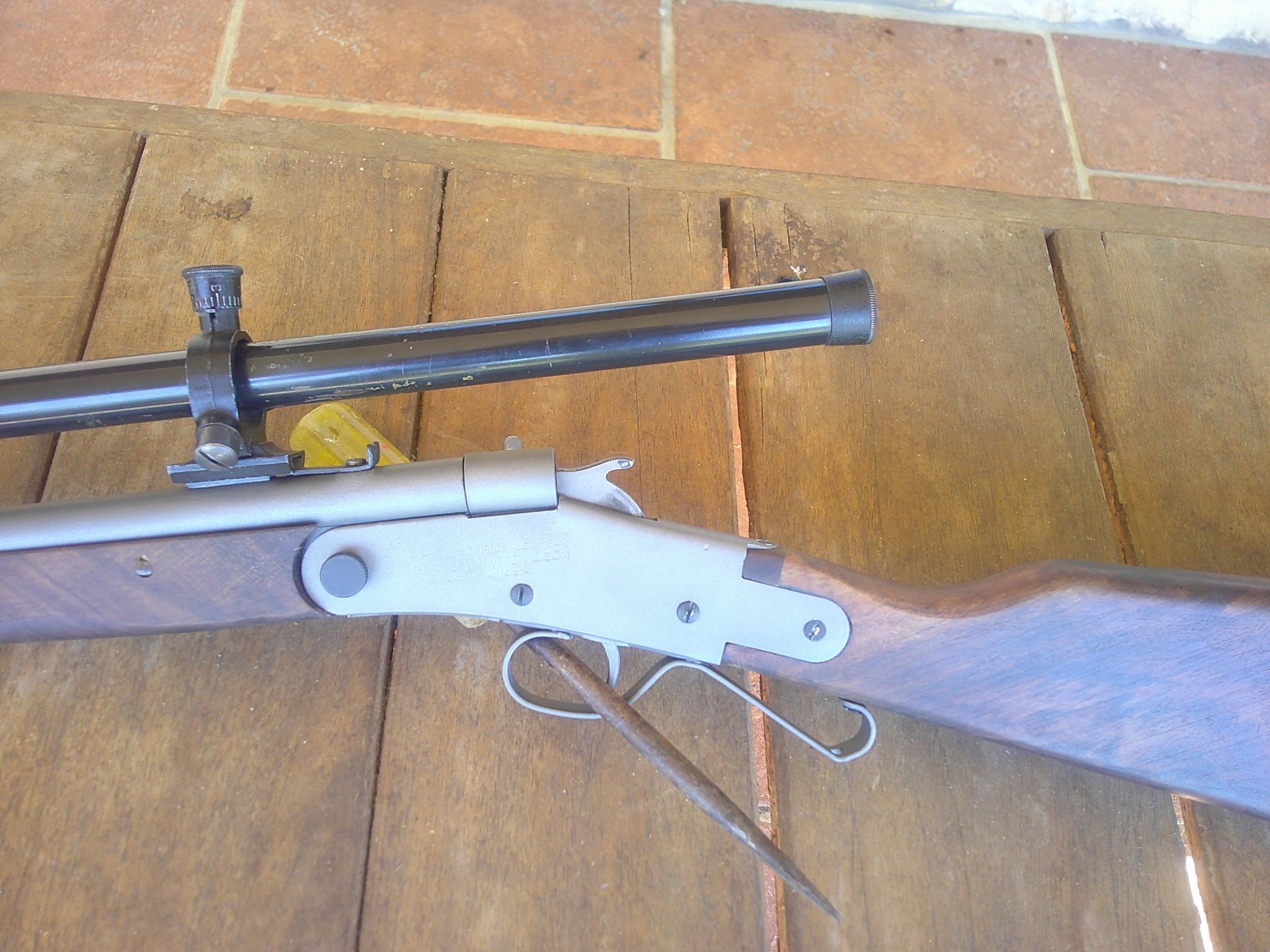

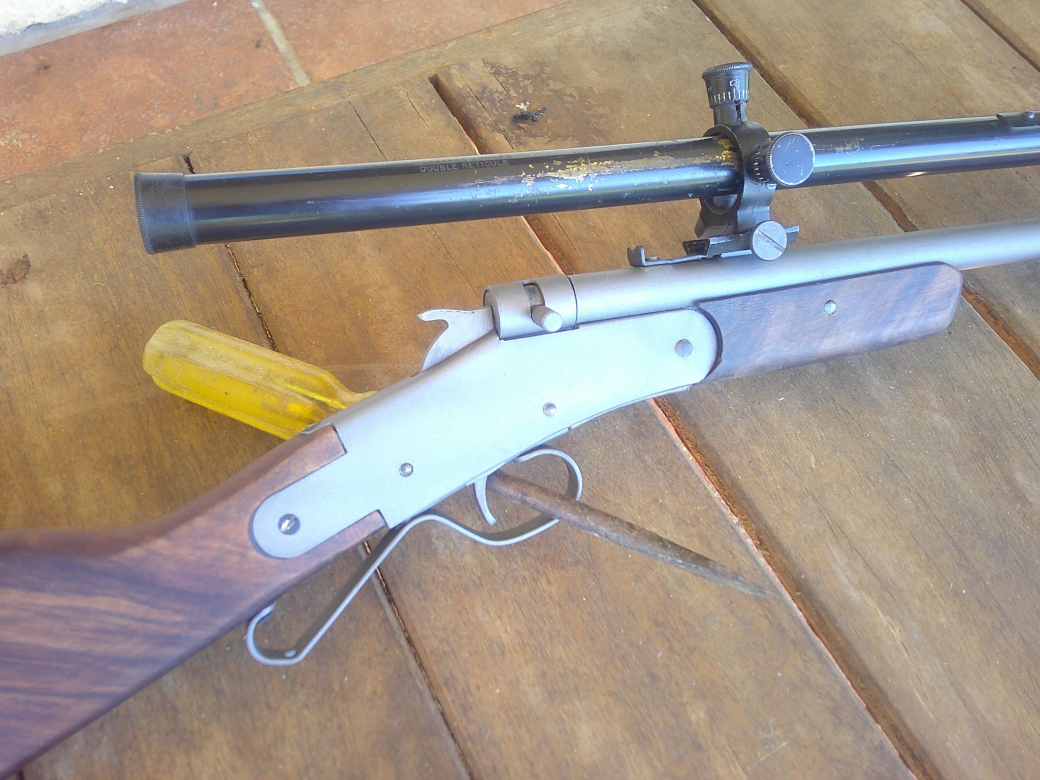

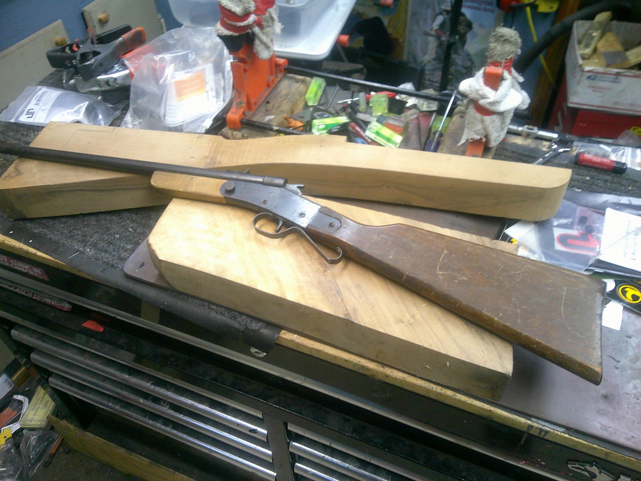

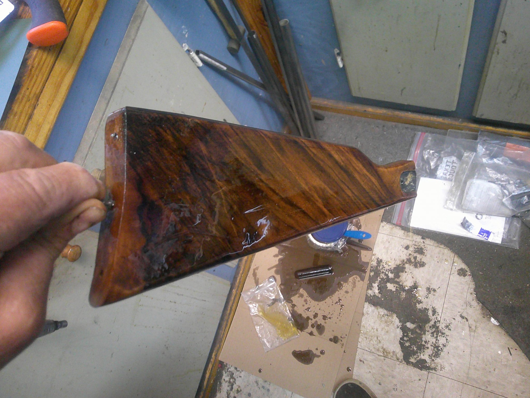

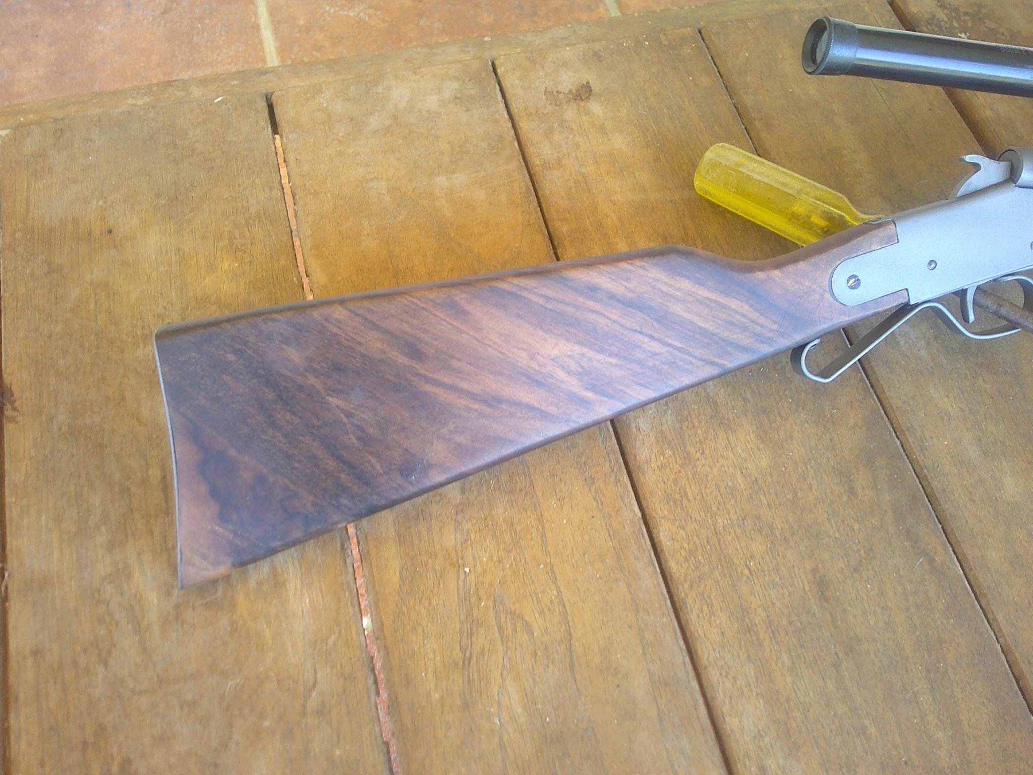

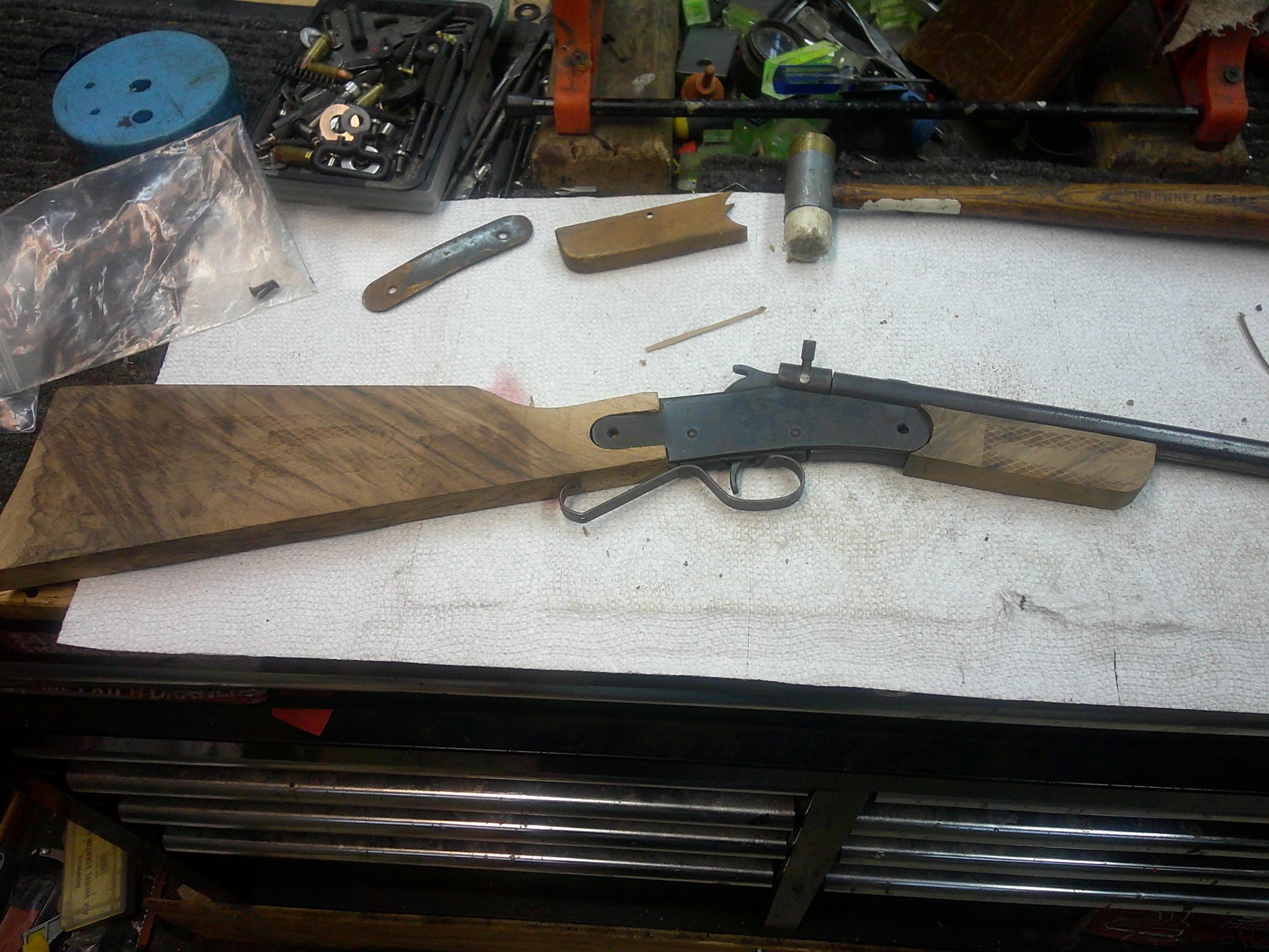

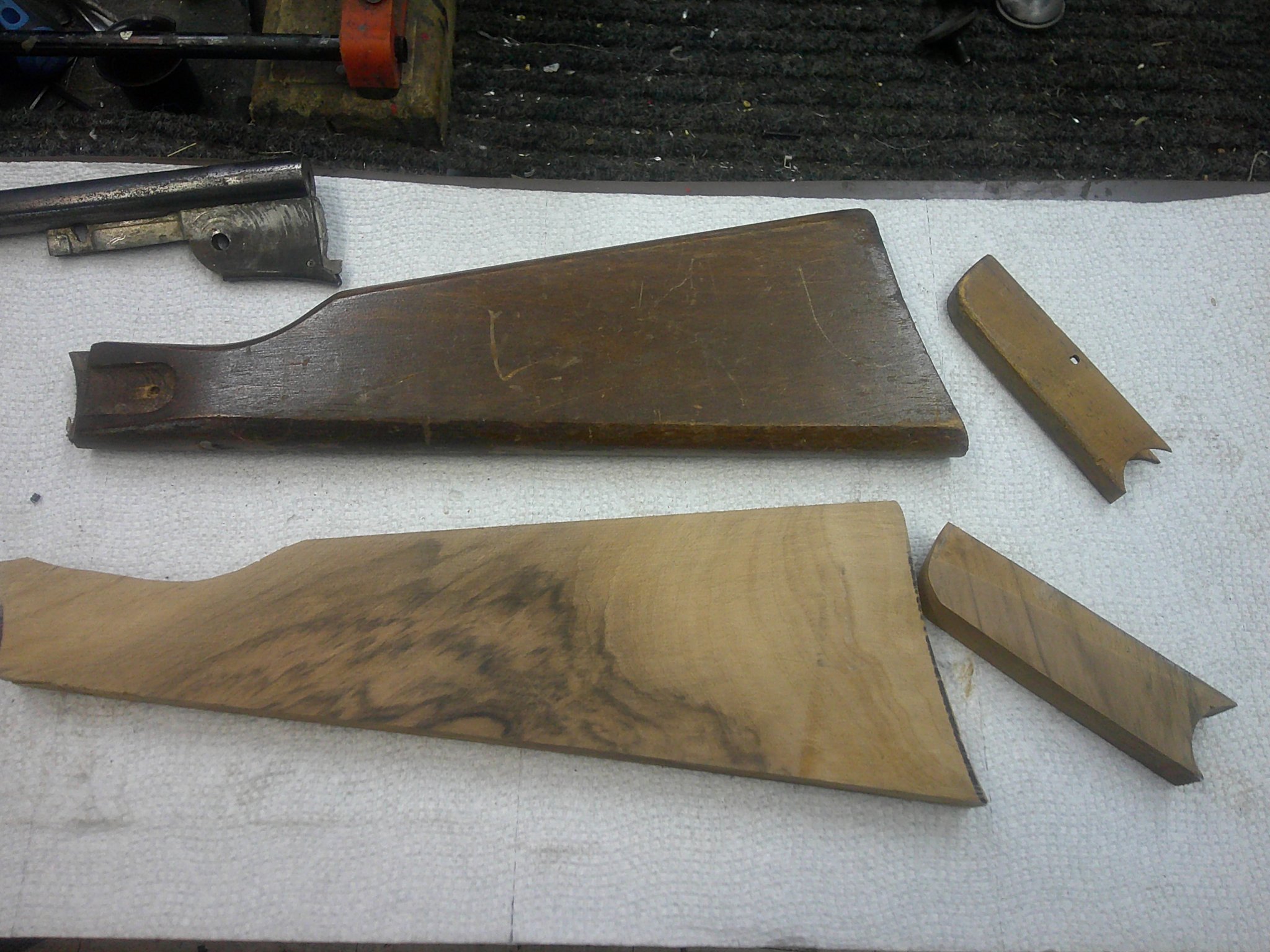

    Bought this for $150. Patent date 1900, Hamilton no. 27 boys rifle. All I had to do to get this to shoot was wack the firing pin with a punch to free it. At least 100yrs old and works fine. I am going to completely refinish this and re-stock with exhibition grade walnut.

    If you don't already have the wood contact First Stop Guns in Rapid City, SD they have over 1000 blanks.

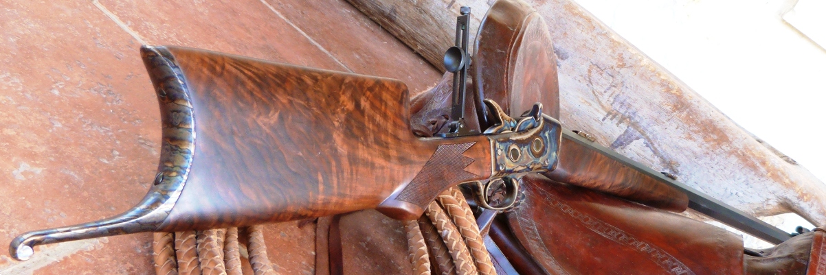

    Rust bluing low guality metal, in old rifles, is a very iffy experiment. I rust blued a Spanish copy of a Smith and Wesson Schofield and it turned a dull matte black. I rust blued a modern steel barrel for a rolling block and it turned out a beautiful deep blue gray.
    Remington rolling block that I built. It started out as a rusty receiver my farrier found in a barn. McGowen barrel, case hardened receiver, exhibition Walnut.
