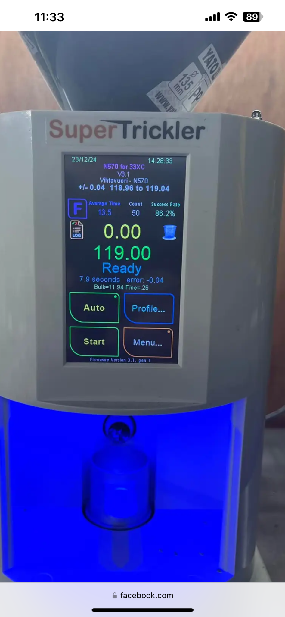

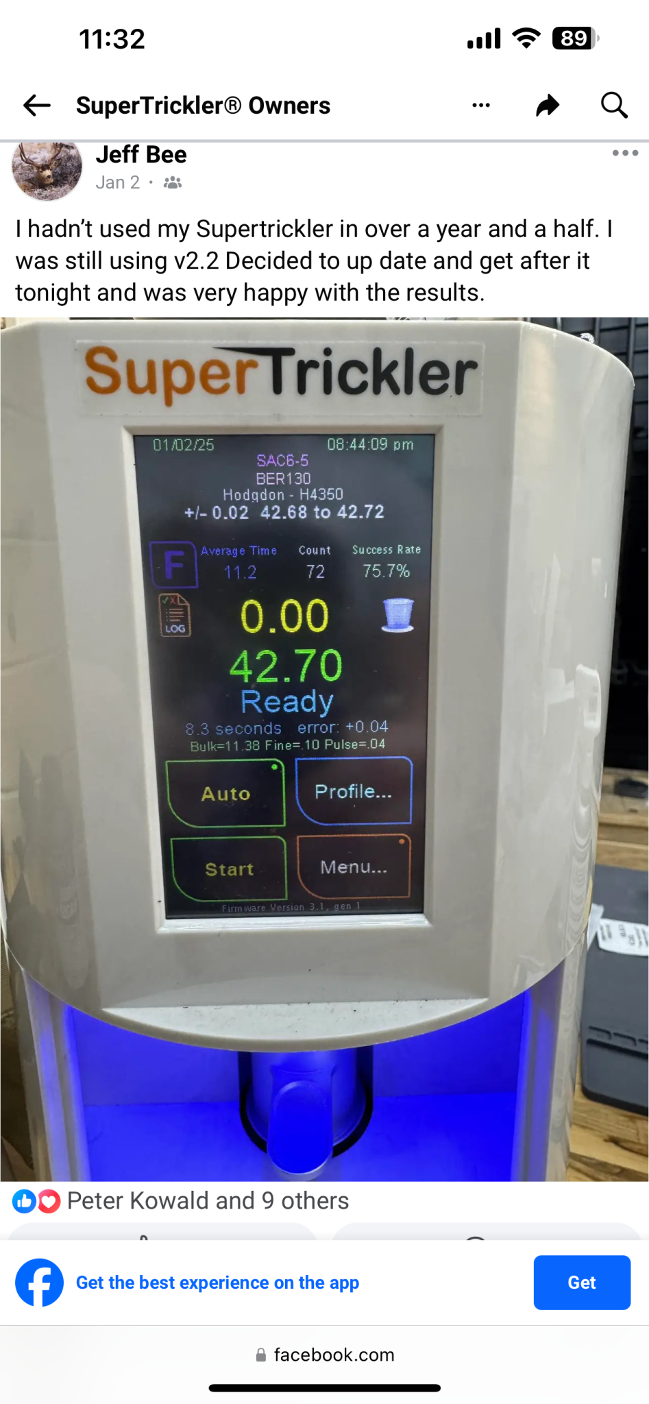

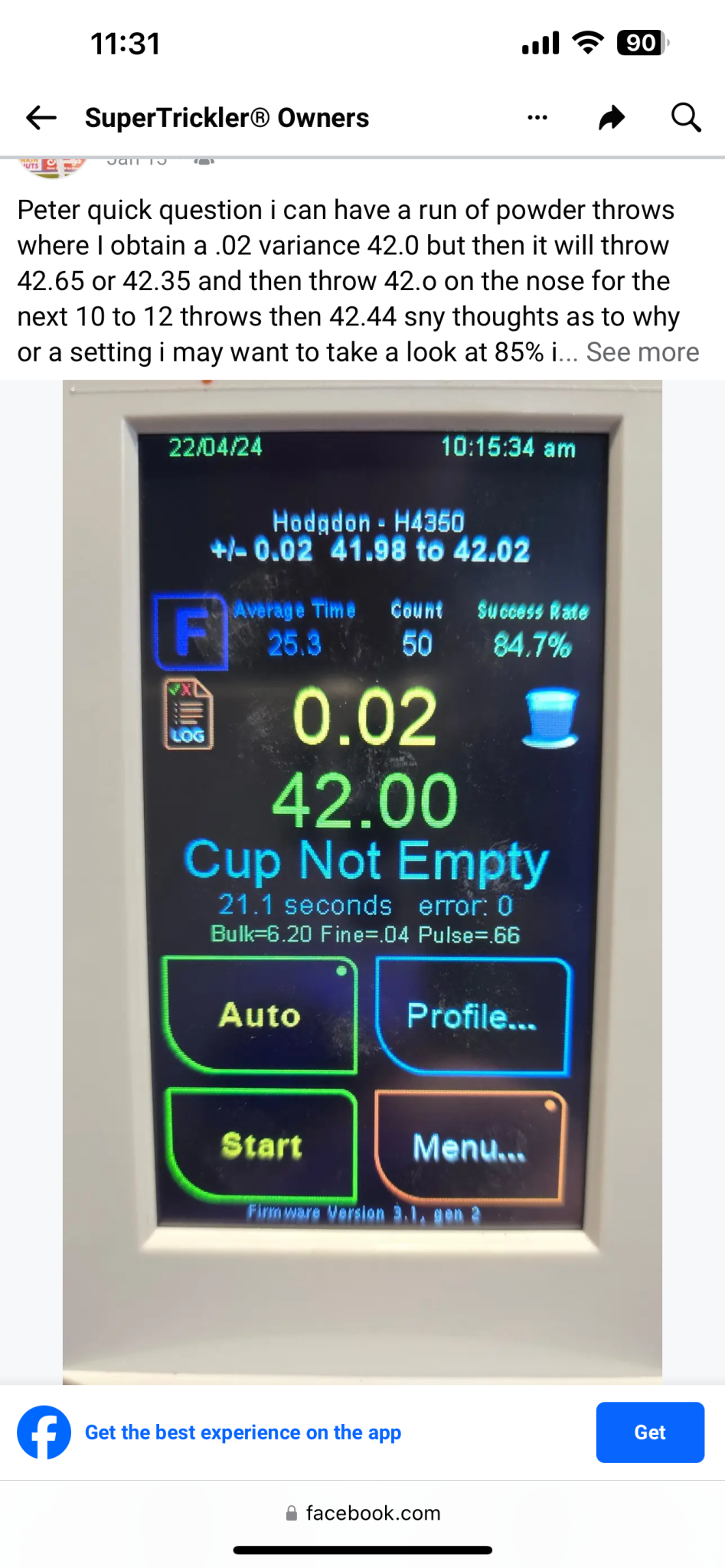

Random screenshots from the owners group on Facebook you can see the success rate and the average time and the number of throws yourself
