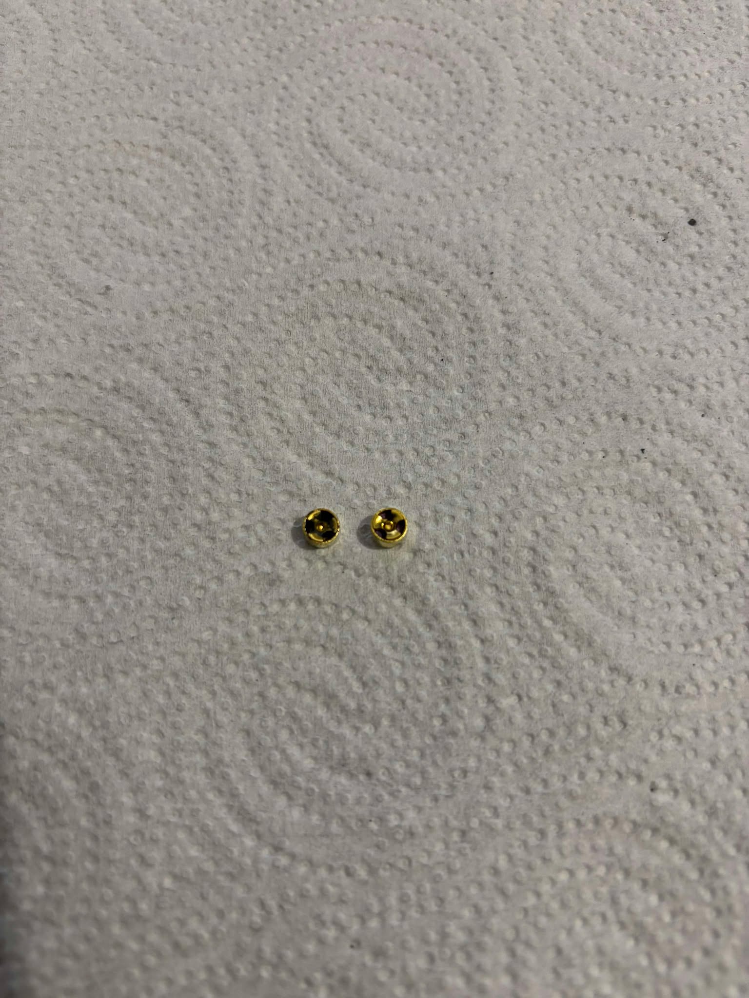

Primer of the misfire on the left, and brand new primer on the right for comparison:

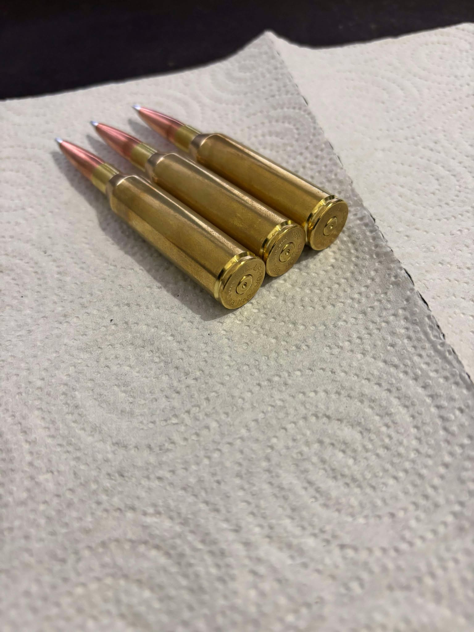

3 of the misfires where we can see the protruding primers:

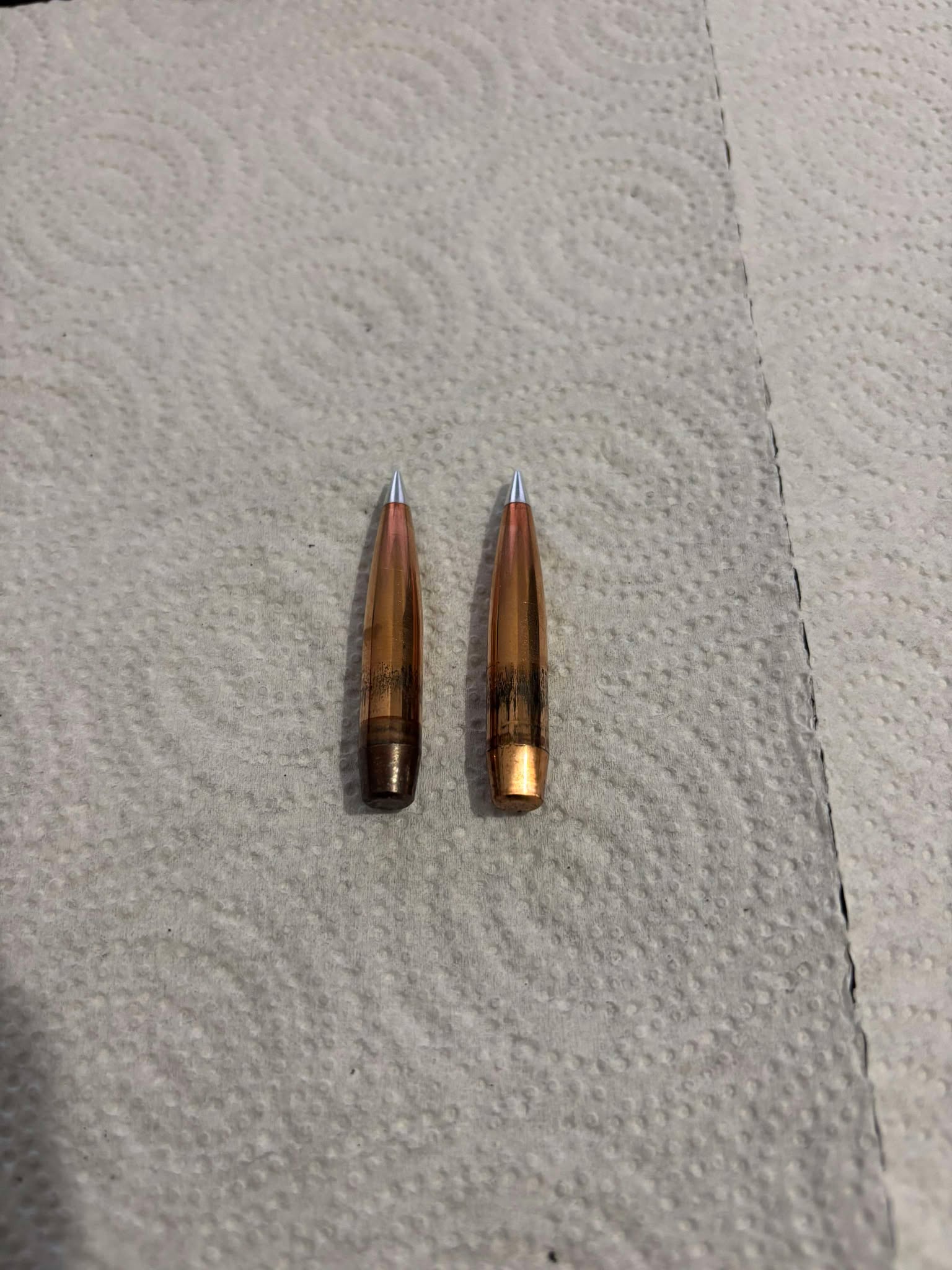

Bullet of the misfire on the left, and non-shot bullet (which I pulled) on the right for comparison:

IMO ,Issue lies with PRIMER . Your fired primer looks weak ,as not very black ,yet your bullets ( Both look Black sooty on their bodies not just the base of the bullet . So inside cases clean ?, It appears they're not . Thoroughly clean #5 cases DON'T lube the neck

The primers that are backed out a little make me wonder if there is a head space issue.

The black on the bullet on the right is due to Neolube which is black, however we can see that there is no black on the base because it didn't contact the Neolube at that place. Only the bullet on the left is sooty on the base. The inside of the case is sooty/black, there is a clear difference with a non-fired cartridge.

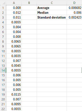

About the primers seating depth, I measured 22 of them (TLDR: ranging from 0.004in to 0.0115in, median being 0.006in):

I know you don't think so, but my bet is high primers.

I measured the seating depth of 22 of the primers (C.F. screenshot above), what do you think?

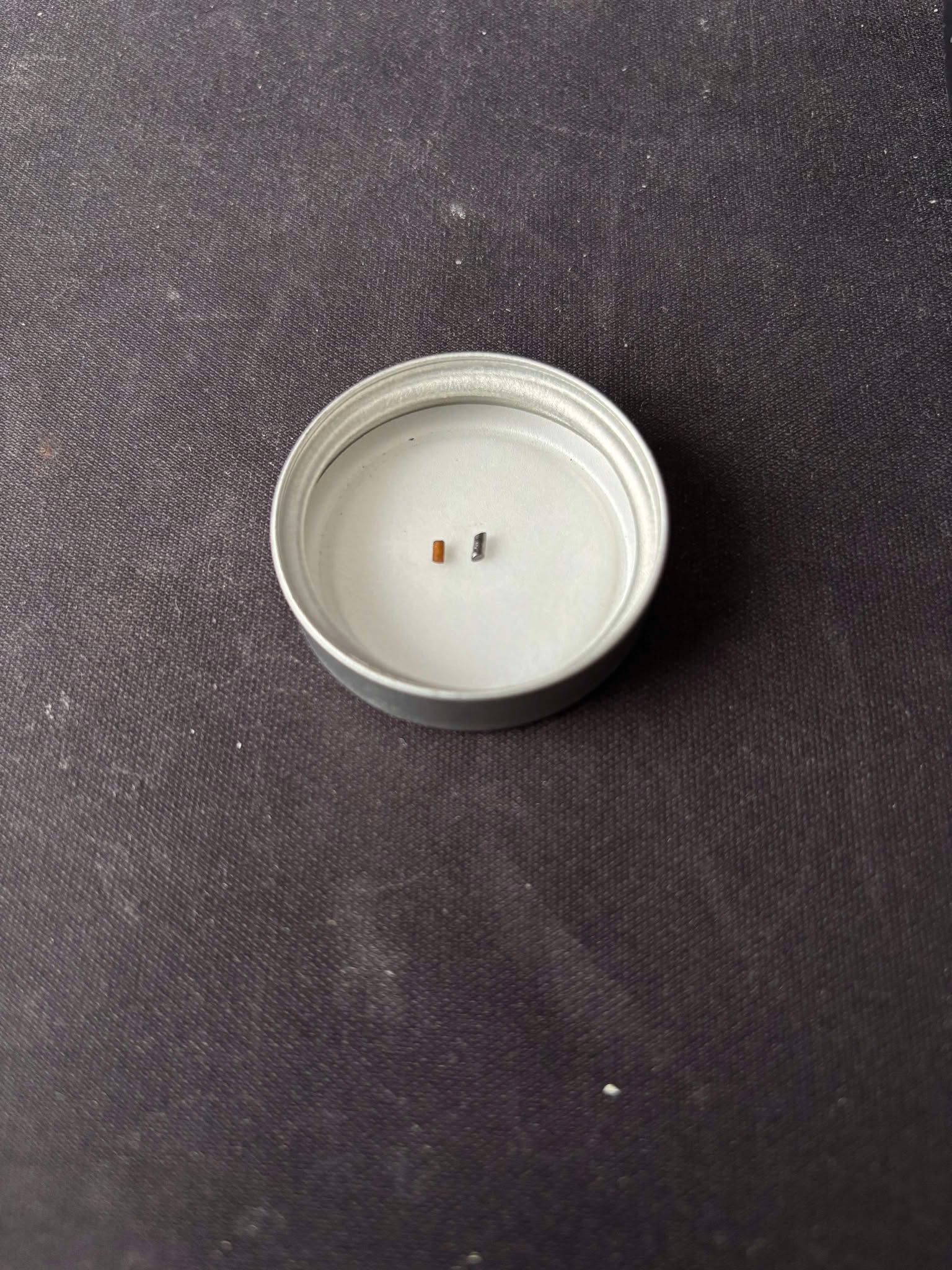

Also, I just noticed that there were brown kernels in the cartridges which misfired.
Brown kernel from misfired cartridge on the left, normal kernel on the right:
Would this brown/bronze color indicate more of an issue with a weak primer or with the powder?

The backed out primers have me questioning headspace.
YES the primers brisance isn't powerful enough too ignite stick powder . A hotter magnum primer is required . IF RWS fails ,you most certainly have powder issues . I'm assuming your case fill is 90+ % ?. I don't load 300 Norma but load near #20 other calibers .

N570 is notoriously dirty, so the image of your bullet with a bit of black soot is probably from the powder making contact with the bullet.
