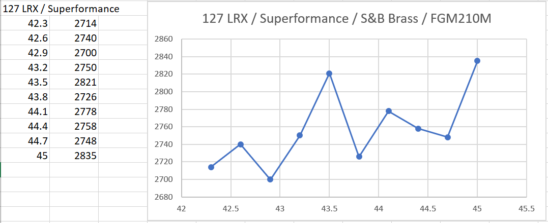

So excuses excuses excuses - Finally shot the 127 LRX / superformance ladder.
Load data pulled straight from Barnes, including their shorter than average COAL of 2.720". They start at 40.5gr @ 2584fps to a max of 45.0 gr compressed @ 2865 fps from a 24" barrel... I have a 21 but I still matched expected velocity fairly well. I dont think the chart tells me much...
45.0gr was not compressed for me. I could shake and get some powder movement.
I started to get pressure signs around 44.4gr and up. Started with bolt lift and got ejector circle on 45.0. Anything past 42.9 had a flat primer, but with large primers this gun flattens them with regularity.
I was indoors, 50yds, 75-80*, shooting off my recon mini and free recoiling, just to practice. 43.2 to 44.7 all shot to same approximate POI.
Not really sure where to go next. May try H4350 or RL16. I really wanted to not buy several boxes of 127s for a single deer trip in august...

Is this in a 6.5CM? Its seems slow for superformance.
How does this compare to other powders you've tried?
Im getting 2800 with 44gr of RL16 out of a 22"
I'm no expert but I would load up a few and test groupings of every .1gr between 42.5-43.2 and then 44.0-44.7
This is for 6.5 CM. I think my barrel runs slow, on average.
I think I'll try some at 44.3, .5, and .7.
