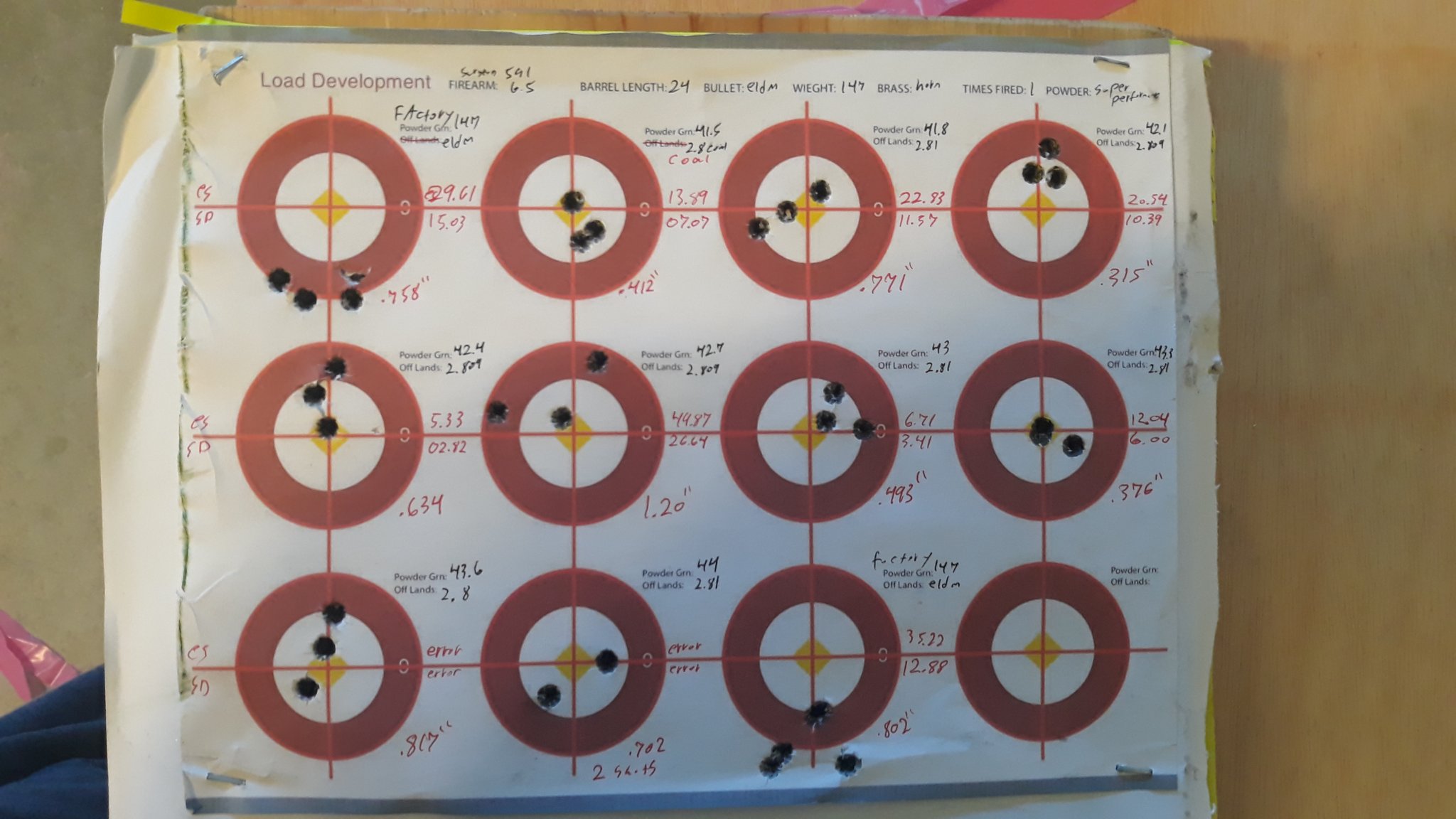

ok so here are my results with super performance. keep in mind this is my first batch of reloads ever, i used coal not ogive, and i probably mucked something else up that i dont even know.
all are 3x shots as i was expecting worse results and was kind of hoping to just find a node and then reload 5x groups in those areas.
first and last group is hornady factory 147eldm loads, last group is a 5x group
everything else is my loads all 147 eldm
factory/ 2679, 2662, 2692 / av 2678, es 29.61, sd 15.03 / group .758"
41.5 / 2535, 2532, 2523 / av 2534, es 22.83, sd 11.57 / group .412"
41.8 / 2546, 2532, 2523 / av 2534, es 22.83, sd 11.57 / group .771"
42.1 / 2545, 2565, 2550 / av 2553, es 20.54, sd 10.39 / group .315"
42.4 / 2538, 2543, 2538 / av 2540, es 5.33, sd 02.82 / group .634"
42.7 / 2629, 2579, 2588 / av 2598, es 49.87, sd 26.64 / group 1.20"
43 / 2604, 2598, 2604 / av 2602, es 6.71, sd 3.46 / group .493"
43.3 / 2640, 2633, 2628 / av 2634, es 12.04, sd 6.00 / group .376"
43.6 / error, error, 2660 / chrono didnt read first 2 shots / group .817"
44 / 2689, 2665, F2F bad primer / av 2677, es 24.87, sd 16.9 / group .702
factory/ 2669, 2666, 2683, 2659, 2648/ av 2665, es 35.22, sd 12.88 / group .802
looking at the results im thinking reload 5x in the second green area. ive seen recommendations of .1 grain increments. possibly between 43 and 43.5, thoughts?
also as far as speed there were no signs of pressure, im thinking i should keep pushing and try to find another node or 2.
also is there any benefit to staying at a slower node besides barrel life, and maybe less adjustments for ballistics. once you have your dope chart you should be set no matter the speed right? less wind calls?
over all im happy with the results, should i be?

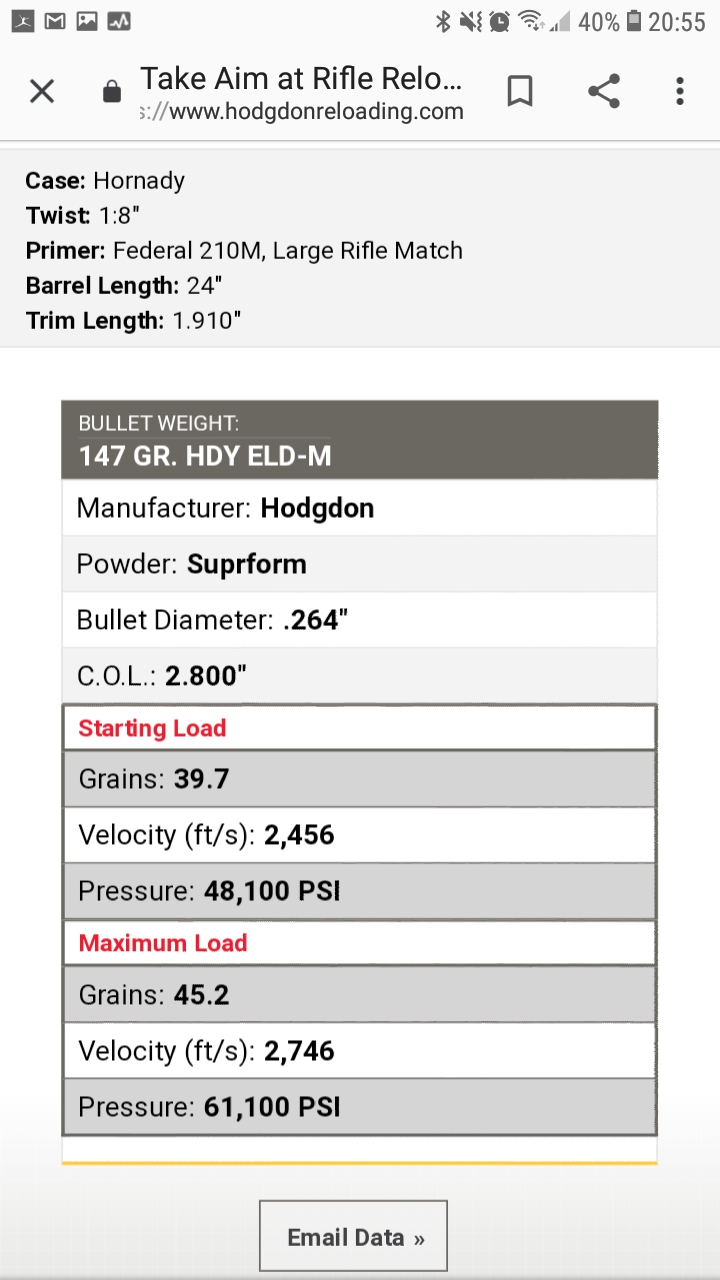

I've been unable to find data for Superformance powder at all anytime recently. I looked in Hodgdon Annual manual going back to 2007 but didn't see data in any cartridge I load for. Is this powder still out there?
So would you guys think use max load from the bullet manufacturer or the powder manufacturer. I'm already over max according to hornady. But no heavy bolt or case head swipes.
Just found the hornady data, I was using the Hodgdon data before.

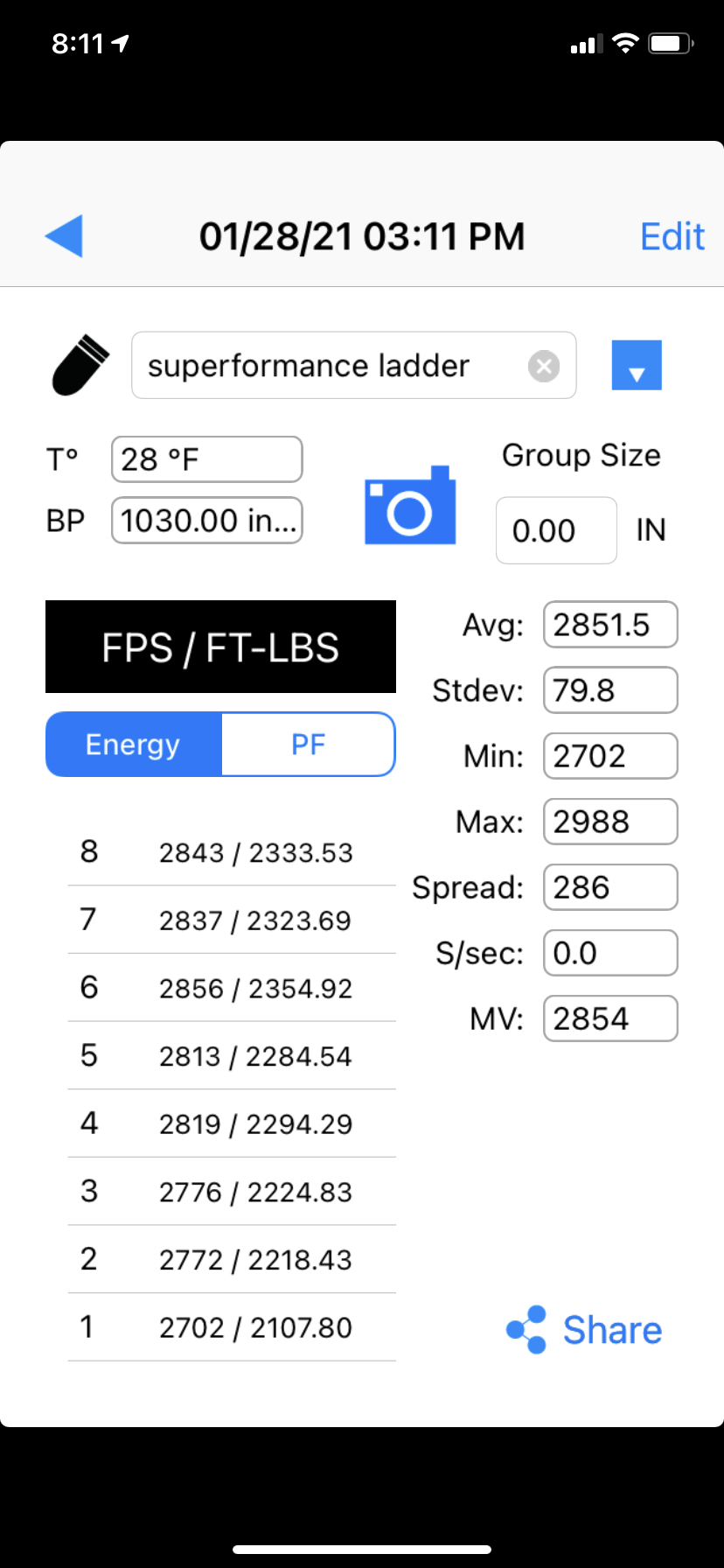

This is a very interesting powder, I just bought some superformance and ran a 14 shot satterlee test with eld 130s all shots would just about fit in a half dollar with loads from 43.5 to 46.7 I see no reason to got to the upper limits of the velocity but looks promising around the 2845 FPS range.
