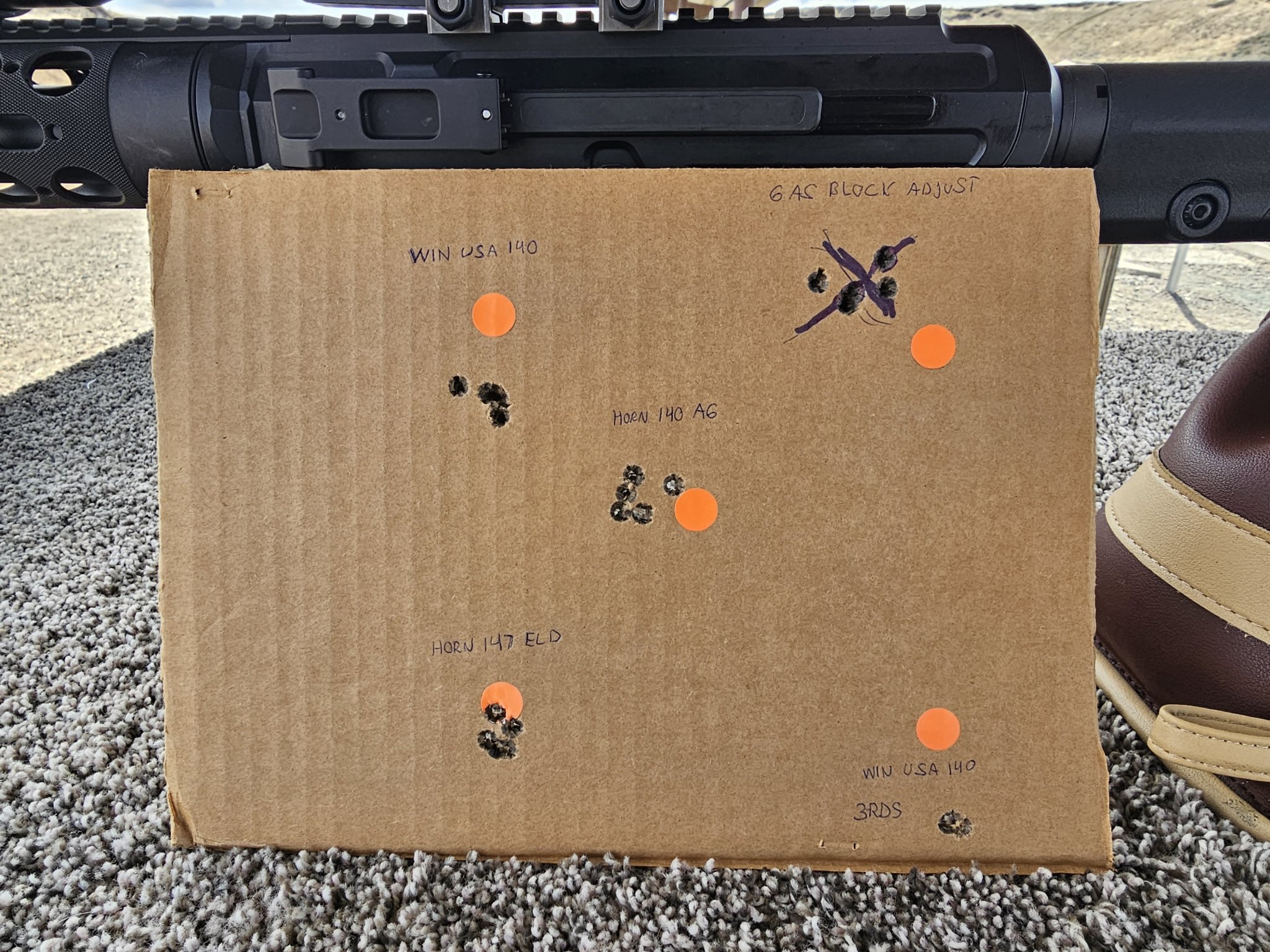

Got it two or three weeks ago! Still waiting on some components to finalize, but the barrel looks great. Profile isn’t as silly as the M110 print with the .750” GB and forward.
Yeah you'll be happy with it, every barrel Paul Ross at CLE turns for me is a laser.
This is the 24" CLE Bartlein on my JP LRI-20. First 28 rounds down the barrel cleaning every 5 rds.
Reactions: lash and Faronth
