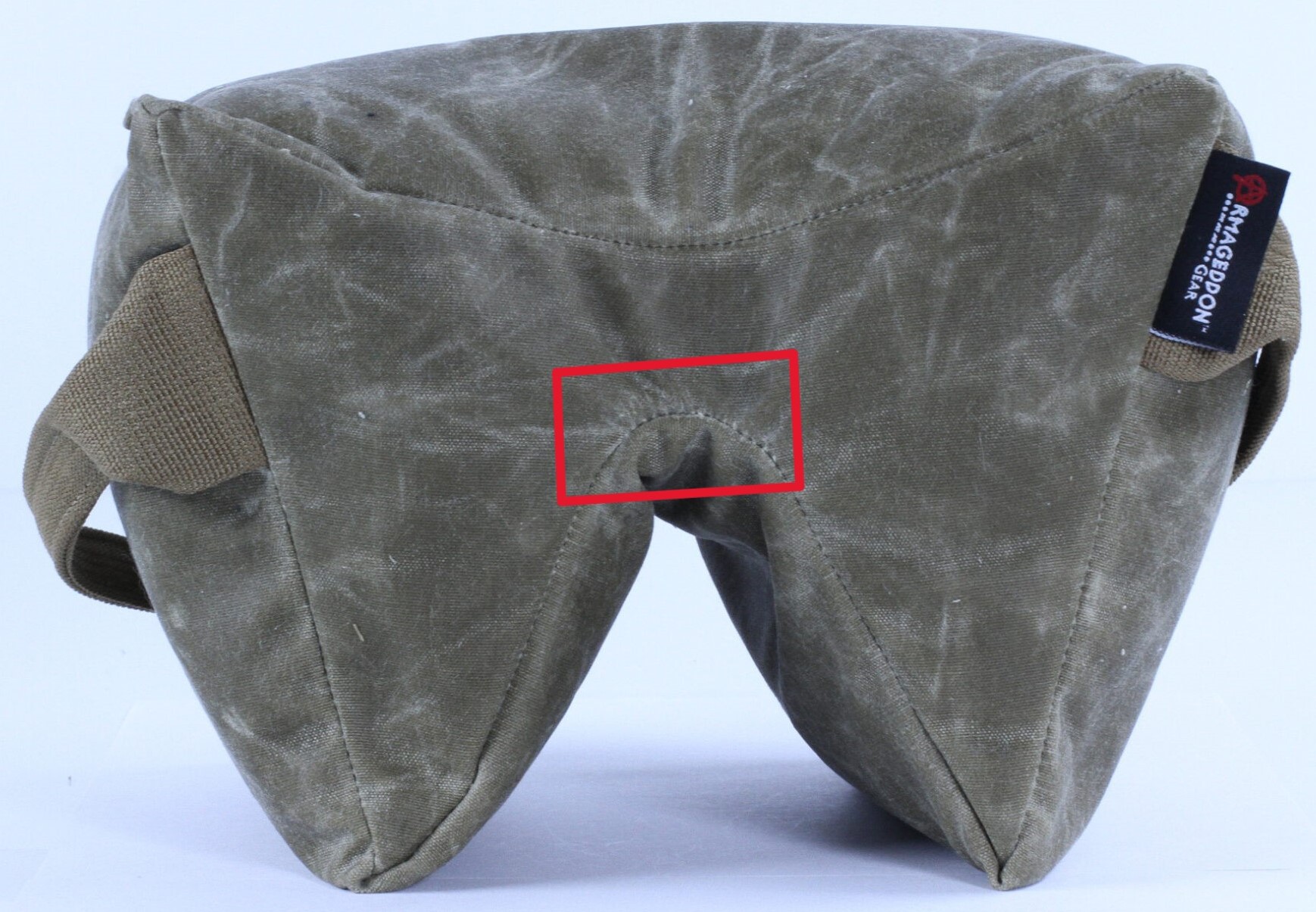

Looking for ideas to reinforce failure points in support bags to get some extra mileage before repair/replacement is necessary. I am specifically interested in methods to reinforce the seam at the “waist” of a waxed canvas schmedium game changer shown below:
I have tried a few things with varying degrees of success including otter wax, CA glue, shoe goo. Anything else worth trying?

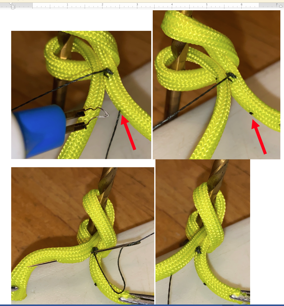

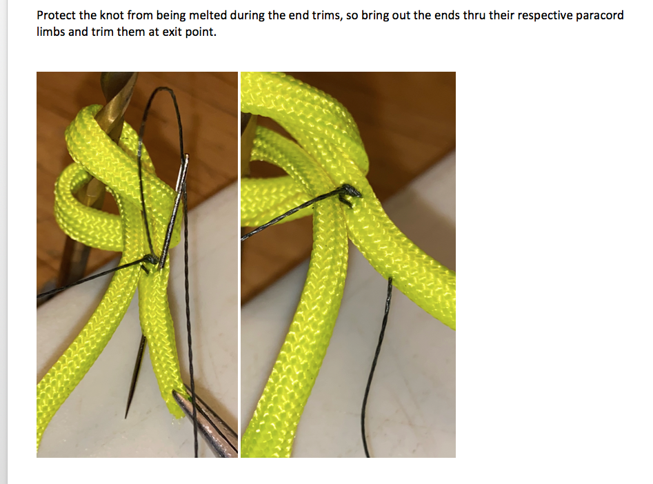

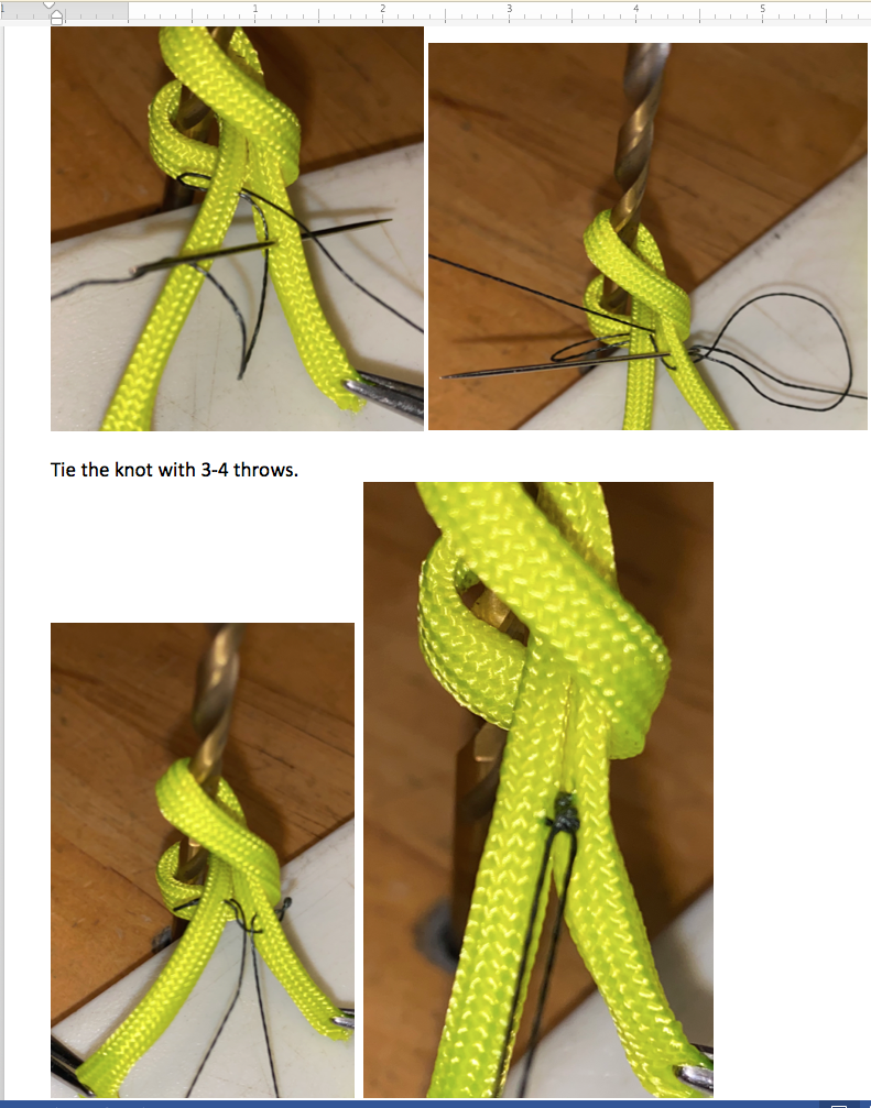

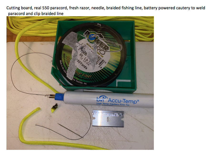

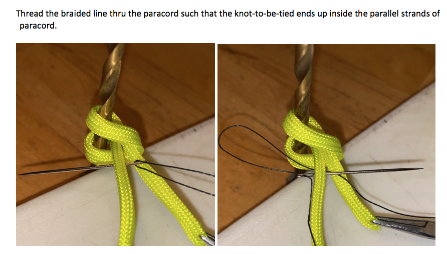

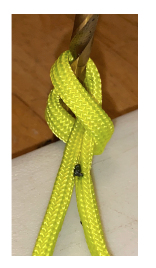

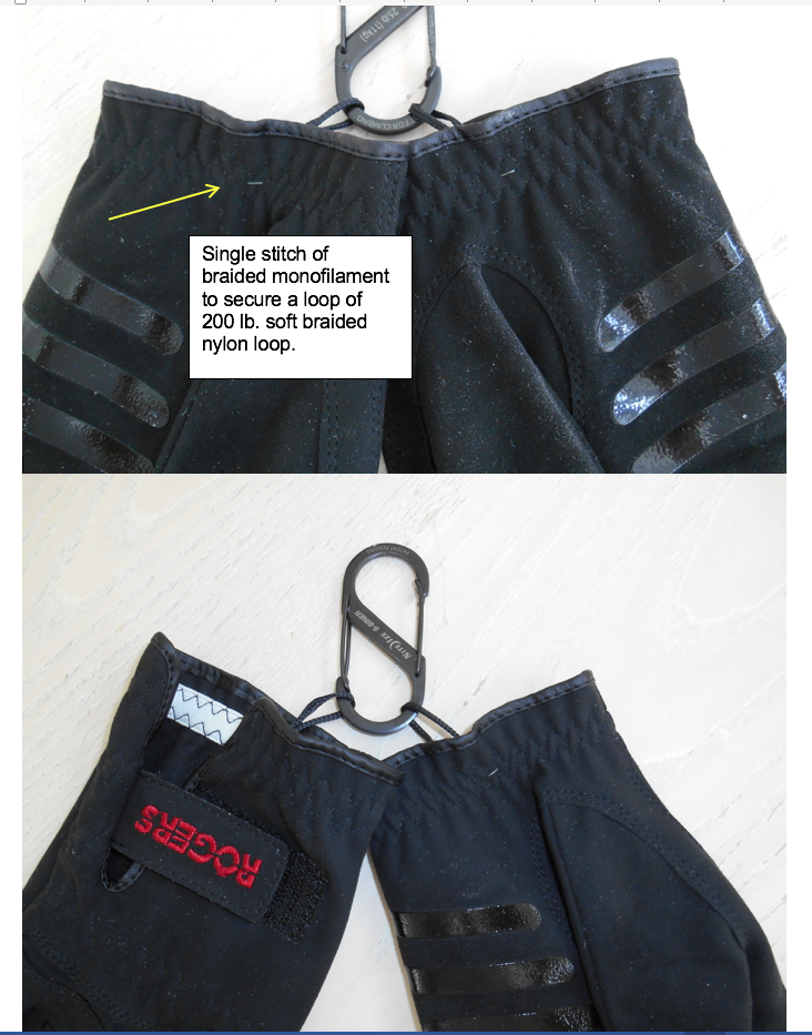

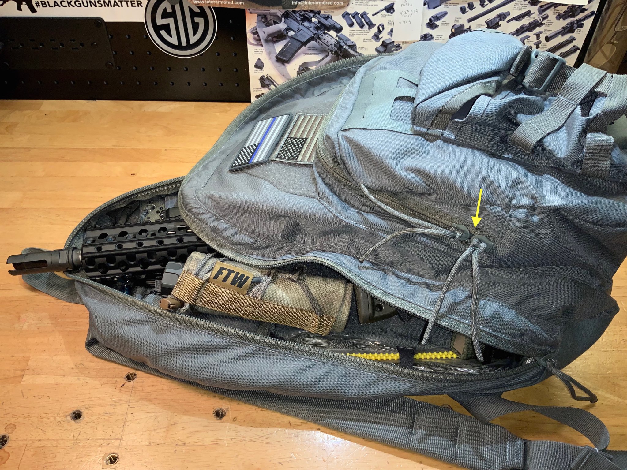

I have been using braided flurocarbon fishing line to create all sorts of paracord zipper pulls , install glove loop keepers, repair backpacks and all manner ofthings with this method. I use the hot battery cautery to cut / melt the braided line in close quarters. Some variant of this method will secure your bag seam until the other seams give way.

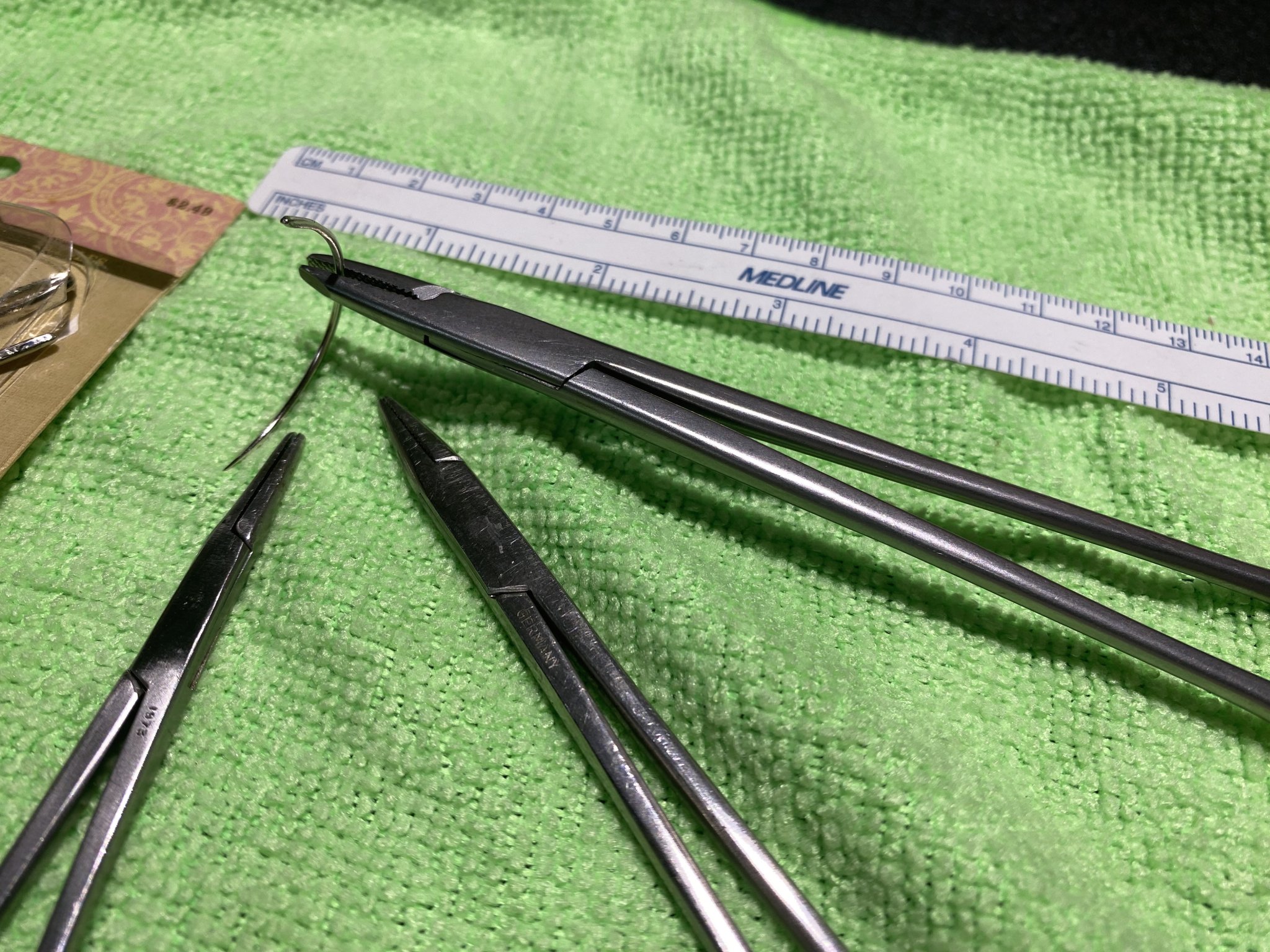

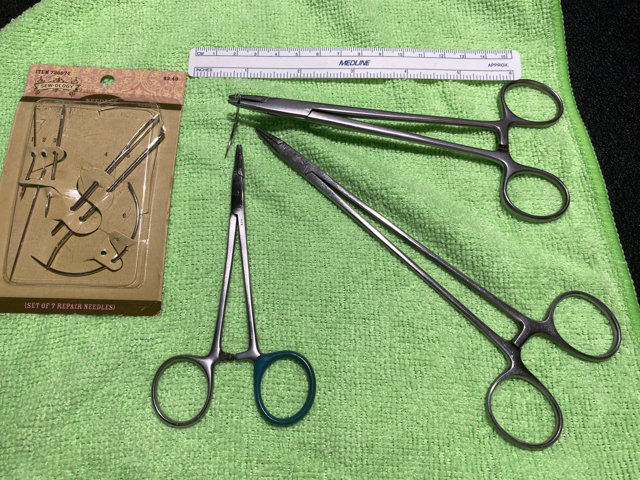

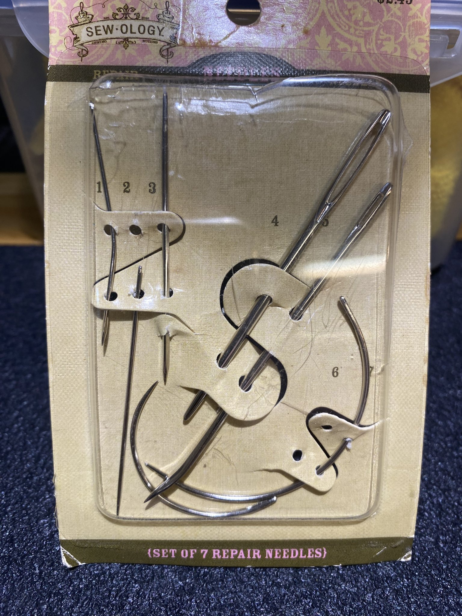

.........you will want to get a set of heavy duty needles at Walmart fabric department or Hobby store; need to get an Amazon inexpensive heavy duty "needle driver", the curved needle profile would work well in your situation. The retired needle drivers shown are tier one surgical quality ($100's of dollars apiece) as I use them in my daily livelihood.

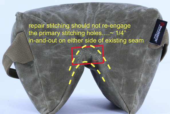

That's exactly how I re-sew mine. What I'm saying is the initial failure on all of my bags is not the thread. It's the bag material failing at the holes where the thread perforates. That's how it also fails with the new thread.

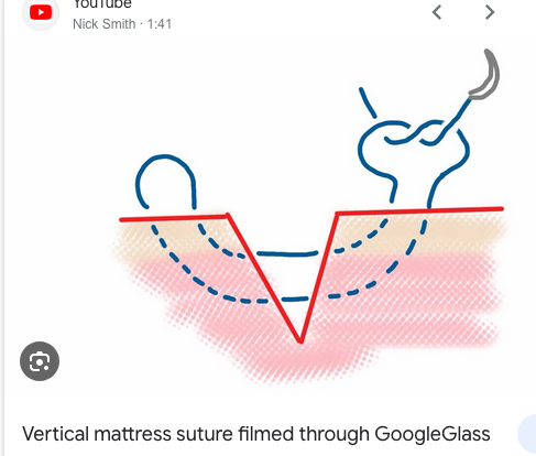

Rather than use a simple over-and-over baseball styled stitching, for delicate tissues a vertical / or horizontal styled suture pattern is employed
that distributes the suture (thread) tension over several holes and a greater surface area thus creating a stronger seam. Going much wider from the seam on the first pass, the closing toward the seam on the second pass. Also notice that the suturing (or repairing) of the seam is done with individual sutures not a continuous method so repair reliance is not predicated on a single continous thread failure.

I just bunch up the hole in the fabric and sew it closed again. After awhile it fails again and repeat the process. The large heavy needles are the opposite of what you want to do to waxed canvas unless you are going through the leather handles on a pint sized, you want to make small holes that arent stretched so bad.

The thread doesn't fail on mine as much as the fabric rips at the thread holes.
This is my experience as well. It isn't the thread, but the material that gives. I know it can be re-sewn after it fails, but my goal is to reinforce the material in that area, so that it takes longer to fail. Shoe Goo kinda worked, but it is too messy to apply accurately and ends up going on too thick. I am going to try this stuff next: Seam Grip WP Waterproof Sealant and Adhesive . If it doesn't work, I'll try heavier material overlay that @dirtybores mentioned.

Yes! I applied the Gear Aid "Seam Grip" to an older, beat up waxed canvas schmedium. It is pretty easy to apply and levels itself into a thin layer similar to the finish around zippers on Kuiu waterproof jackets. It takes 24 hours to cure, so not a viable emergency repair, preventative measure only. The bag was pretty much beyond its useful life (it has been repaired multiple times) and had a tear leaking sand when I applied the stuff. I've used the bag for around 5 hours of practice on barricades with a 19lb rifle. I brought it to a 2 day PRS match over the weekend as a backup. My buddy's bag popped before the first stage, so he ran it during the entire match. So far, it is holding up great. This appears to be the best non-sewing solution I have used so far. That said, it will take some more use to arrive at a final verdict. If it is still working well after another month of use then I'd endorse it as a tested solution to the problem.

So its been around 5 months and I have used the Gear Aid "Seam Grip" on a couple gamechangers - a waxed canvas schmedium and a plus 1. Sadly, the original, haggard-ass gamechanger prototype was shot by 22LR and did not survive, so both these bags were new before applying the seam grip. It has worked really well and both bags have no observable wear in the waist area. The seam grip seems to last for a couple months of heavy use before it needs to be reapplied. I am comfortable saying that this stuff works and recommend it if you want to extend the life of you bags.
