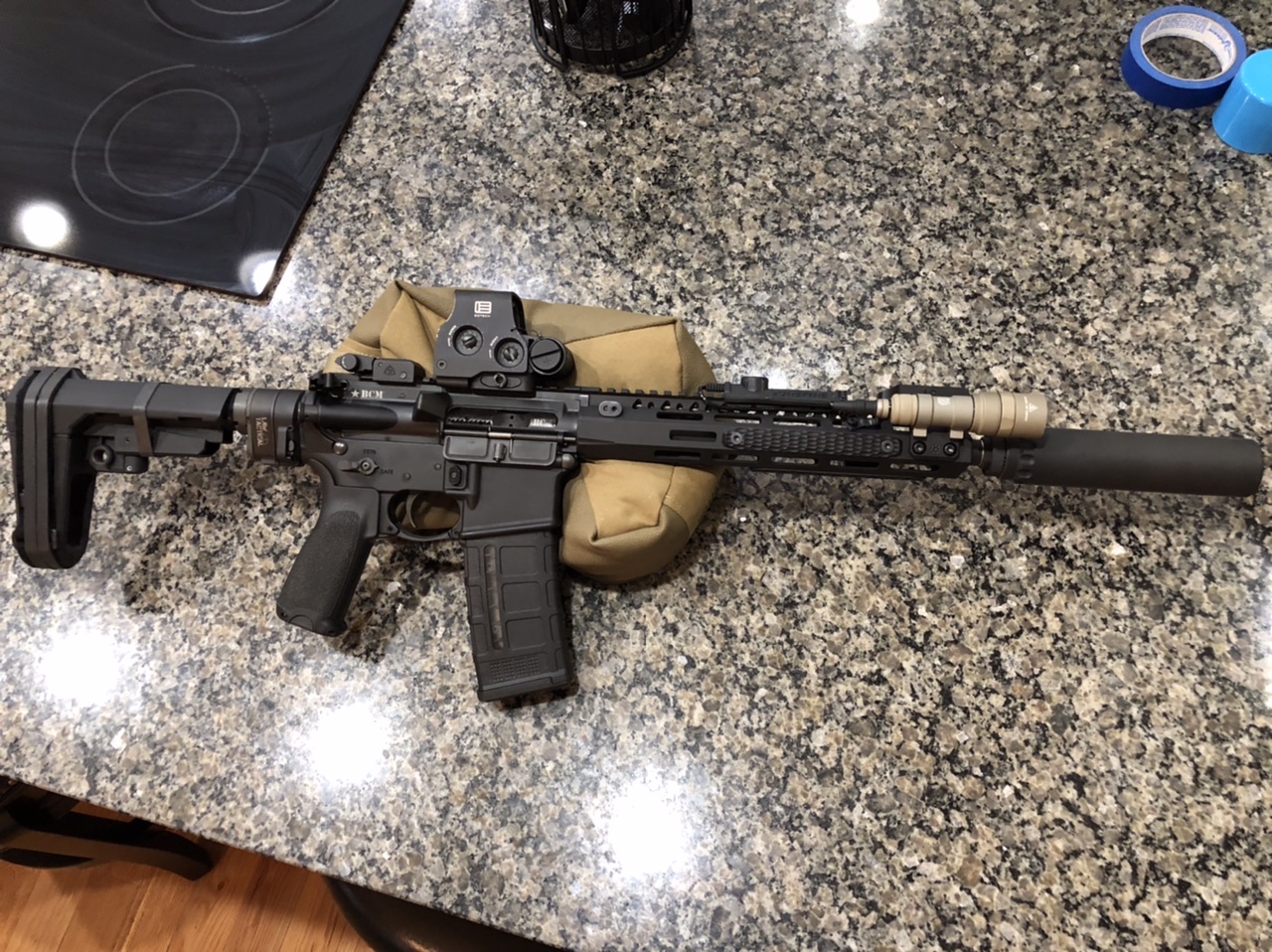

So I was gonna build a 10.5 pistol and the more I read, I decided on an 11.5 upper. Luckily, a fellow hide member gave me a great deal on a BCM Mlock upper in 11.5 with a BCM BCG. I just happened to have a spare complete BCM lower in my safe from some previous trading around. I got it put together added an Eotech, some BUIS, light and some rail scales to tame the heat on this shorty. I also added a Law Tactical folding adapter to make it more portable. My suppressor is a YHM Turbo with the brake muzzle attachment. I knew it would be overgassed so I went ahead and got an H3 buffer for it. Sighting it in, didn’t really notice any gassing but could tell by the ejection pattern it was somewhat overgassed. Yesterday, I took it and put it thru its paces with some really fast drills on steel and it became obvious really quickly that it was overpassed because I was taking it straight to my face. So, last night I went ahead and ordered a Bootleg adjustable BCG as I didnt want to tackle the gas block change on a BCM, they are a pain in the ass. Is this bootleg gonna fix my problem or does anyone have any other suggestions? The Geissele spring and buffer kit looked interesting but I’m not certain it’s necessary. Let me know if anyone has any experience with this setup. FYI, after abt 150 rounds, I have had zero malfunctions with mixed ammo but the gassing is a little too much.

I plan to shoot it 100% suppressed. I plan to shoot all 55 grain loads, although I tried 62 and 77 and it cycled them fine as well. I get the bootleg tomorrow and I will see if it help and may go ahead and do the RTV mod also.
It’s not a pinned gas block, I think BCM actually red loctite the whole gas block and also the set screws. I took one off and ended up having to cut it off, I couldn’t get it off any other way, thats why I am trying the bootleg first.

I got my bootleg today and it helped a lot. I have the BCM gunfighter charging handle on it so I went ahead and just now did the black rtv mod on it. I think it will be fine now.

The bootleg BCG and RTV mod helped a lot. I’d say it knocked 75% of the gas out of my face and its at a level that I feel like i can deal with Now. I may play with it a little more but for now, I’m pretty happy with the setup.

I now have two identical BCM 11.5“ pistols. One is running a Bootleg BCG and the other is running a Gemtech BCG and both in teh suppressed setting and both with the RTV mod. They went from practically unshootable(but reliable) suppressed simply because you would get gassed so bad. I never had a failure out of either rifle but the gas was intolerable to me shooting fast. I would say both BCGs stopped 75% of the gassing and improved ejection to abt 4, when it was at abt 2. I have not shot either suppressed as my only concern was suppressed.
