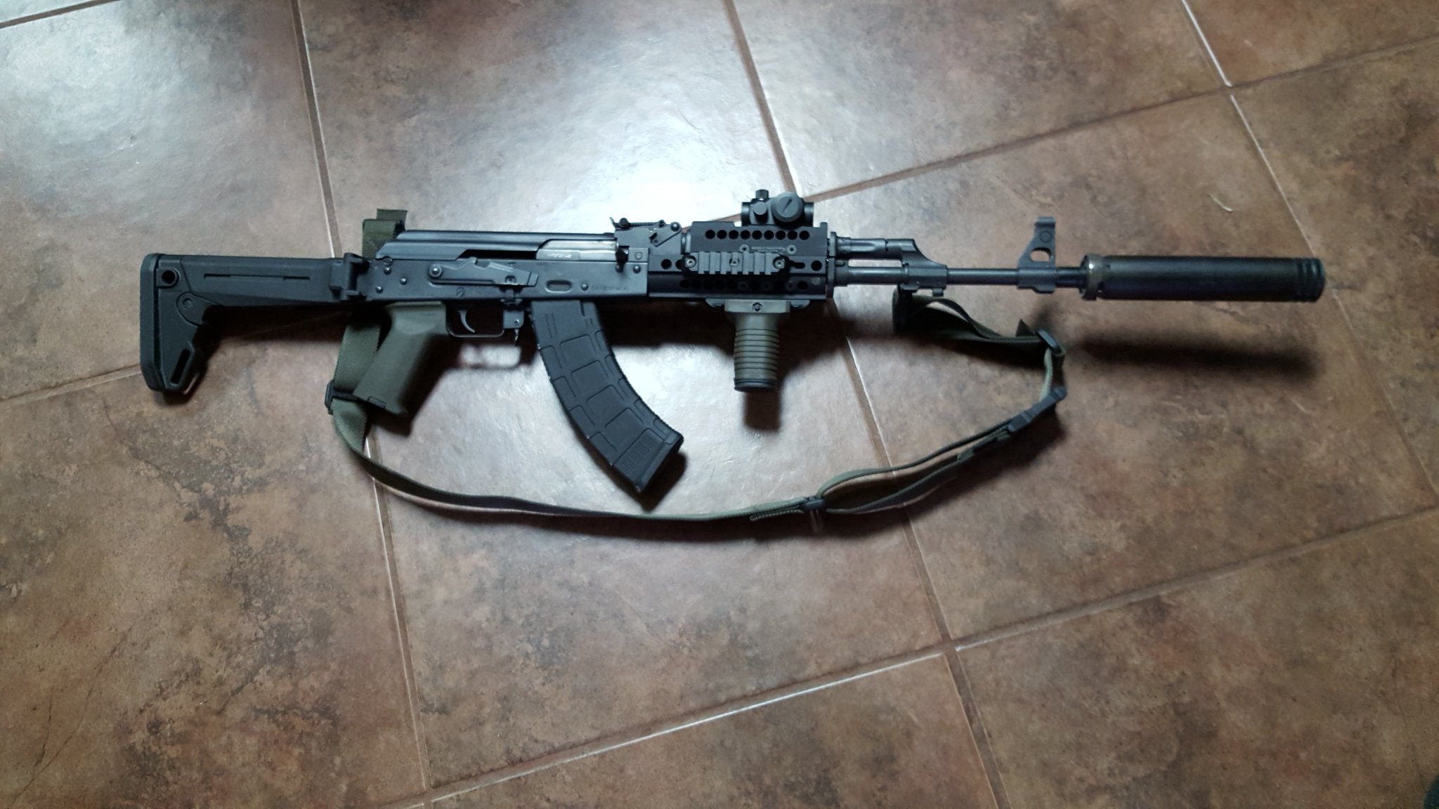

Hey guys, I know there aren’t a tone of AKs mention in this forum but I trust SH opinions more so that other boards.
I’ve got a sandman S I use on a couple ARs and 6.5 bolt guns. I’ve got a newer (‘15) wasr lying around. Caught a wild hair and ordered a 14x1L FH just to see if everything lines up. I know there can be some concentricity issues. But the more I read....am I on a fools errand? Can I luck out and have one that lines up? Haha

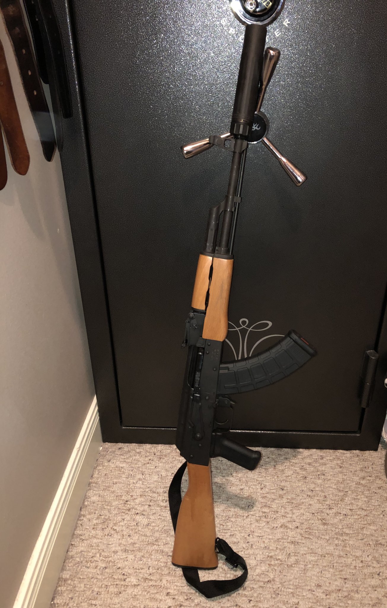

Hey guys question as for how to proceed. I have a WASR 10 and I'd like to build a can for it. I've read AK's can be problematic with non-concentric threads. So to make sure I don't have an issue buy the 14x1L to 5/8 R thread adapter.....drop my current can on it and check to make sure there is no contact with rod through the can and muzzle?
More inclined to use the Hughes since it has wrench flats:

I was basically told that wasr barrels are famous for “sometimes being worse” after you cut them due to the way the bores are reamed. It’s a gamble. I’d rather shoot the wasr for what it is and put the money into a custom built AK in the future.
TLDR I went back to being happy shooting suppressed ARs.
I'm sorry man I'm really dense can you please walk this out for me? 'Happy to change it'. What did you do, physical manifestation to the AK....how did you resolve the skewed alignment. You had a smith rework it?
I have two suppressed AKs both using a Sandman S. Mine run fine. However, I did have Rifle Dynamics modify them for suppressor use and check concentricity before I tried shooting them suppressed. They’re actually two of my favorite guns to shoot.
A friend of mine has one that he uses with a SiCo Hybrid. His bore isn’t 100% concentric but the larger bore of the Hybrid gives him enough room not to get baffle strikes.

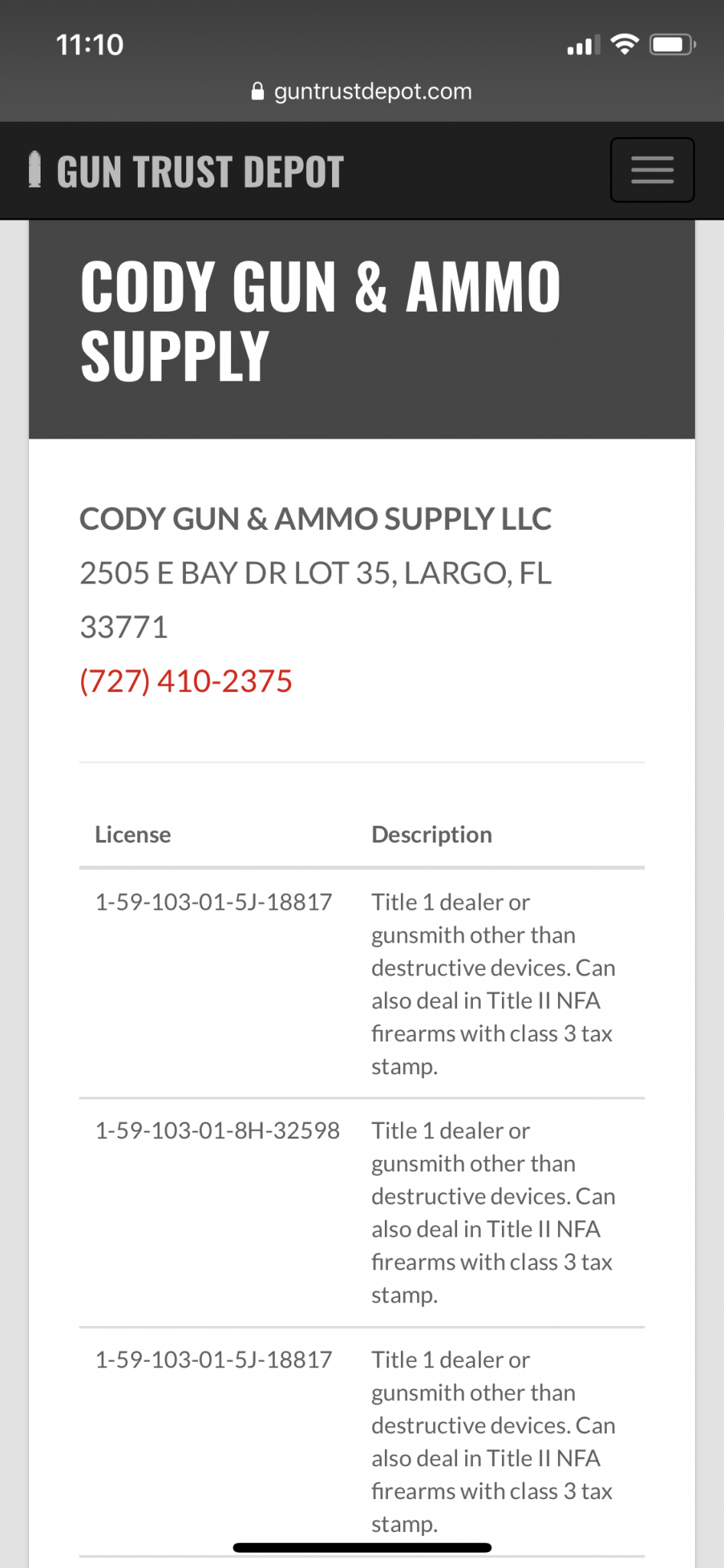

Hey I'm in Tampa....would you happen to recall that fellers name please? With the way my week is going he will be located as far as possible from me and still be located in FL......but maybe I get lucky and he's around the bend. If there is one thing Tampa doesn't have an oversupply of it's competent gunsmiths.....you'd shart if you saw some of the things that come out of the big name places here it's staggering. Thanks
I just did a googles for 'FL gunsmith AK47' and this guy came up in Lakeland is this him? Shoot that's 45 minutes tops!
Too easy, that’s where I was as well lol. This was back in like 2012 so no idea if he’s still in business. I just looked in the safe to see if I still had the receipt for the work in the file but I must have tossed it.
Dude Tampa Bay is a shit show when it comes to shops. The exception being SRT Supply (haven’t been in years, back when they were Appt only and out of the warehouse) and Cracker Boys (smaller and very friendly shop).
Good luck man 🍻
That’s not him but I’d give it a shot.
Yea Cody is the guy I went through.
Yeah it was weird I talked to him and he said the only way to do it is to replace the barrel with an American made barrel shoot I may as well build one from scratch with the cost of that whole process. He said chopping off an inch and rethreading wouldn't do anything for it? Any way over my pay grade but I may check with these guys in Lakeland
Hmm. It was 8 years ago so maybe it was the only time he did it? No idea. The pic is kind of a bad angle but here’s a pic. He did the barrel cut/thread/mount plus the new front sight block.
I hope the Lakeland guys can take care of ya.
