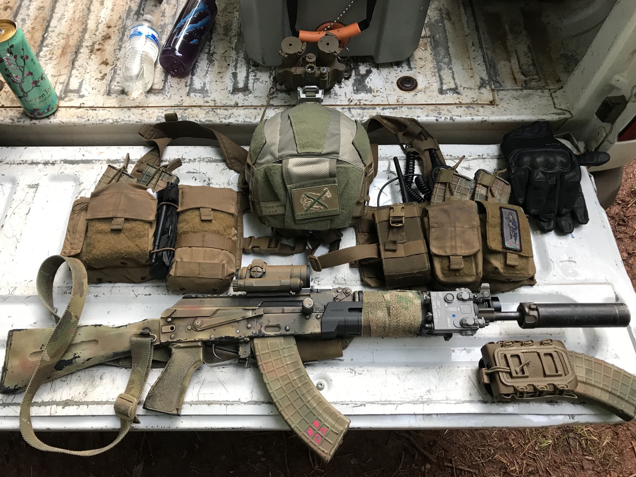

    I started running a can on my SLR-107CR in early 2014. I planned it out for a while and had Two Rivers chop my gun and then do a pin & weld on a mount to make it 16”. I used that gun hard for a year before the mount came loose and started wobbling against the pin. Come to find out their gunsmith didn’t torque it to the point he should have because “it wouldn’t have looked good”… never minding the fact that Surefire flash hiders don’t have to be clocked. Anyways, they also tried to silver solder it on per ATF specs and fucked that up too. Send your shit to a reputable shop. I still don’t know how I never got a baffle strike…
    Moving on. After getting an actual gunsmith to do it right I used the shit out of that AK for years doing Run&Guns and whatnot. 7.62x39 suppresses pretty damn well out of 12-16” barrels. You can hear bullets thwacking into javelina at 25yds. I also have a mount for a -107UR but I rarely use my suppressor on that.
    I’d estimate that at this point I’ve had between 8 and 10k through this can on my -107CR. Issue of note: imported 7.62shortcommie is largely garbage ammo and dirty. My 762MINI now weighs more than my new 762RC and it’s starting to sound like crap. Nature of the beast, I guess but centerfire rifle suppressors don’t ‘clean themselves’ like some people say. Outside of Hornady SSTs this gun has seen nothing but Wolf, Tula and Vympel.
    I never modified the gun other than running Wolff or ALG enhanced action and trigger springs. I haven’t fucked with the gas piston and never wanted to.
    When I redo this carbine I plan to use one of the Dead Air Wolverines. I wish to hell that can had been around when I was setting this carbine up as it is THE ticket for suppressing anything AK. I’ve been able to observe one on a select fire 5.45 krink now for six years with a MG dealer I help run shoots for and it has greatly surprised me with its longevity and how it sounds. It’s also much lighter than my surefire.

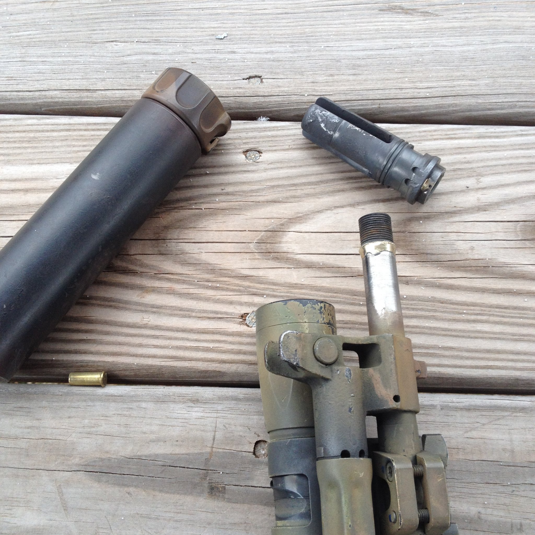

    I've had this old SWR Specwar 762 can lying around doing absolutely nothing for years and my PAP M92 SBR doesn't see much use either so I figured why not see if it'll run suppressed. I bought an adapter to be able to run the muzzle device for the can but I am still waiting on the bore alignment rod to arrive to see if the gas block threads are concentric to the bore, I don't need a baffle or end cap strike. If it aligns then I'll run a few rounds through it to see what I think and then add the KNS Piston to get things properly adjusted. If the threads aren't concentric I'll send it off to have the barrel threaded, but I might do this in the end regardless. I am not too keen on the adapter as there's always a little play in these commie guns with the muzzle device and set pin.
    A 10" SBR turns into a 20" light saber no thanks to the adapter and wickedly long 9" can lol. I don't know how guys can justify throwing a 7.4" Wolverine on the end of the 16.1" non-NFA AK, it's just too damn long. If nothing else it looks cool for now lol.
    Gotcha. I used the Griffin adapter (indexes off the crown, not the shoulder) and have no doubts about it staying where it needs to be once Rocksetted down. It’s not easily removable, but much less room for error.
    Yea, I simply wanted to see how it looked and decide if I want to pursue it further. Odds are I'll have the barrel threaded should I decide to keep it suppressed.
