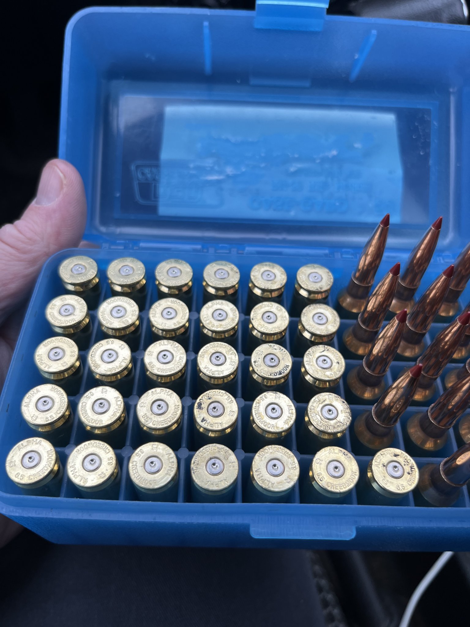

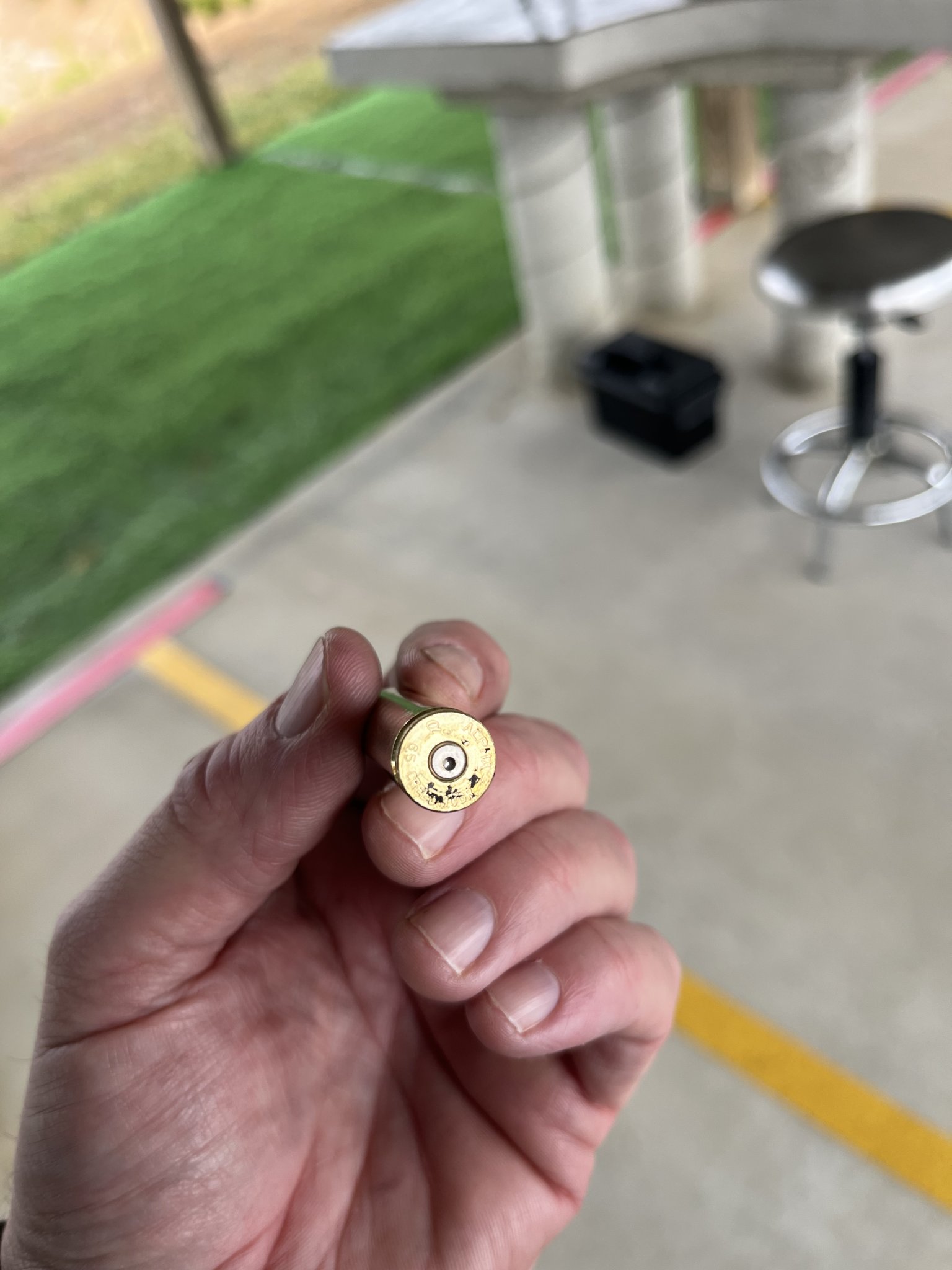

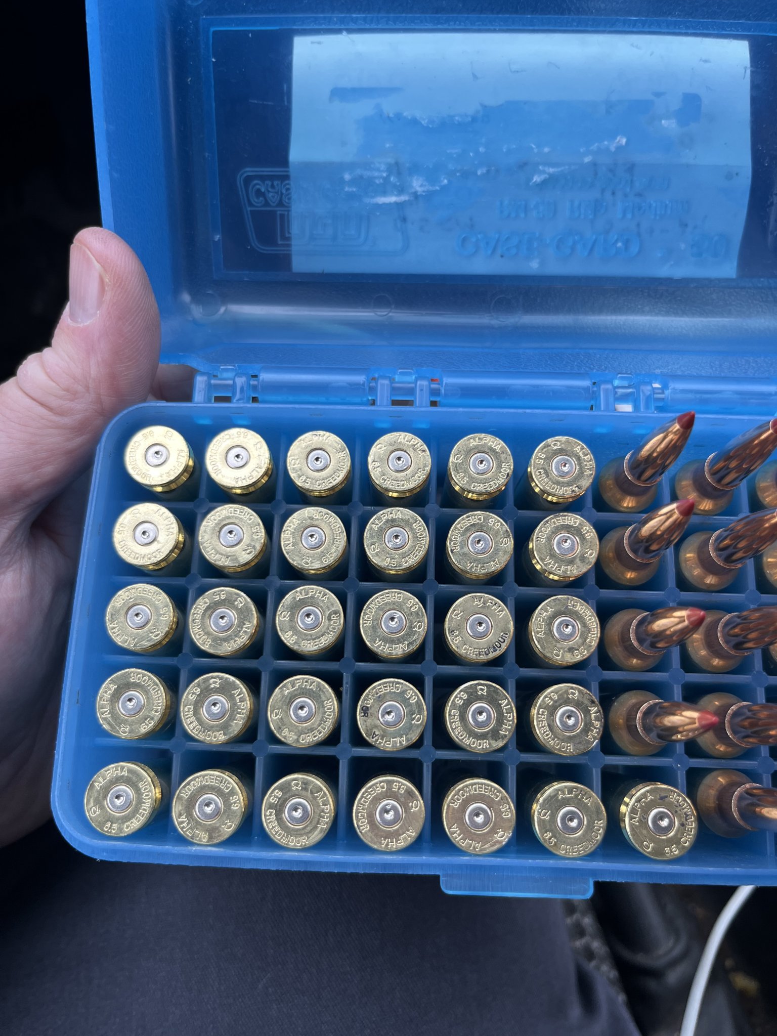

Banish Backcountry can, Tikka 6.5 CM, 41.5 grains H4350 143 ELDX, shot this load for 2000 rounds on this bore. Tight primer pockets no pierced primers.
I occasionally get a dirty case head and my bolt face gets really dirty when shooting a string suppressed. Is this caused by a dirty can?

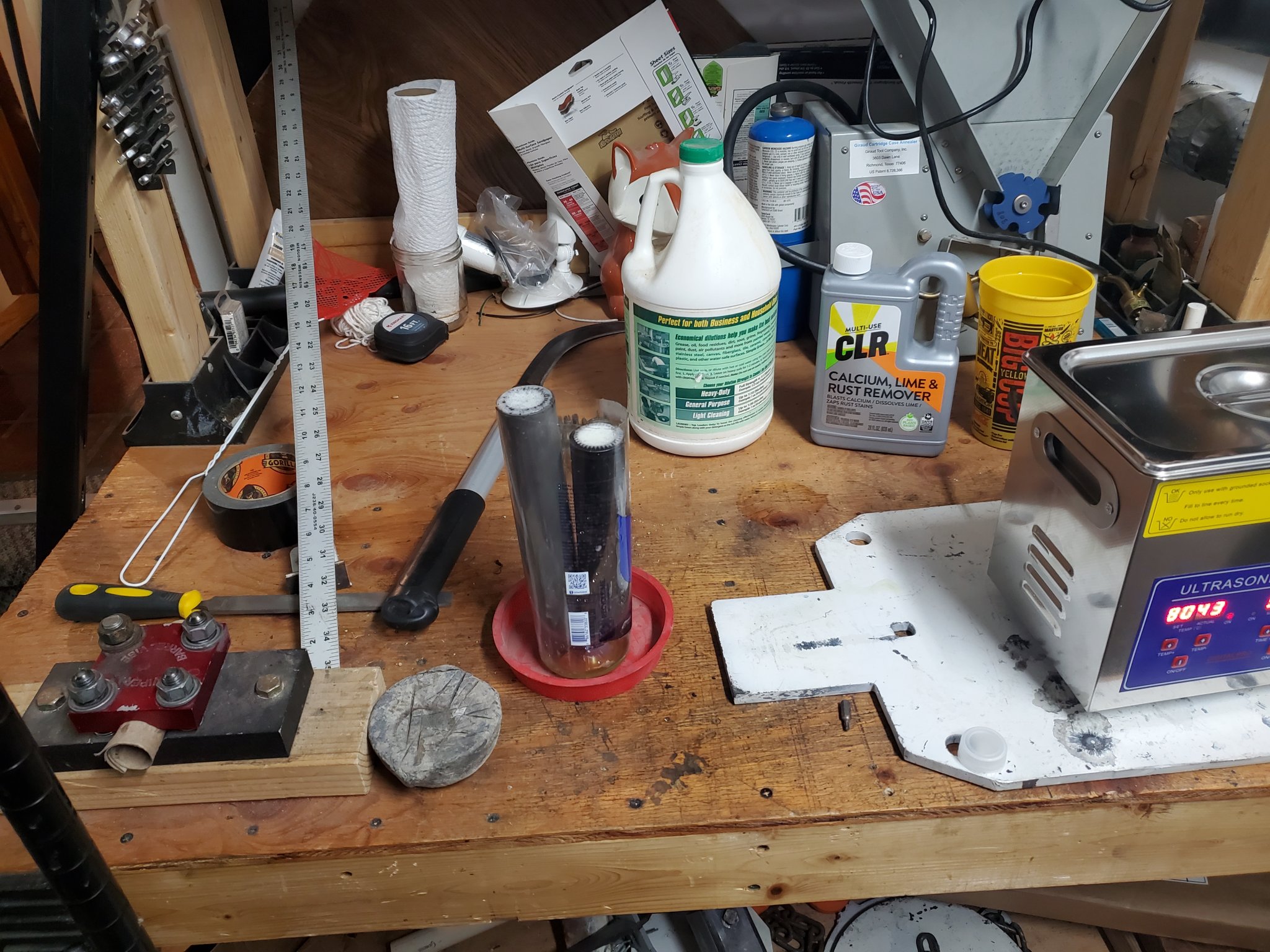

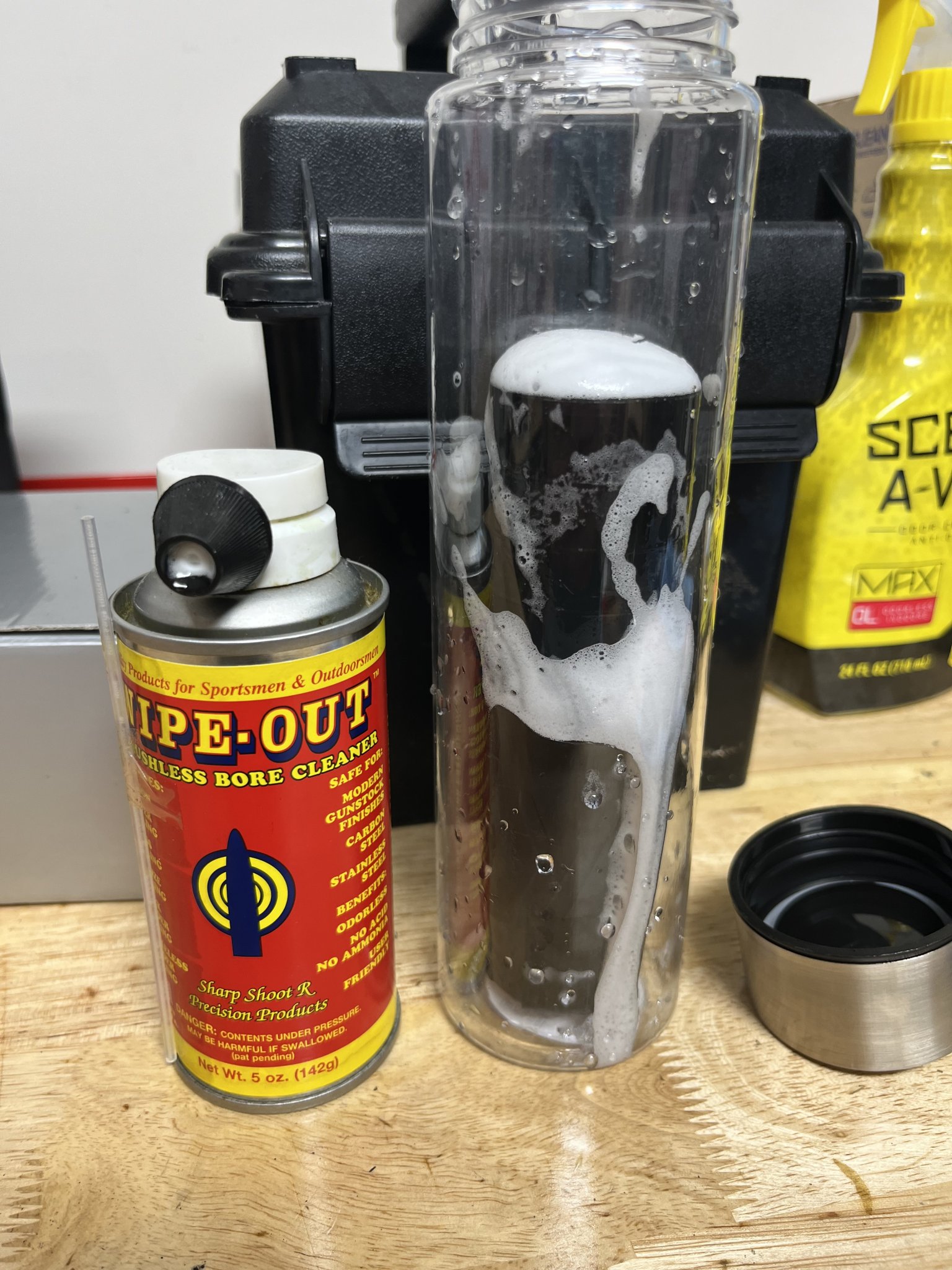

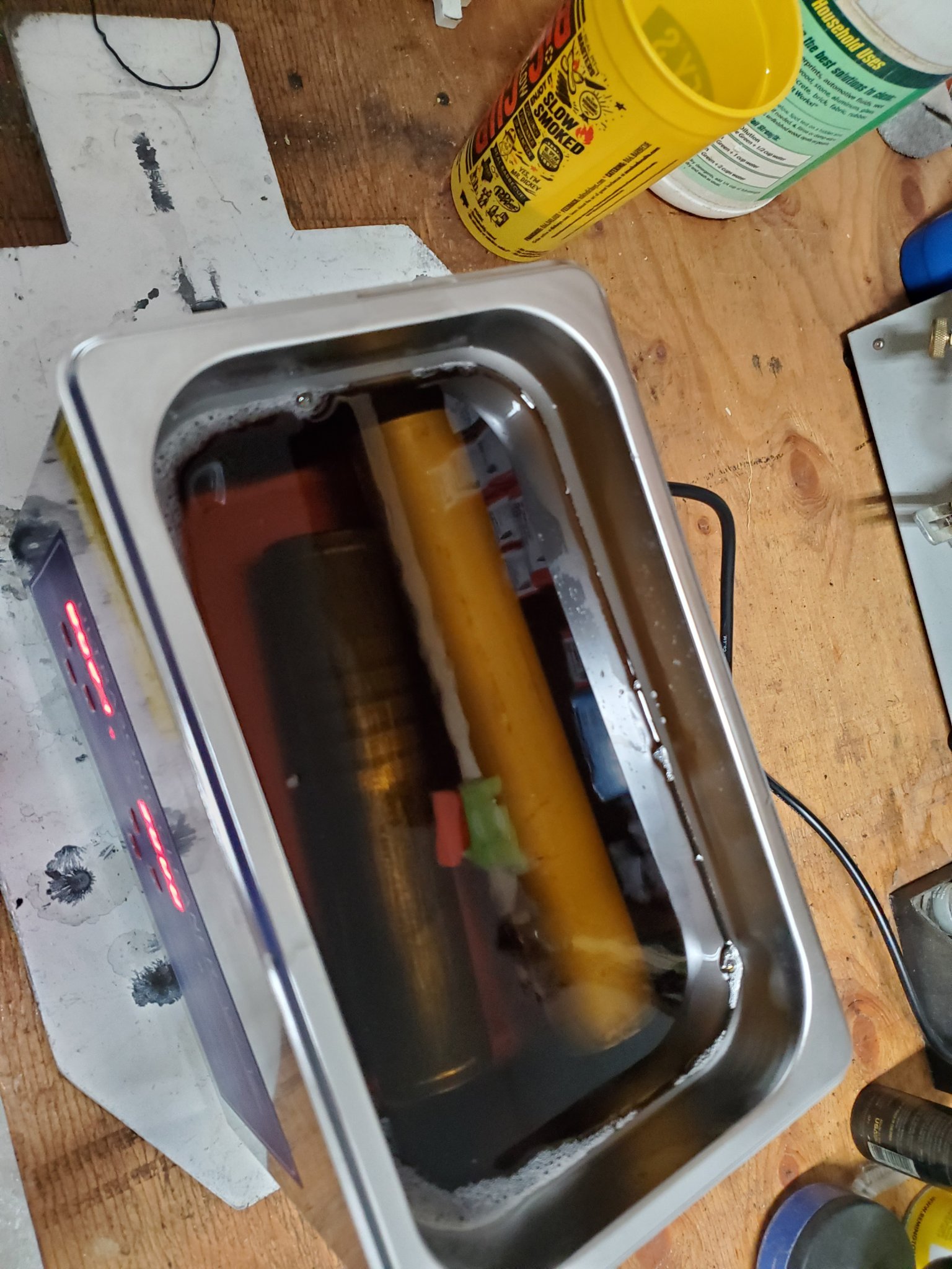

I removed the Keymo of the Sandman S, 3/8" plug from the hardware store, filled with clr, placed into a glass jar, filled that with water and then the tub of the US, three cycles of 30m each. Rinse in between cycles with cold water, the clr was filthy each time. I did the whole can the first cycle in a bag with clr and the finish was kind of soft, I bet the second cycle would've removed it.

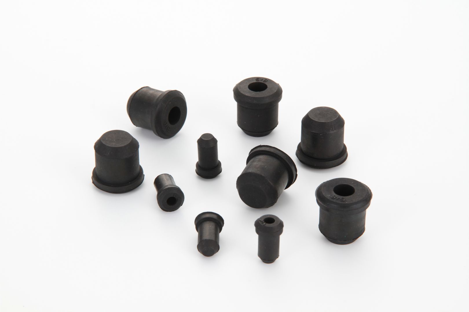

Earplugs hold liquid is a suppressor just fine.
There are a few different types of ear plugs. My experience has been that the orange foam plugs will slowly leak. Maybe flanged rubber ear plugs work better for this? Idk, they don’t work well for me as ear plugs, so I don’t buy them.
If you (impersonal you, not @supercorndogs specifically) do decide to to use an ear plug as a suppressor plug, “secondary containment” can help you avoid a mess.
Reactions: supercorndogs
Mine did drip a little.
