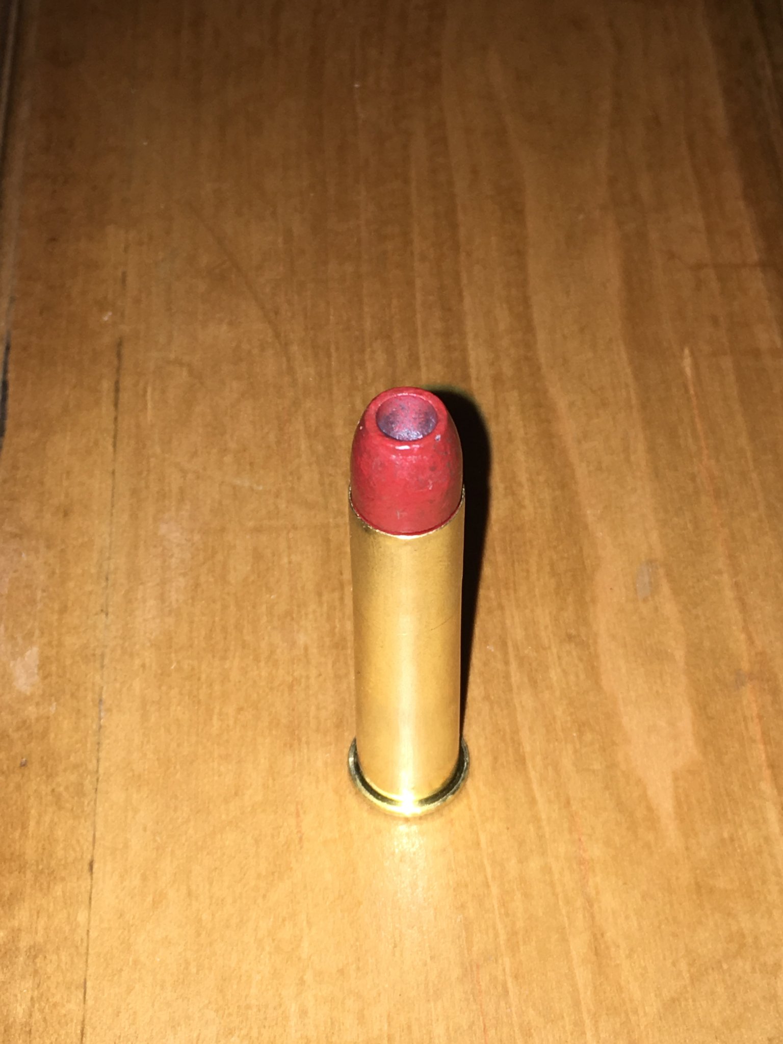

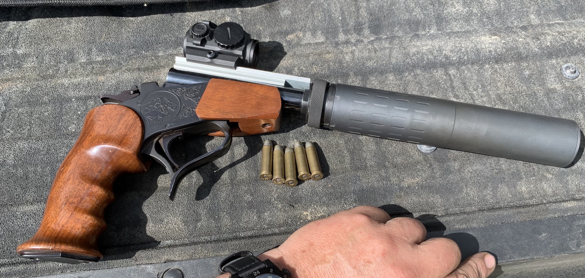

Since Welrods are totally unaffordium... I put together a .38 barrel for my Contender this weekend.
Whisper quiet and really accurate With .38 swc and WC rounds. The splat of the round on steel is substantially louder than the firing.

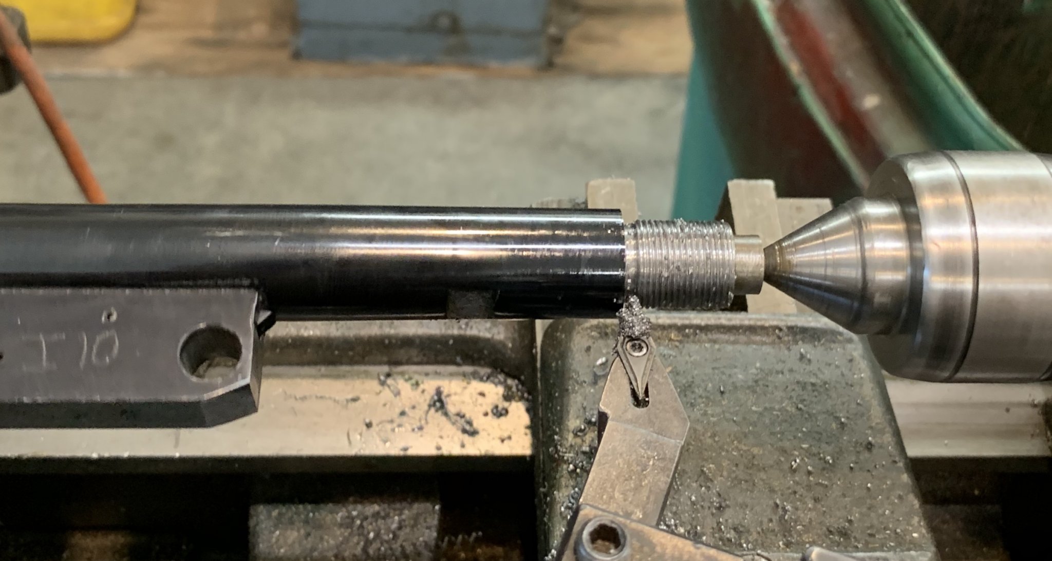

had to make up centers for the barrel threading. Not all the old contender barrels are as true as one would think!
Added an old red dot I had from an AR and presto... plinking magic!
Anyone else suppress Contender??

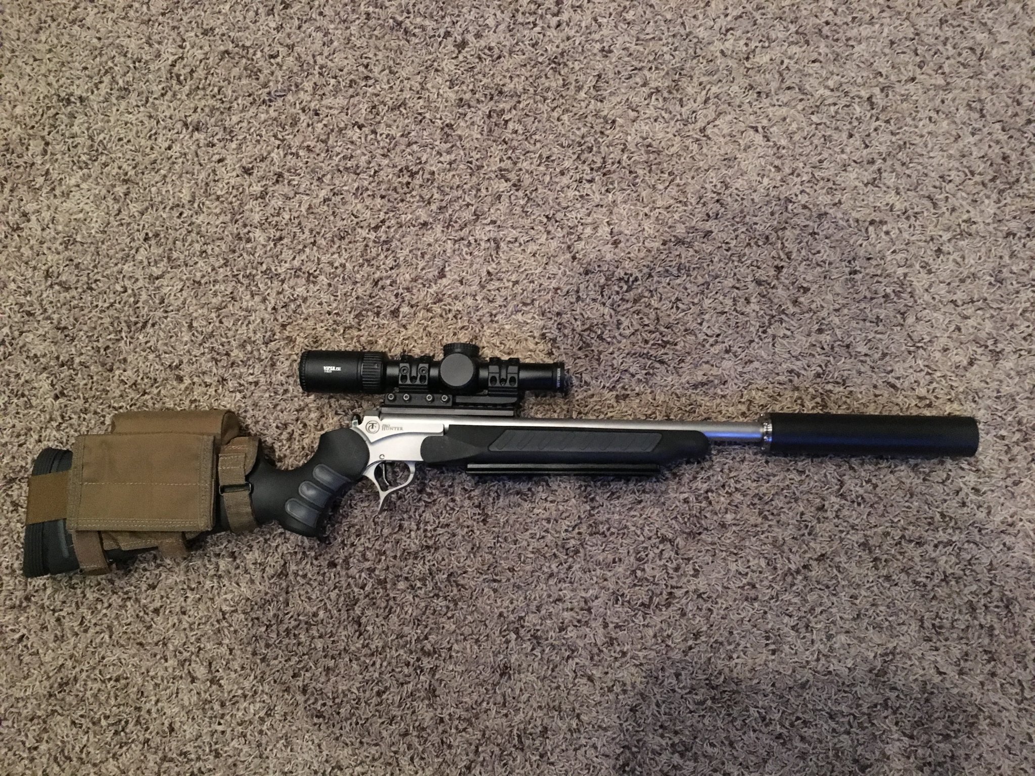

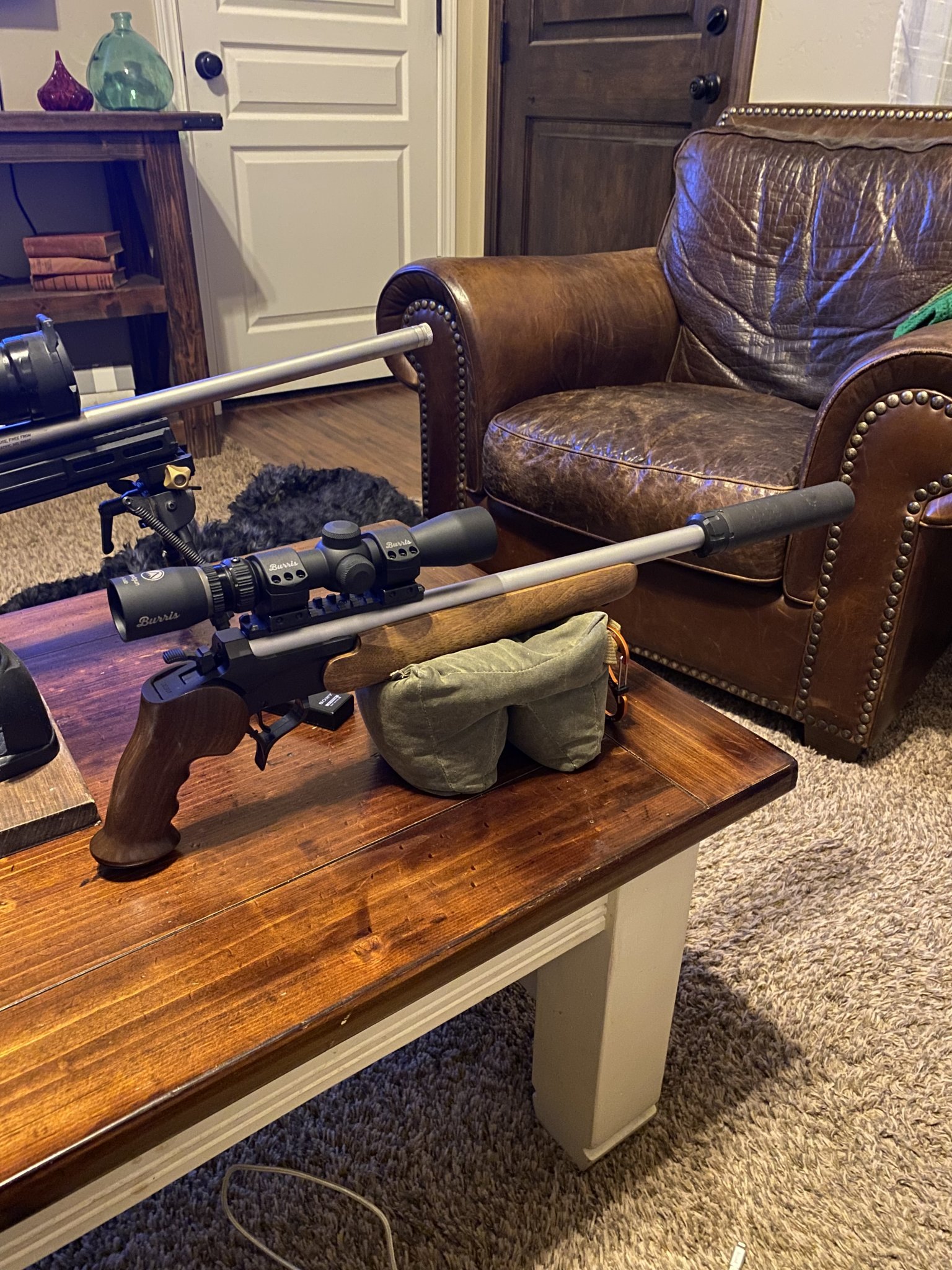

I run a 14.5 inch 30 Herret ,had a AAC 51t mount welded on for sdn-6. topped with a Vortex pst 1-4 , with 125-130 var bul and trailboss. 2" gps at 100 yds . two loudest sounds you hear is the hamer fall and the target impact. fun fun

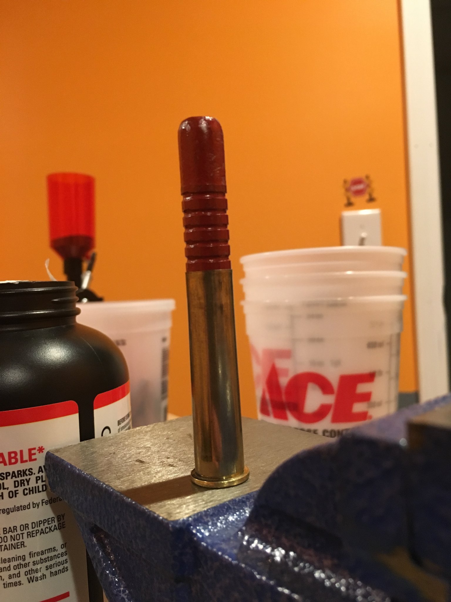

We were talking about converting a 16" 45-70 the other day.
Maybe something like a 600gr projectile at 900fps?
Still sounds like it might hurt a little
I have a 14” ported bull barrel 45/70. It is a handful but more a shove than a kick in the head. I download the rounds too. A full bore 45/70 would be painful!

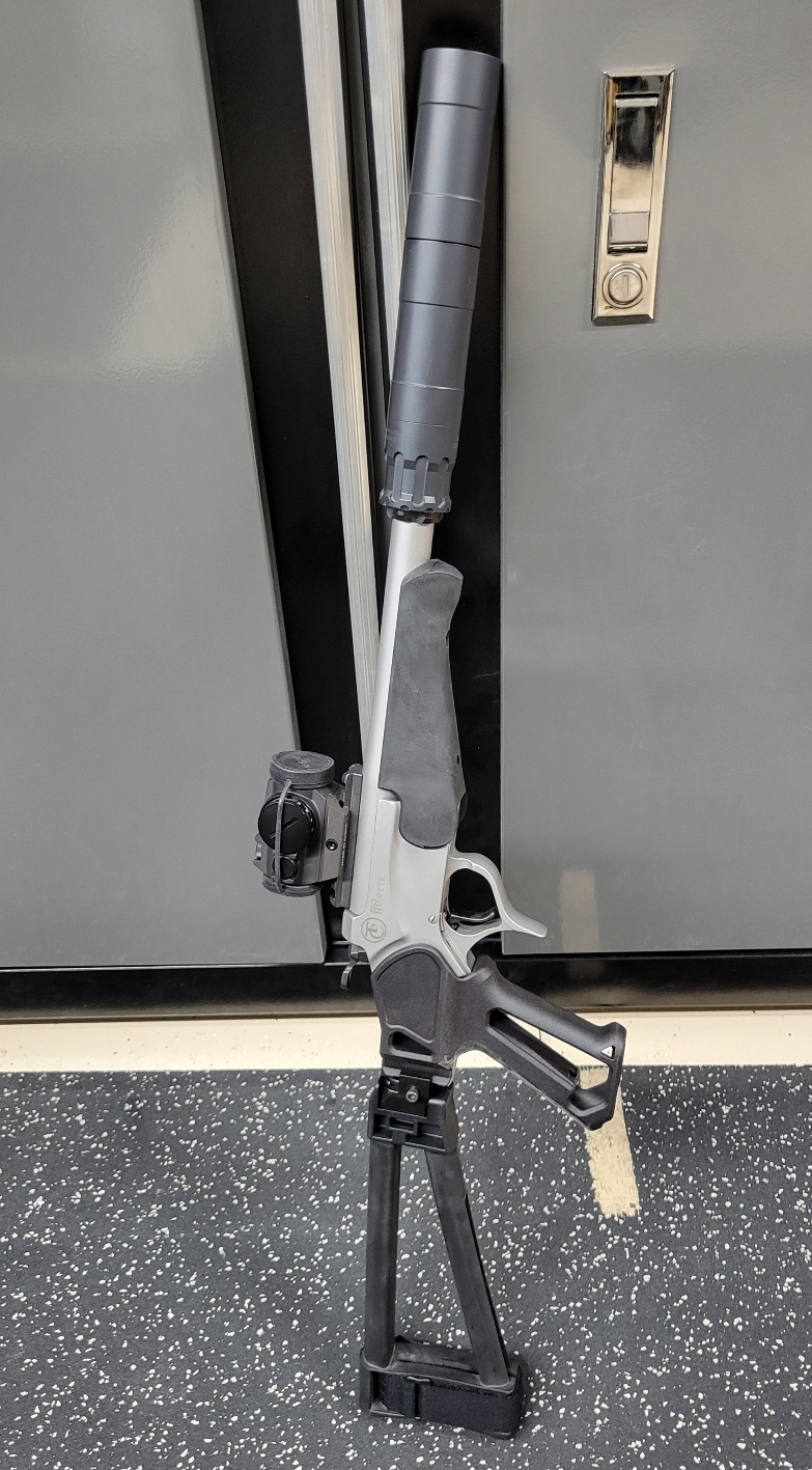

Gonna let @8pointer shoot it on Thursday. I have it set up as a carbine right now with a red dot on top.
Got some fairly mild 405 loads for him to try.

I have wanted to find someone to thread a 22lr barrel I have, and then maybe buy/thread a 44 mag and shoot 300gr specials thru it. Maybe the 44 needs to come first, I think the 22lr would get old having a single shot. My bolt 77/22 with can is stupid quiet with CCI quiets, and at least you can shoot it pretty quickly.
You can buy a 'cheap' .44 mag shot barrel. If it doesn't have chokes, etc. they can be inexpensive.
The .22 barrels are easy to thread. But you may want to have it done on centers. I am not impressed with their concentricity on the OD.

(....and you've got a machine lathe)
4 Lathes actually... Little toy atlas for threading... South bend for roughing. Monarch for the good stuff. And a 18" swing, 8' gap bed LeBlonde for doing aircraft carrier propellor shafts.
But a subsonic .44 special load would be a wicked nice shooter!

The toughest part is probably getting the barrel out so it can go in a lathe. No fun getting the barrels out of most lever guns. And getting them back 'straight.'

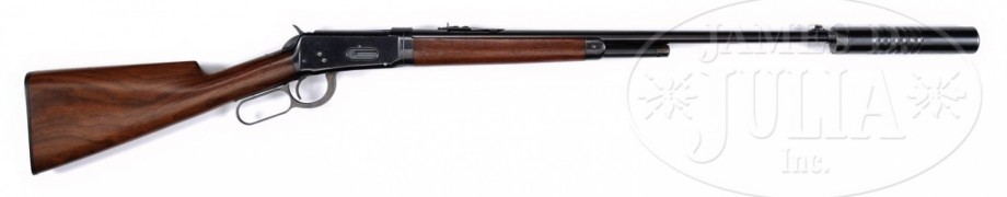

How about an old 94 with Maxim?

From what I've read about barrels you pretty well always want to turn on centers if you can get away with it. That's always how I have dabbled in it myself, In my (limited) experience I'd rather have rests, centers and a longer bed than a bigger through hole. My little Atlas 12X36 is surprisingly capable at its base specs for gun smithing, shame it's so clapped out.

Not a 10” but this is my 300blk. I want to be able to put a stock on it, so I went with 16”. I found a ‘rifle’ forearm so I could easily put a bipod on it. Pretty happy with everything. I call it my pirate gun
How’s it shoot accuracy wise? What brand barrel? I’d imagine it’s movie quiet out of an action like that.
One thing to keep in mind. if you order a barrel new from mgm, i’d consider getting it cut for a muzzleloader forearm. Its their strongest attachment method. Also, muzzleloader furniture is the easiest and cheapest to find

I have, but if you want to actually kill stuff a 38 Spl barrel is better IMO and just as quiet, more so if you're comparing factory ammo in both. A 158gr lead hollow point 38 Spl round is very quiet from one of these (the one I built has about a 6" barrel IIRC, stops right at the front of the handguard), and uses quite a bit less powder than factory subsonic 300 Blk. The larger diameter bullets expand easier as well, and are plentiful. In something like this I don't think the 300 Blk has any advantage at all (and I do shoot and load for it in multiple firearms, so I'm not biased against it).
I dialed this gun in for a 230gr Hammerhead wadcutter loaded to 900 fps over Green Dot, with drops matched up to a BDC reticle on a compact scope. Pretty decent little package that's easy to hit with and very quiet. I wouldn't hesitate to use it on game up to deer size.

44 Spl suppressed can certainly be an interesting option. One thing to know though - generally speaking the bigger bores are a bit louder, both sound of the suppressed shot and sound of the bullet in flight, as well as much louder sound of impact which can actually be pretty loud in some circumstances. While the difference doesn't seem to be significant to my ears between 30 and 35 cals, perhaps because a small volume 38 Spl or 9mm does the job with a lot less powder than 300 Blk, I can definitely tell the difference with 44 and 45 cal stuff, enough to the point that if I want something with the ideal blend of terminal effect and quietness I prefer a 35 cal with some sort of lead hollow point designed for low velocity expansion.
Sometimes people look at the low velocity numbers of cartidges like 44 Spl and 45 Auto and expect that will naturally make them quiet, but avoiding supersonic crack is only one part of the sound signature and the bigger stuff just makes more noise at the suppressor and downrange. Bullet weight plays a big role in the sound down range too, which is one reason I like the 35 caliber stuff to suppress; I can use a little 90gr solid for very quiet small game loads that hardly make any noise, or go all the way up to 250-300gr heavies depending on the twist rate for use on larger game. I fabricated a 255gr hollow point mold that works in a bunch of different 35 cals (too big for the 9mm, but works in 38/357 up through the bigger 35 cal rifles) and has been very successful on chunky southern whitetail, but for quieter plinking I generally stick with something a bit lighter weight. As Cascade Hemi mentioned above the 38 Spl bullets can be had dirt cheap if you don't cast your own, so that's an advantage too.
But your use case may be very different than mine; I rarely shoot at any sort of public range or organized shoots, mostly shoot out in the woods or hunt so the difference in sound levels can be much more significant than shooting with a bunch of other people and gunshots around. Of course if one wants to take the sound level part of this to the extreme while sacrificing terminal effect, there's bolt action or single shot 22 LR options that can be incredibly quiet. Or go the other way with the big bores and sacrifice sound in favor of terminal effect, which is where a 44 Spl can shine if you're taking bigger game with it - there's no wrong answers, just a sliding scale to look at and determine what fits best for your application. And of course there is a right answer - get one of each, and a whole bunch of suppressors to match, then circle back and get more of each. :)
