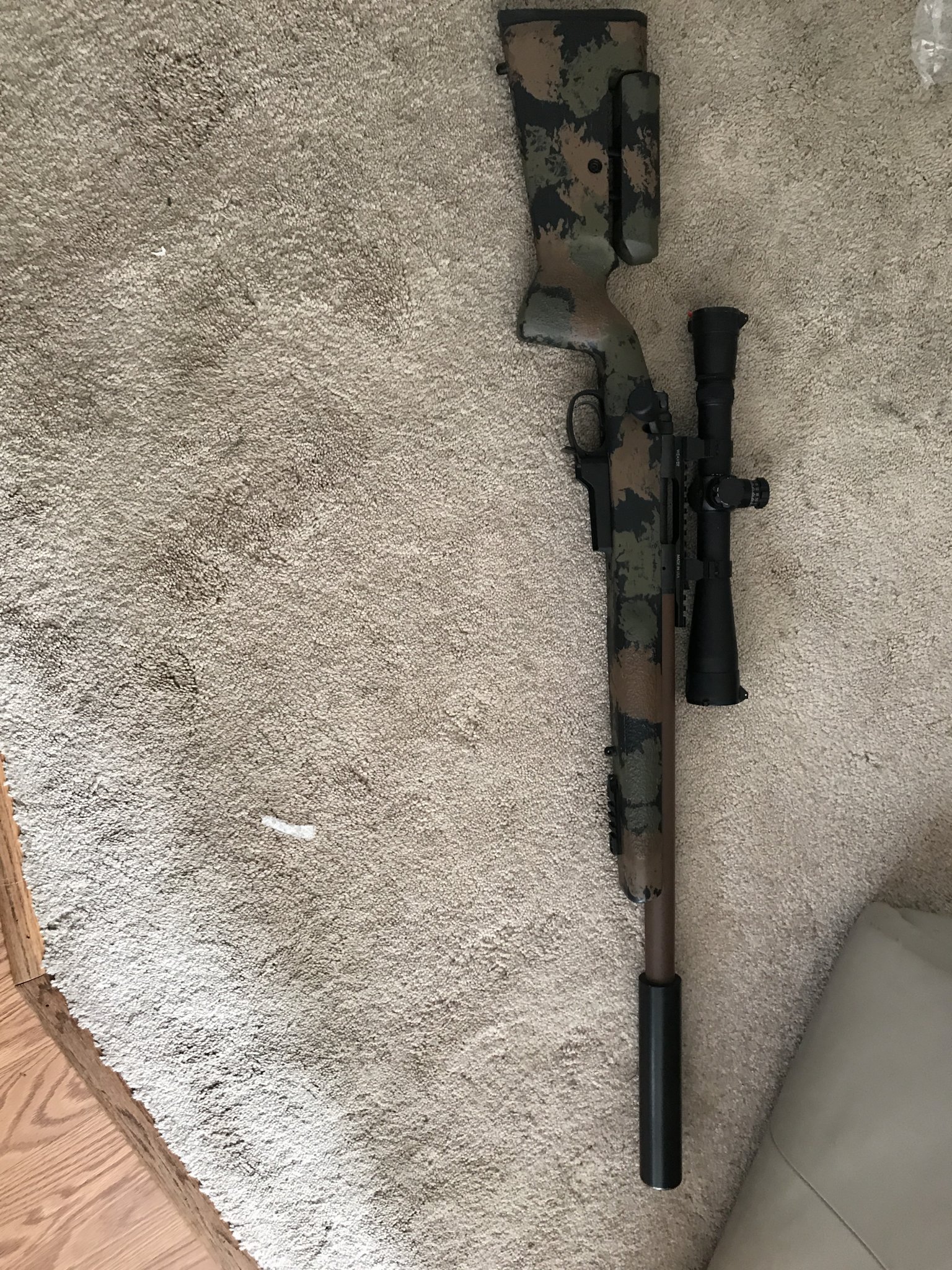

223 Ackley with 75,s will kill at distances out to 500

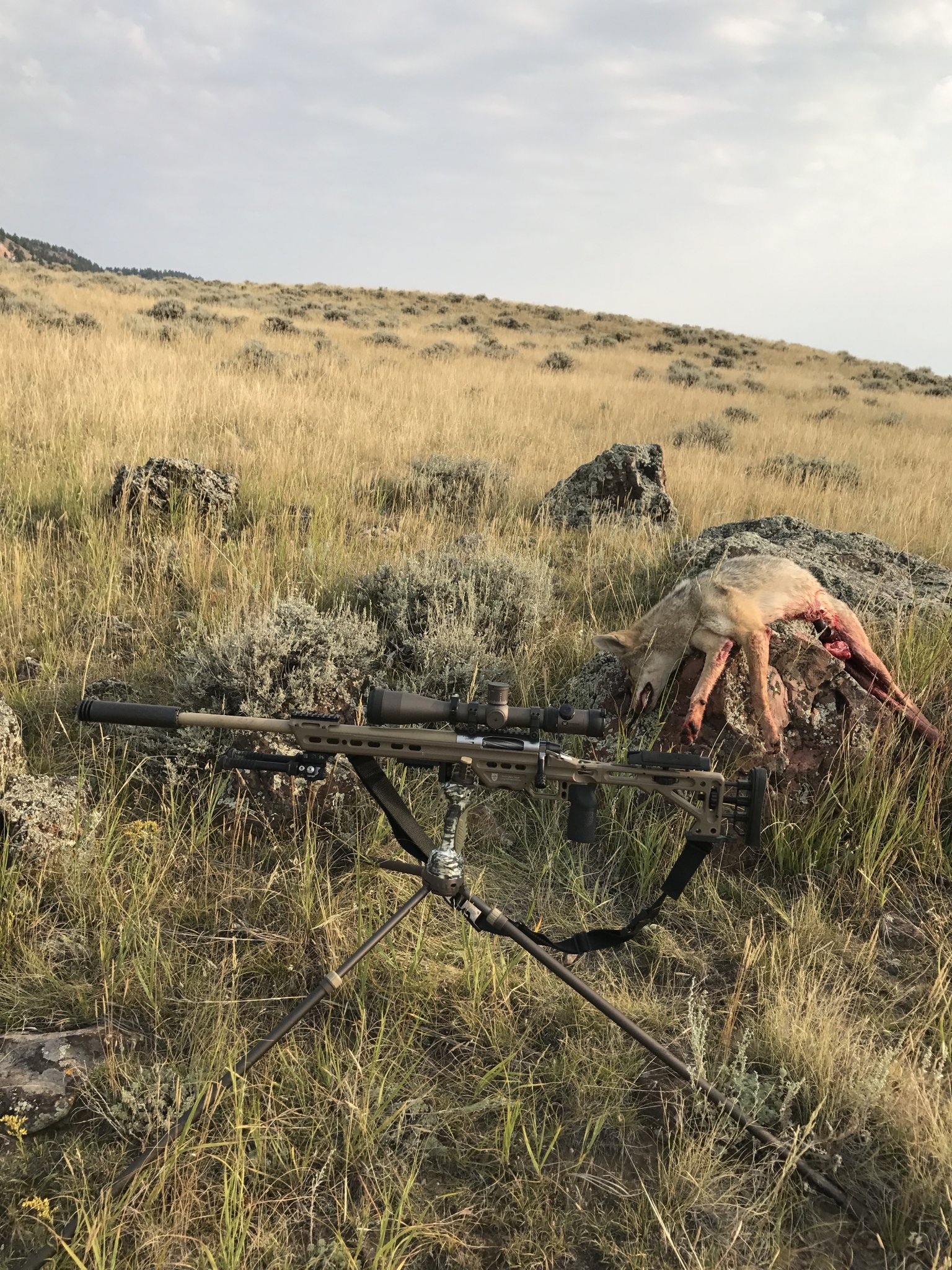

my favorite for longer range is a 243 Ackley 20” barrel running 105,s at 3214 fps.466A58A8-C8BF-45CB-B93C-5AABF64A4E90.jpegC51FE017-DD77-4F92-B1C6-CC06B8C3A0F7.jpeg
243 with dead dog, 223 Ackley 16” suppressed
