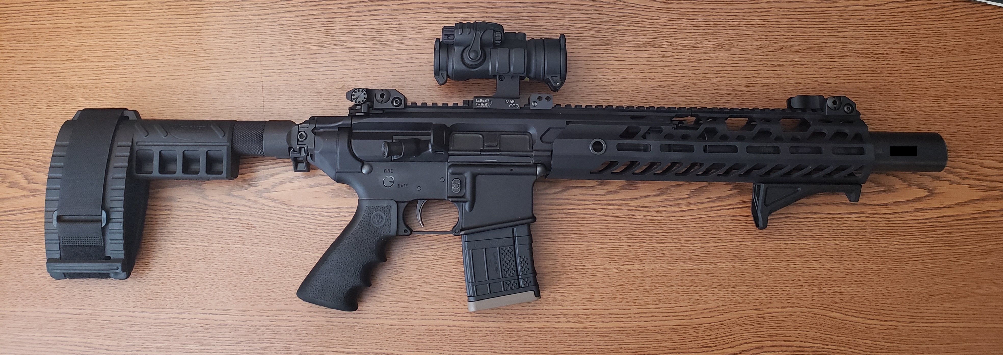

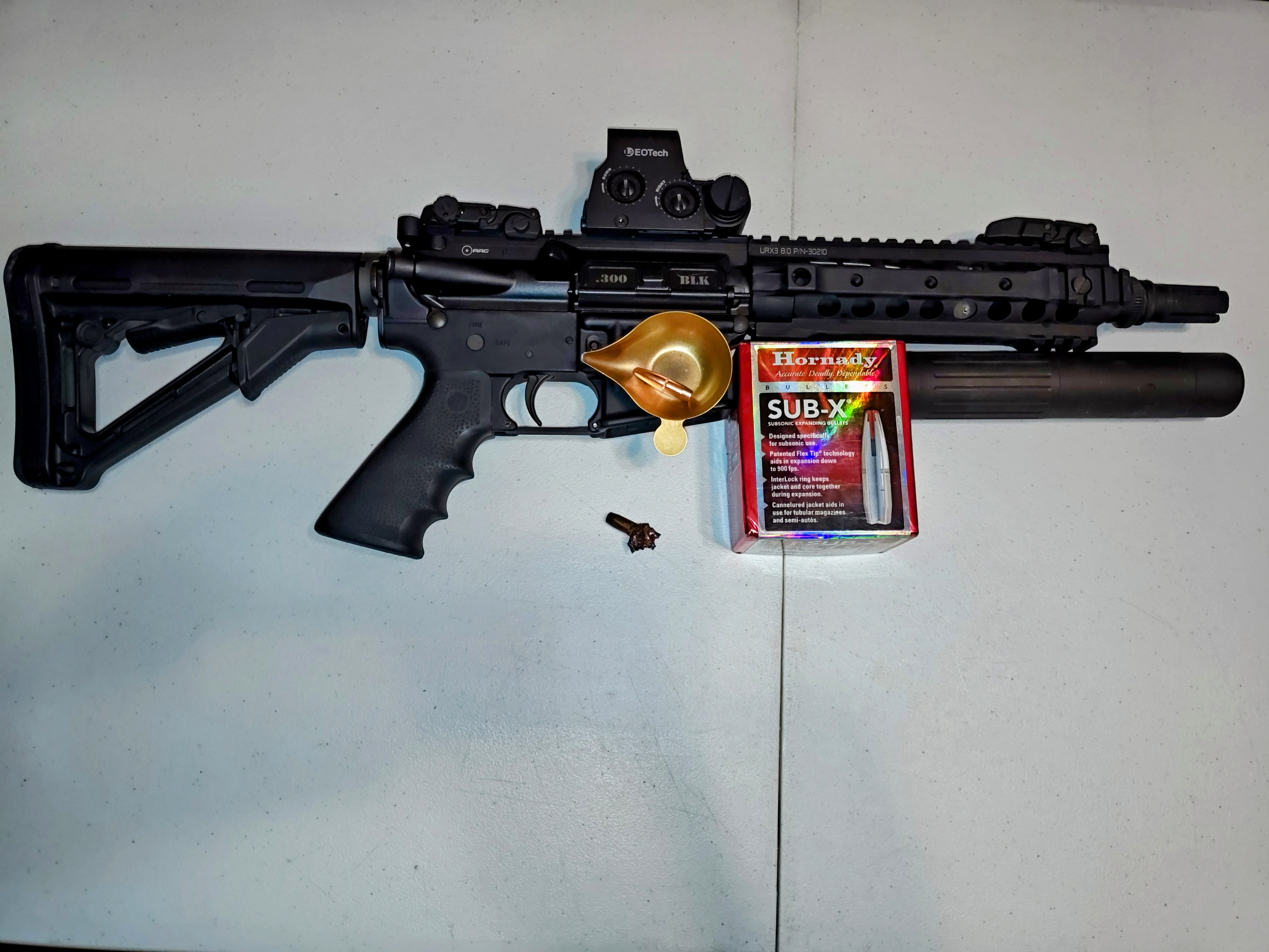

I have all 3... AR22 suppressed, AR9 suppressed and 300blk suppressed..
My 300blk is a 10" Rainier Ultramatch. Its stupid accurate outbto 500yd with 125 TMK supers and 22lr stupid quite wjth my 220smk subs...
Its so quiet, this old lady and her husband were shooting at the range next to me and she turned to me and asked if I was shooting a nail gun. Its that quiet..
10" barrel, Rugged Surge 7.62, 220smk sub handloads with cfeblack

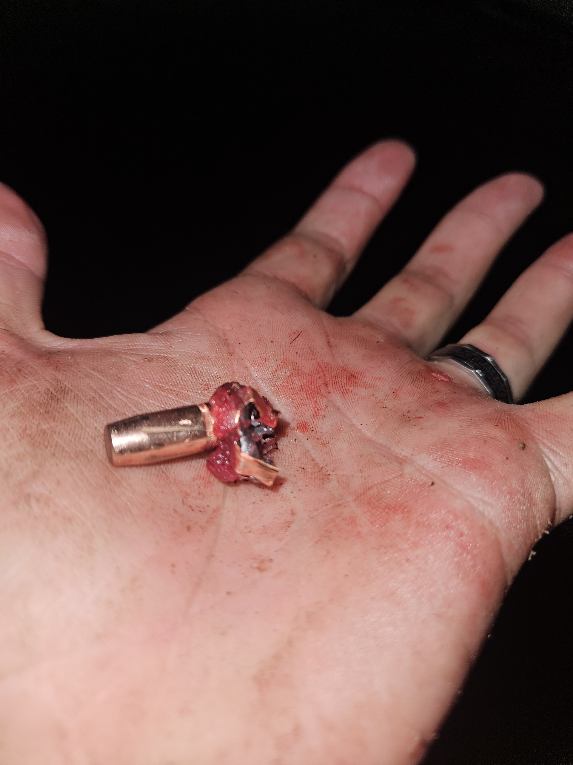

Well dusted this off for some feral hog removal.
AAC 9 inch upper AAC 762 d can.
Bullets Hornady 190g sub-x
Over 12.3g cfe blk 2.050 coal.
Behind one shoulder in front of other, heart turned into jelly. My favorite placement. @ 75 yards.
Bullet far side stuck under skin.
1062 fps in a 16 inch barrel .
Bullet measured 0.820 at widest point. Unfired bullet weight was 190.3g random out of box. This recovered round was 191.7g .
I can't explain that and no chunks stuck in the petals that I can see.
Movie quiet except for bcg slapping into battery. You can hear impact of round.
Reactions: VargmatII and BurtG
@TheHorta post your recovered bullets
Maybe there’s different batches some harder than others
