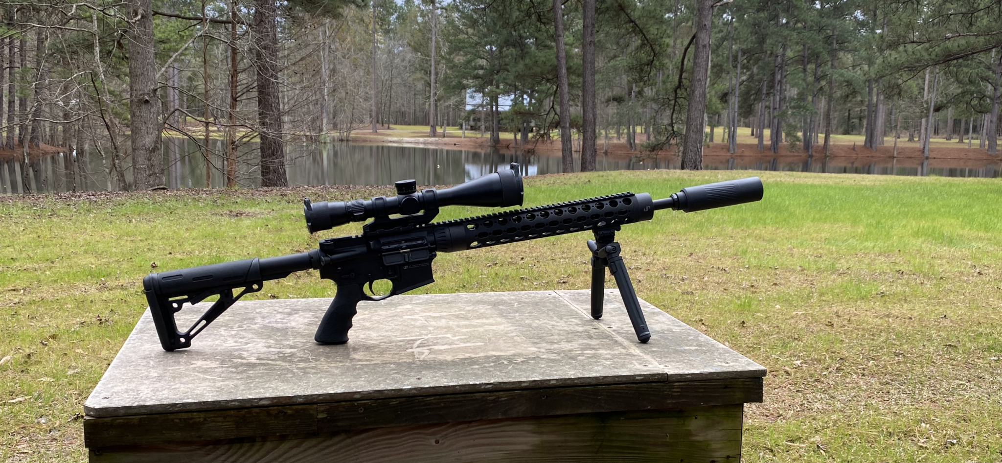

Just wanted to bring this thread full circle. Finally got the Dominus put on the JP Grendel this afternoon in between meetings. Gun and can are both awesome. I really like the Area 419 hellfire system too.
